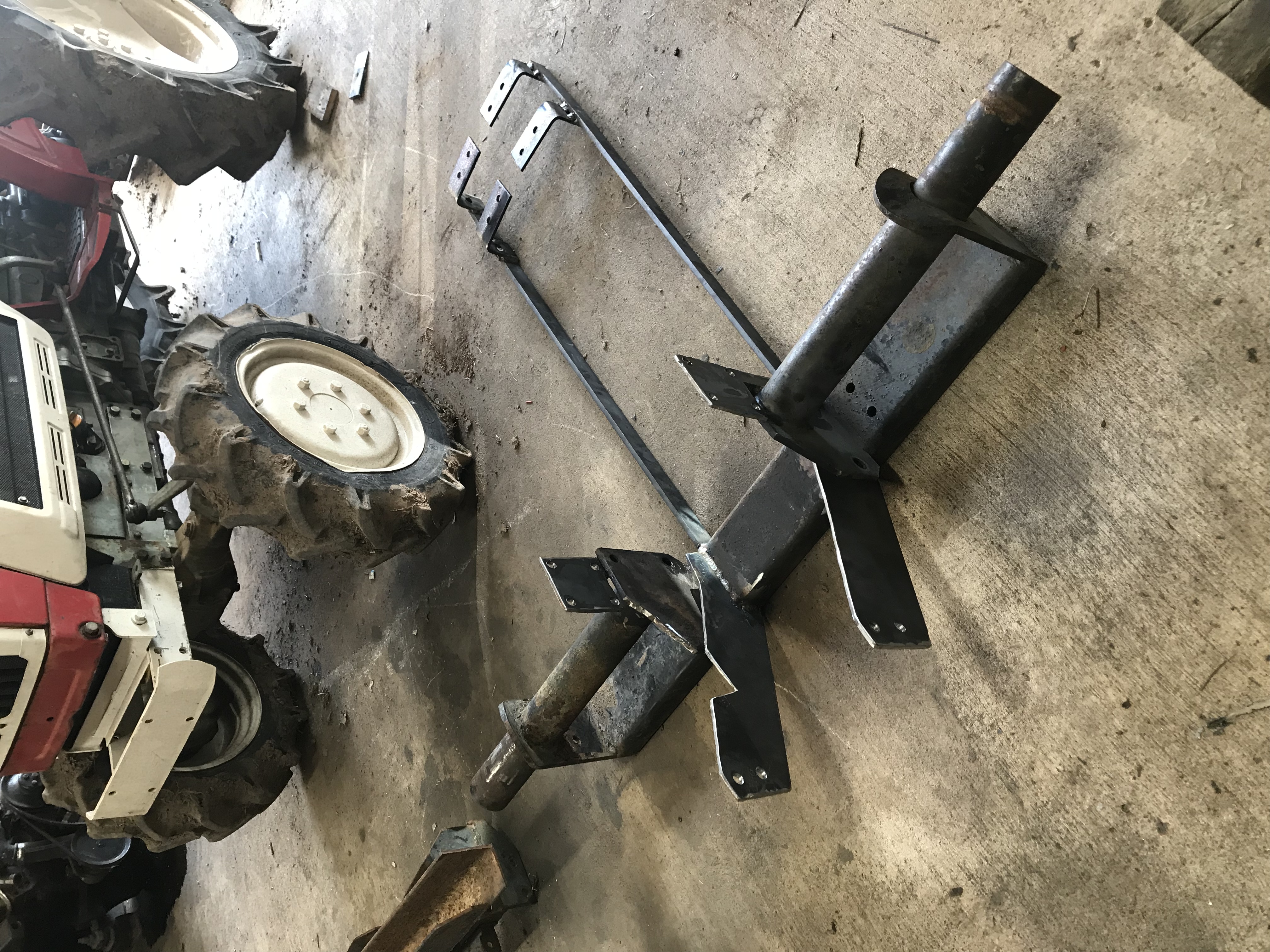

My project this week is figuring how to adapt the cross member from the 336D fitting YFL1500 front loader to fit my little YM2000BD.
After searching a few pictures and some sent over by California, I think I致e got a plan figured out.
Also, I致e found that the tach/hour meter cable did in fact break internally, so I am waiting for the new one to get here from Hoye.
This is posted from my phone. See the wacky contractions.

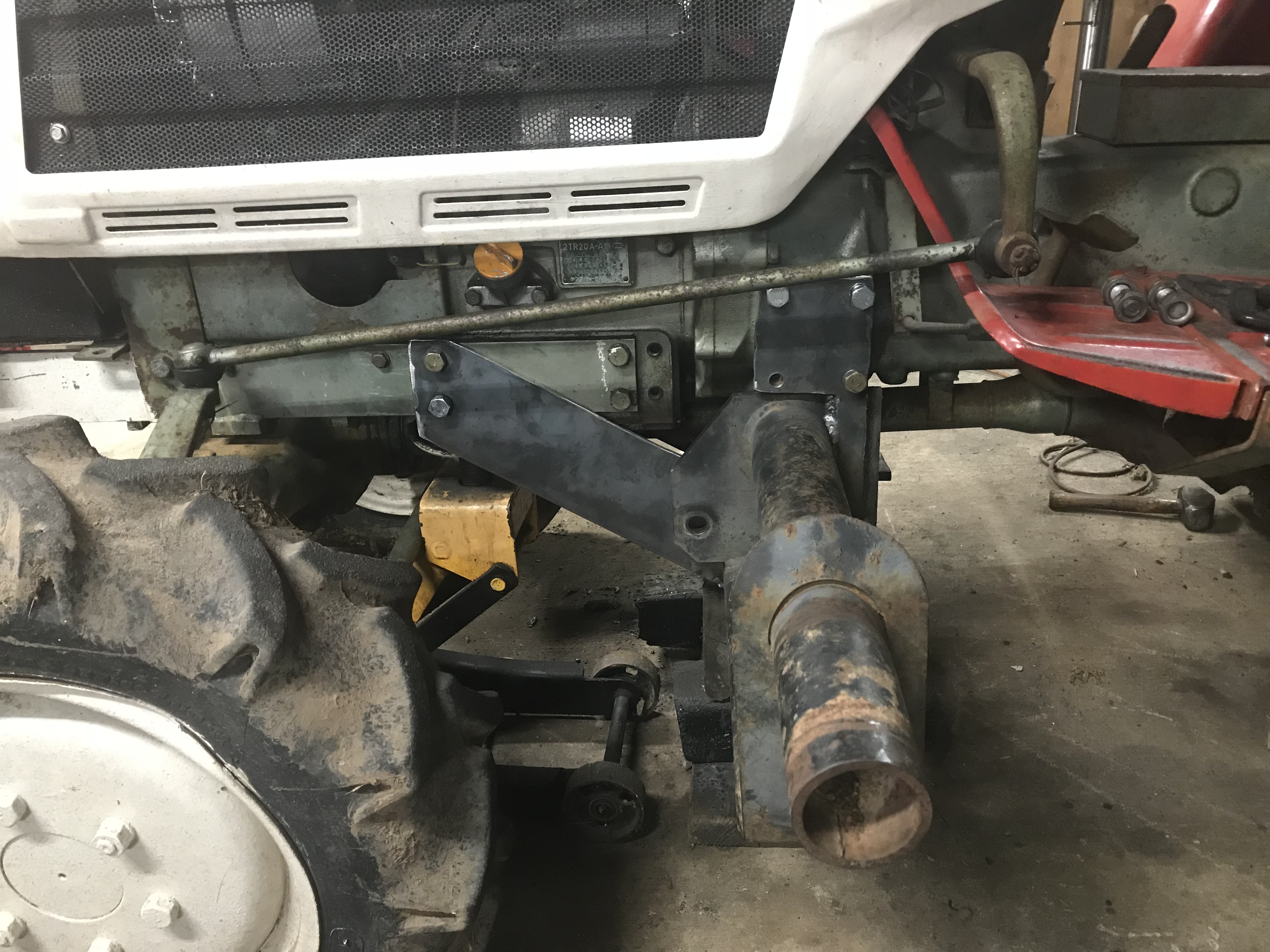

And just like that, the cross member for a 336D now fits a YM2000BD!
Even though I had some 3/8 plate available, I had to resort to using 1/4” due to available tooling.
I am going to the metal yard in the AM to source some metal to make some tie ins from the cross member back to the rear draw bar assembly.

   / Yanmar YM2000 Fuel Pressure/ hard starting #235
That looks great!
Interesting - you have bolt holes to support the loader in the sides of the bellhousing, just ahead of the clutch cross-rod. My YM240 doesn't have those holes. (photo). The similar downforce bears only on two bolts threaded upward into the bottom of the transmission. I like yours better.
Good work!

I was contemplating also making a mounting to those 4 holes in the bottom of the transmission, but I am pretty confident that with this way I won’t need to, also going to add in the supports back to the draw bar, which should completely tie it in.

Alright, well here she is!
Once I get it final bolted in place I’m going to make a cross piece to tie in the straps on the rear.
   / Yanmar YM2000 Fuel Pressure/ hard starting #238
My 3110 doesn't have braces that attach to the rear like this. I only have a mounting bracket about mid ways of the transmission.
Get all that and then, plumb the HYD system and you should be good to go on the loader !
I hope the loader valve and cylinders are in working order as well

The loader valve is pretty much a goner, I ordered the same one Hoye sells from Surplus center for half the price. Cylinders look like they will be OK after new hoses and some grease on the joints.
