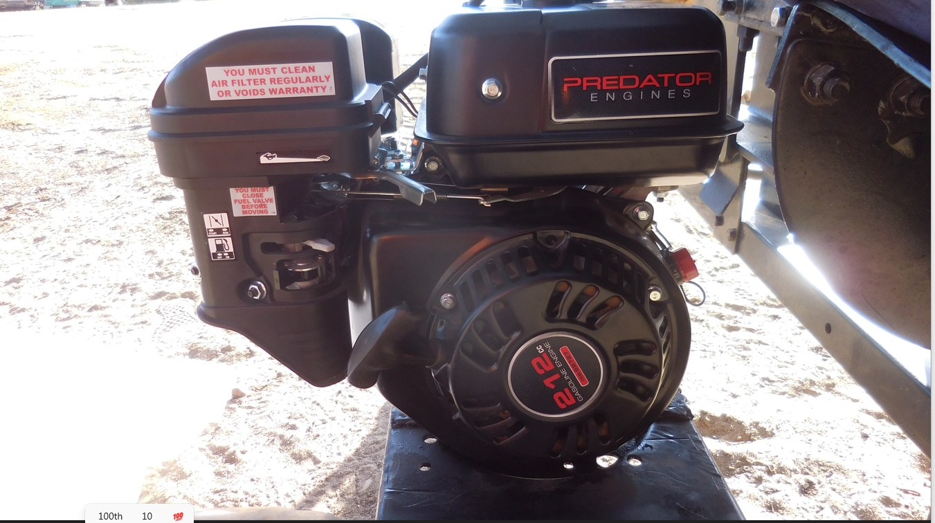

I purchased this splitter for $100 from the local Craigslist for the fun project.....
Actually, I was looking for a splitter that can split the logs vertically or horizontally.
I was hard to lift heavy logs on the horizontal splitter that I used to have it because of age...
Total cost was less than $300 for all and works like a champion. :D:D
I split the firewood more than 6 cords this year alone.

Actually, I was skeptical after installing the HF engine because it was sooo cheap.($99):unsure::unsure:
Now, I am so surprised by its performance that the engine has splitted more than 12 cords of very hard live oak firewood since installed.
The engine still runs like new and will last long in my judgment.

Yes, I rotated the pull-start assembly like this.

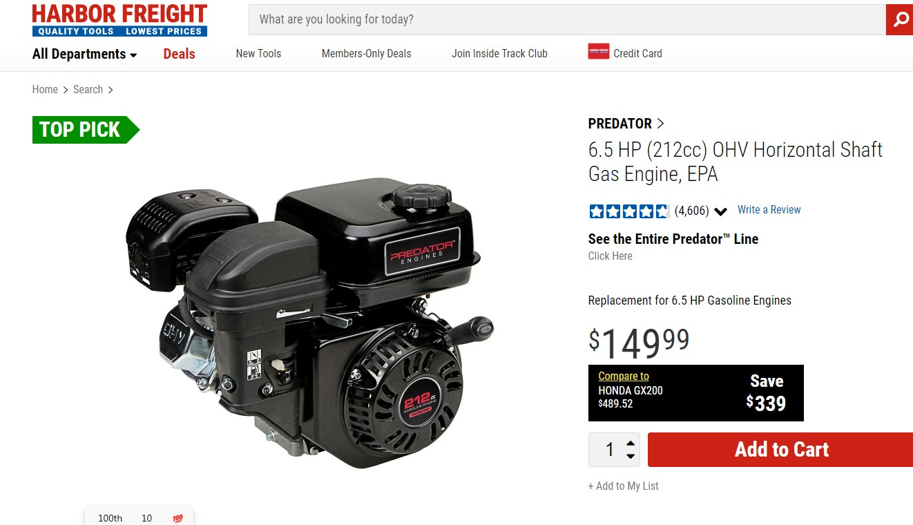

6.5 HP Predator is 212cc....

It is 212CC = 6.5HpStrong and well-made engine.
Unfortunately, the price is going up continuously..:unsure::unsure::unsure:
