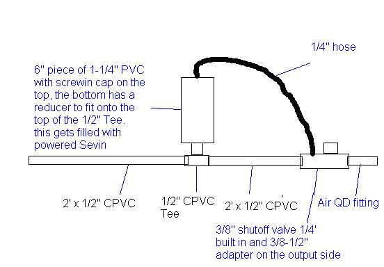

see the desigh I posted a while back, it more or less blasts Sevin dust out using compressed air... it has worked well for me (Picture: 103608d1212152122-carpenter-bees-seven-gun.jpg)
I fill the 1-1/4" pipe most of the way with Sevin dust then I drill a 1/2" hole into the nest, spray some bee spray (or brakekleen, it is much cheaper) to quiet them down, then I hook the gun to a air tank, I stick the nose of the gun into the 1/2" hole and I empty the dust into the nest. that has killed them every time I have tried it so far.
you could stick the nozzle into the nest and coat the whole thing in dust, they will be dead within a few days.

see the desigh I posted a while back, it more or less blasts Sevin dust out using compressed air... it has worked well for me (Picture: View attachment 109633)

Aaron - I like that set up - I have used the Sevin dust as well - jamming it with steel wool into the hole. But the spray was pretty much instant.
