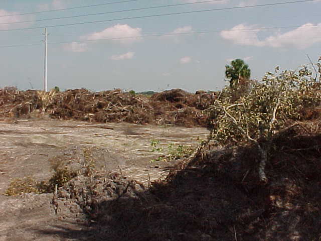

Now we get to the good stuff. Like everything else, though, nothing is as simple as it seems, and there is always preliminary work. In this case, they won't start to spread the fill until all of the organic material has been skimmed from under the house pad. I staked out the actual house (minus porches and pool), and they skimmed the grass.

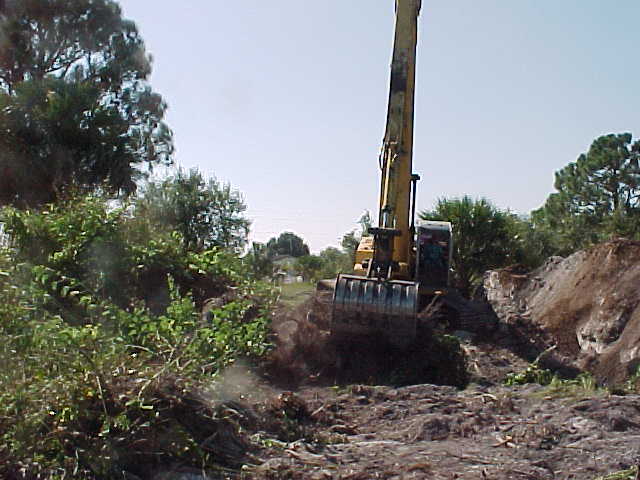

Now, on to the pond. First cut. Turns out the operator is color blind and can't see the orange paint line on the green grass. So, I started putting stakes every few feet all around the perimeter, leapfrogging them as he finished one section and moved to the next.

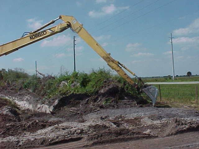

These guys think of all the details. They only want good, clean fill under the house and barn, so first they skim all the grass off the top of the pond and use that for fill in less important areas, like the low spots out along the highway. This also gives them (and me) and good outline of the pond.
