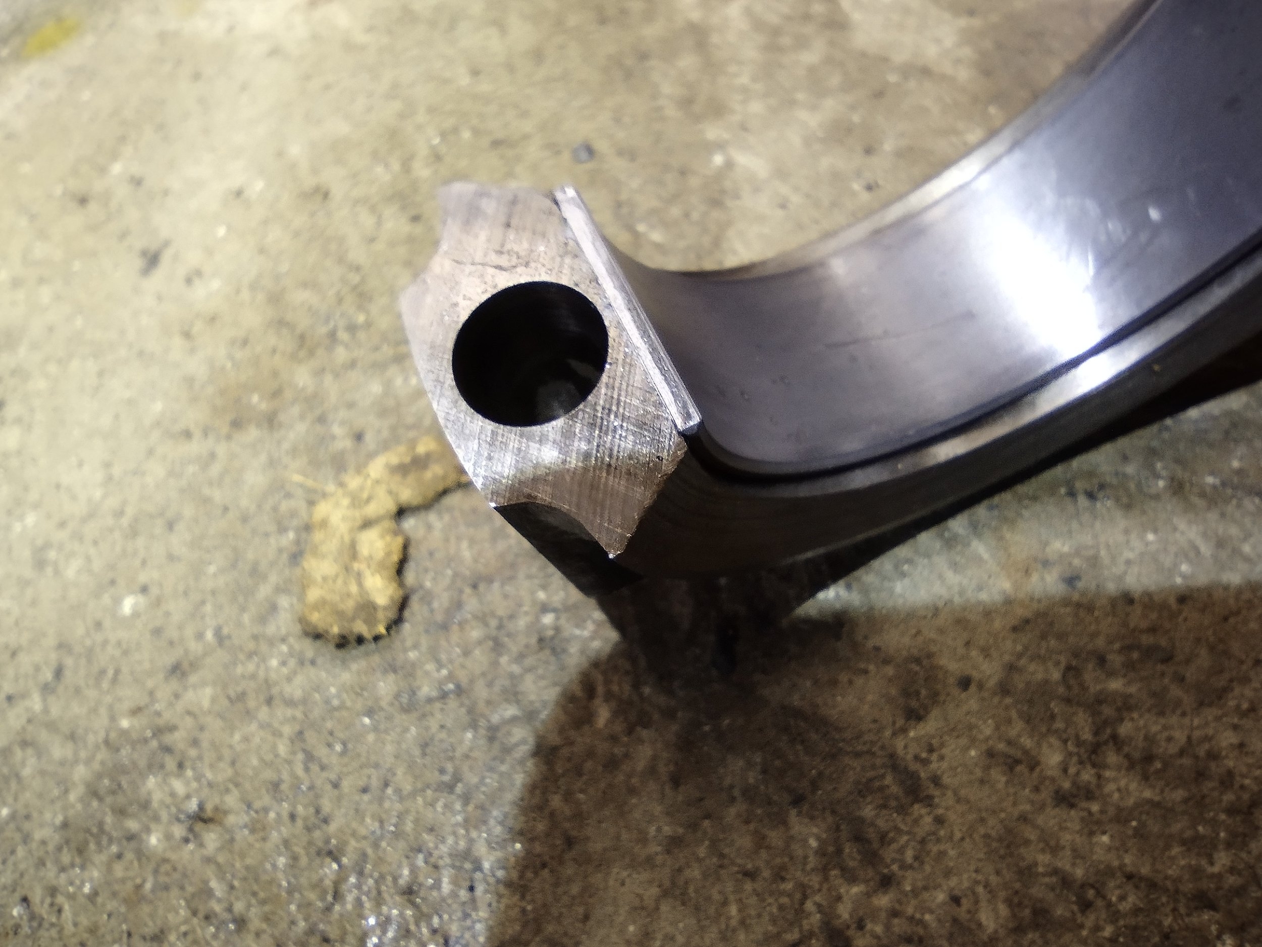

Finally got around to tearing down to inspect.

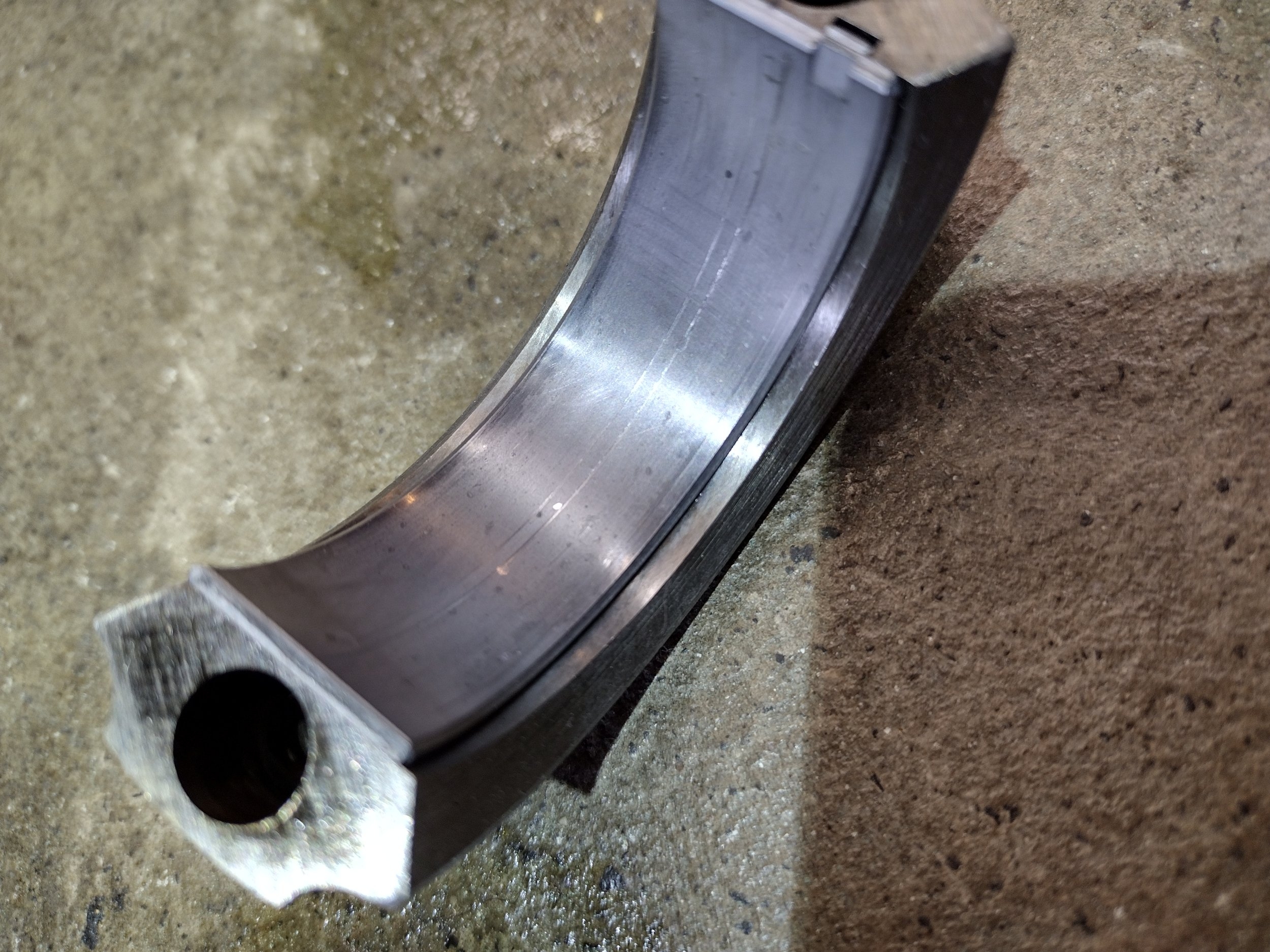

The big end bearings had 0.003 - 0.0035 of clearance when checked with plastigage. So they fall within spec. There is some light scoring that I can catch with my finger nail.

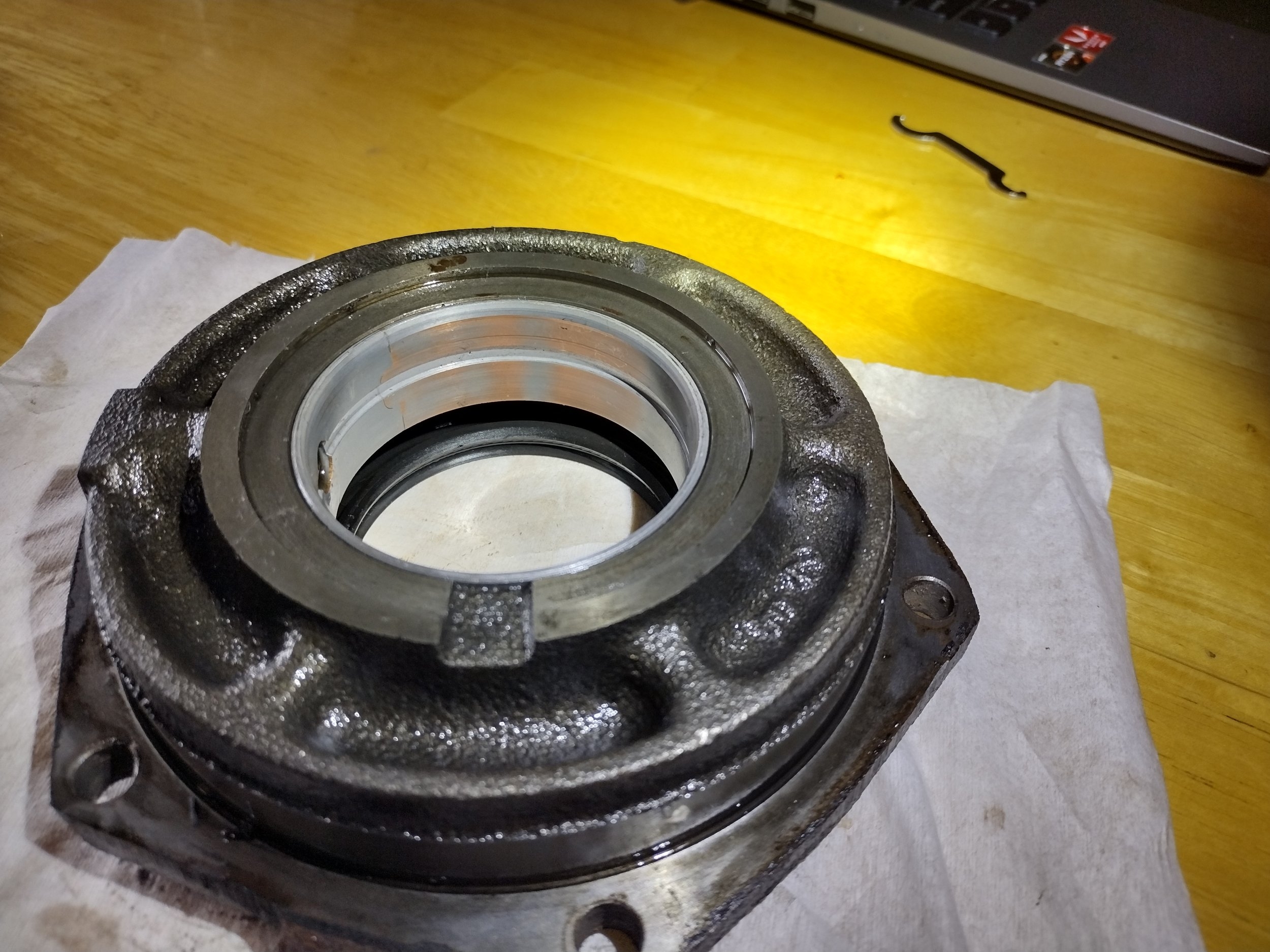

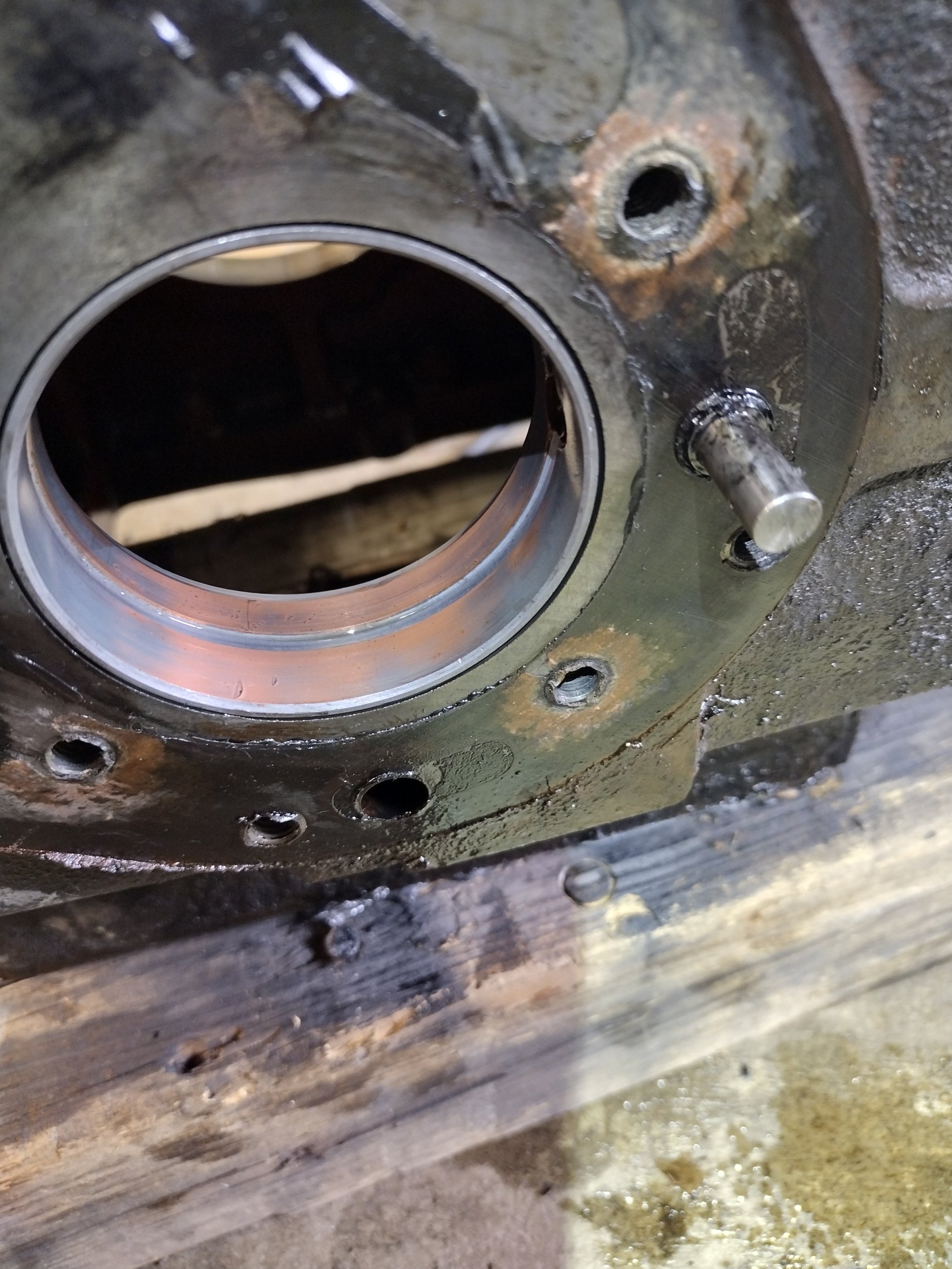

I pull the engine and finished teardown. The main bearings appear worn. The gold color is not a camera issue, it appears the crank has worn through the silver colored layer of the bearing material.

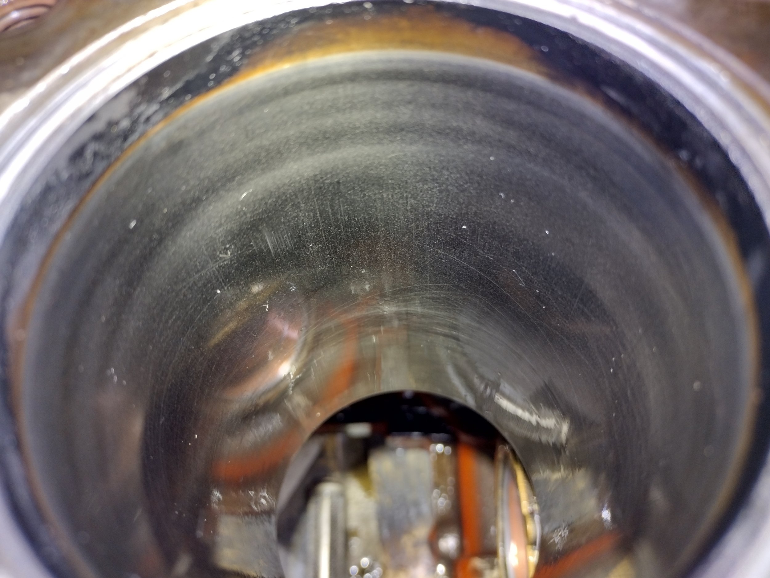

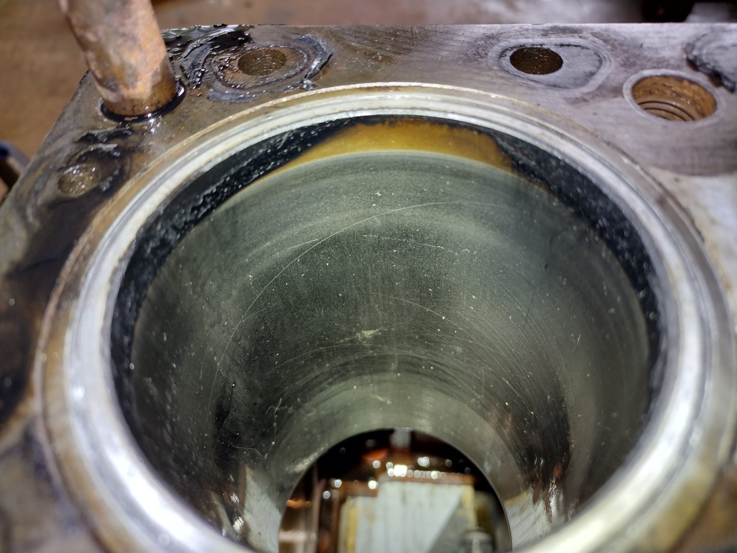

The bores appear to me (I'm no mechanic) to be ok with some light wear.
Crank looks perfect to me (again, I'm no mechanic).
I'd like some input on how to proceed.
My initial thoughts are:
Gasket set
Hone and new rings
Oil seals
Main and rod bearings
Oil pump
Lap the valves
Do the valve springs need replaced? no idea
Clutch still looks decent, I don't plan on spending money there.
Any other thoughts?
   / YM165 Low oil pressure #20
I like your train of thought. Personally, I would not replace the valve springs.
