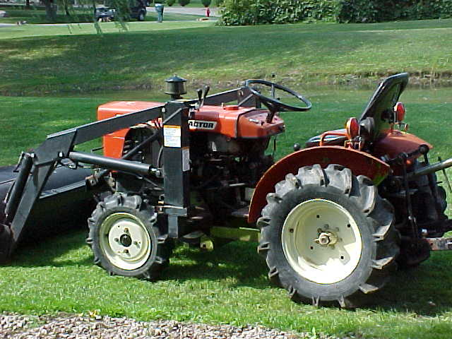

I went back and looked at my pic, and it does look a little nose high, but i think its more the picture than the tractor. I took a look at the tires and they are correct.
I am interested in knowing more about a front PTO, and what it would cost. Though if it is going to cost more to put on a front PTO and buy a used blower than i paid for the whole tractor, i might not be as interested as i had thought i was ! Forgive me for not knowing this already, but are you a tractor, or tractor parts dealer?
As far as my question about the similarities between the Yanmar and the JD "50" series tractors..... when i was at the green tractor store (where i bought my tractor), the parts guy there commented on how the 650 / 750s were virtually all Yanmar. I just thought that if they used common motor and rear end castings, perhaps something like a subframe for a 750 might be an easy fit to my tractor. Perhaps their parts guy was mistaken, or perhaps i'm being silly for thinking they would share any parts.

Good to know you have the right tires. The wrong size tires are supposed to stress the 4WD. /forums/images/graemlins/blush.gif
Have you had time to read back through the old Yanmar posts? There is a ton of useful stuff burried back there.
I don't want to discourage you but my what's her name hasn't sofened up on the FEL yet. Maybe you will have more luck. /forums/images/graemlins/wink.gif
I got my snowblower used from Gary Jamieson up in Honesdale PA. He is a dealer and a good guy. Same as you it looks like to me that stuff that fits the JD 750 may fit the 186D. I thought the JD electric clutch off the 750 might fit the yanmar. Sometimes thay have used ones at Wengers. I decided even though the yanmar clutch was pretty salty I would get a new one from Gary who had them in stock at the time.
Do you have a kubota dealer around you? Take a look at the 7100. I always thought some of that stuff could be made to fit the 186D
I was wondering when you are plowing does the blade push the rearend to one side? It does on mine but I don't have rear wheel weights.
