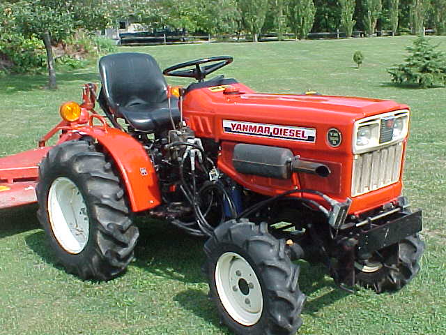

That's a great looking rig...and you may want to consider hanging on to that finish mower too. They are a high dollar item around here, even one that is in less than average condition.
   / YM186D
#22
I found 2 dealers (I'm sure there's more)that have a loader that will fit. They say it may need a little modification . I'm not sure how much . Hoye offers one and so does Len Sheafer. Both had prices with in $100 of each other. I'm not really convinced that they don't need a subframe. Neither dealer said it needed one. This is a Koyker brand loader. I'm sure I can fabricate a subframe but don't know if it is wise to do so. They're not that expensive , not cheep either . I would like to see a photo of your YM186 sometime. I'm thrilled to have found it.
Mark777
I don't want to get rid of the mower but it will sit out side all year and rot away . I can't use the rear finish in my yard. I would like to see it go to a good home to someone who would take care of it and actually use it.It's probably worth $1000 new . Would like to get $500 for it. It kills me to see it sitting out in the back but I don't have anywhere to store it. Even the tractor sits outside under a tarp. I need a bigger garage!
