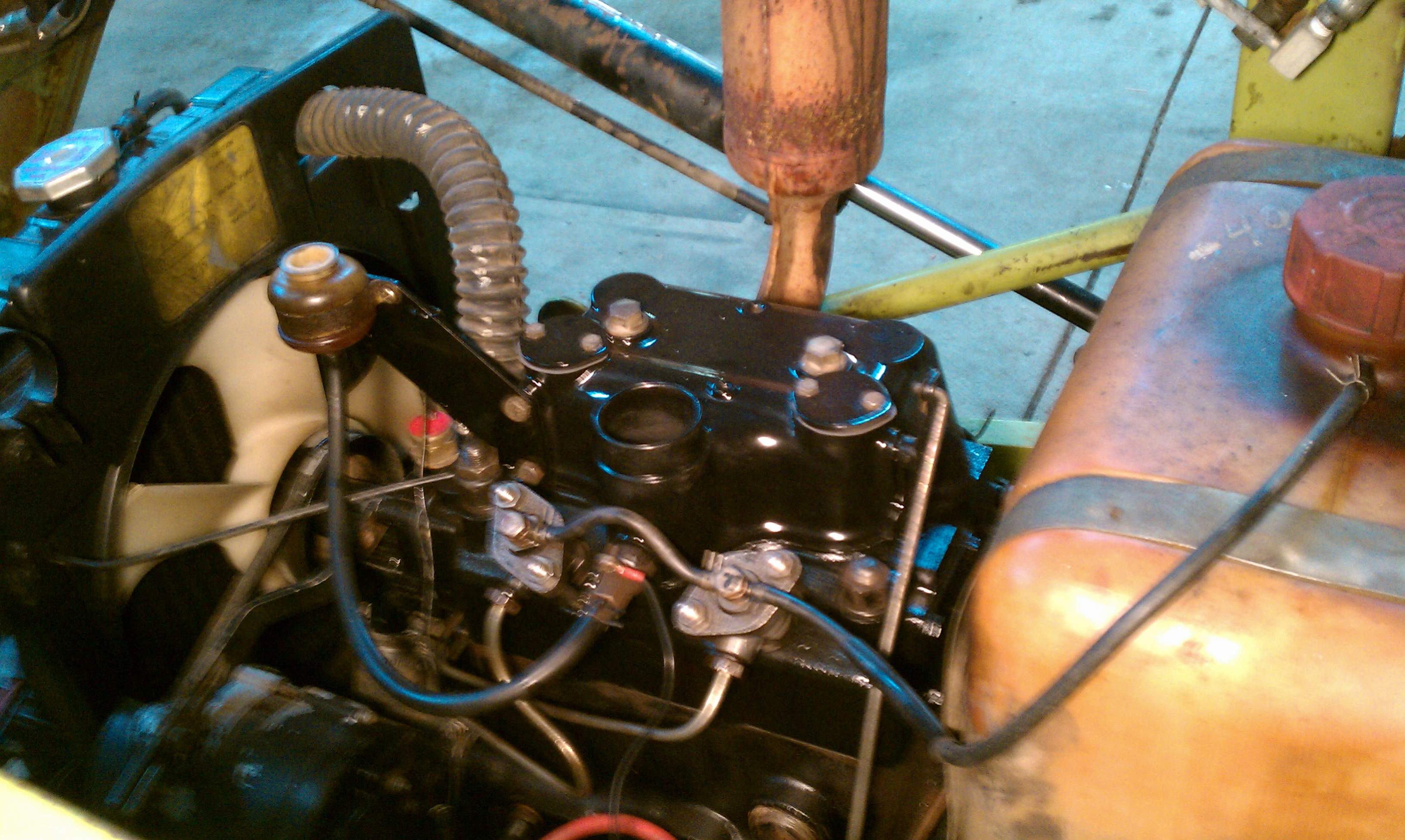

Torque spec. on the rocker arm assembly nut is 58-72 ft lbs. Just a note when you torque them back on. I used a large cresent wrench to hold the retainer clips from twisting with the nut as I torqued. They wanted to twist and bend if not held in place.
It looks as though your radiator shroud is missing. which helps funnel the air through the core. As far as the mounting of the radiator. There are only 3 pts of contact to hold it place other than the hoses themselves. 2 studs in the bottom, which it sets on 2 rubber mounts, and the bracket you mounted onto the head.
I suggest if you do pull the radiator again. Take it in and have it flow tested. If you have some restricted areas this could be contributing to your over heating. If the core is good they maybe able to rod it out for less than buying a new one.
As far as the return lines on the top of the injectors. I don't think much fuel if any goes through there. But i too am curious how that works.

The little thermostart bottle is designed to be kept full by the leakage by the injector stems. My 2002d does exactly that, however, I have read of many that didn't feel they were getting anything out of there either. I seldom use mine so use very little out of it. Not enough that passes through it that you can see it drip back into the fuel tank. I would suggest hand filling it the first time and then just keep an eye on it.

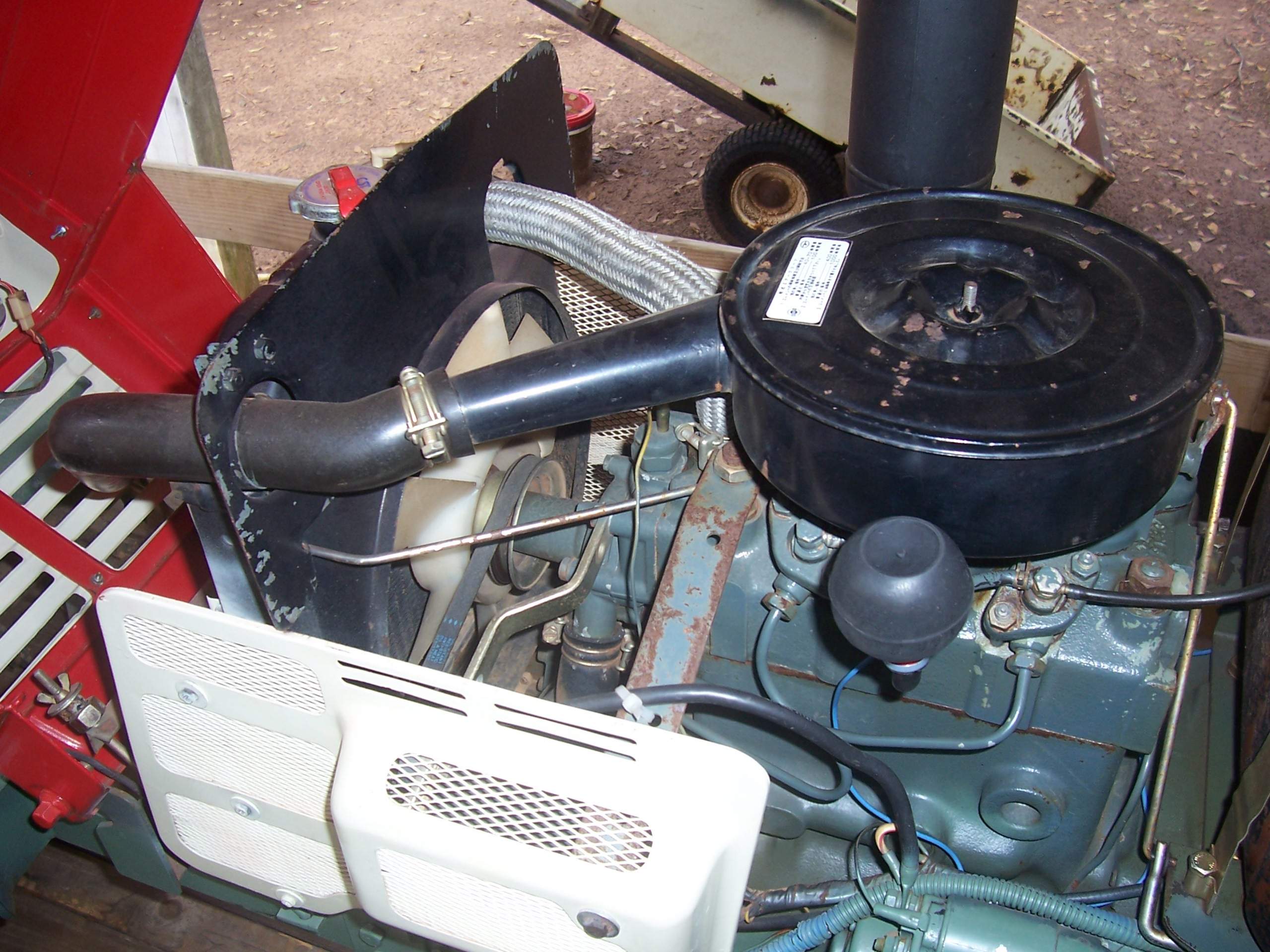

It was in the low 30's last week so I was able to check my TS setup out. Works great and Cheap!!! Parts from the Junk Box.
Winston on my Alt. Belt I was able to get a better look and found the Logo. MITSUBA. Google came up Thailand.

My TS bottle finally filled up after a couple of days of running the engine around 1800 to 2000 rpm. Appears it will produce some fuel in the return line at higher rpms and then only a little. Now the bottle stays full all the time.

On my 240 the injector over flow goes straight to the fuel tank. My thermostart has a small reservoir, that I have to manually fill.
