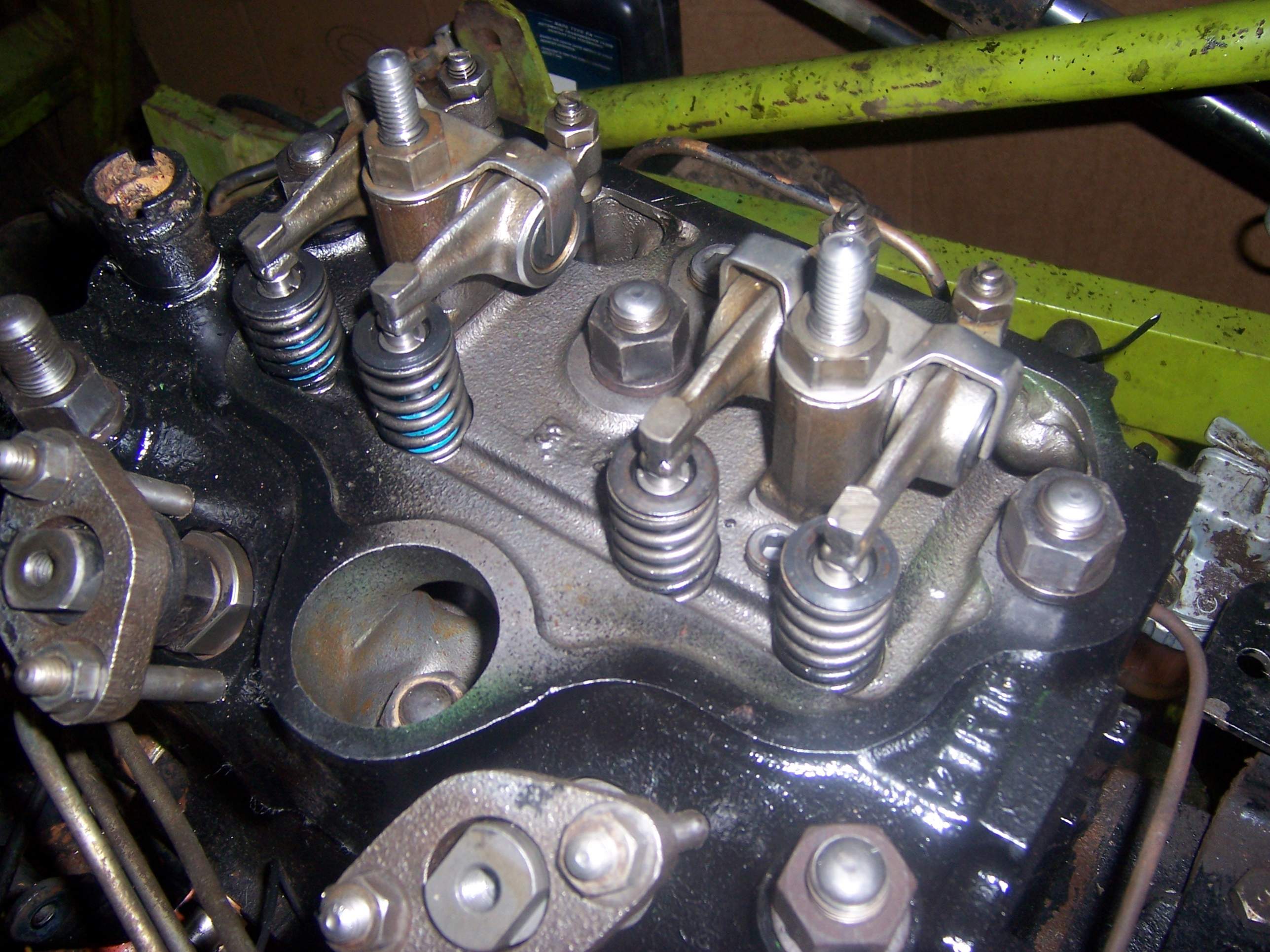

California, do you have a YM240 parts manual handy? I don't see anything in his picture to hold the rocker arms on the towers, (he mentions side play), as in item 28 .
From the head shot of the valve train, it looks to me like the offending valve adjuster is backed out quite a bit more than the other 3. (Like 1 full turn at least). ... why would the arm need to be adjusted like that
Norm I'll find and scan that page after dinner. I think you found the problem.
zzvyb6 [???] I noticed that too and I think it is a clue. That's why I suggested the valve lash might have been set at other than tdc.

True. But there has to be a reason why that adjuster is at the end of its threads, as if the pushrod were too long. Measuring valve lash with the cam part way up its slope is the only reason I can think of to cause this.

I can't tell that much difference on the threads showing on the valve adjusting screws. Looks to me like they are pretty close to the same. I'm probably not seeing it correctly. Even if there were room for a little extra slack because of the cam not being true on all the release time I don't believe it would be possible to be enough difference to allow a push rod to escape.
My YM240 parts manual shows the identical diagram to the Hoye page you referenced so I didn't bother to copy it again.
Norm, you are right. The "Diagram 3 item 28 #124450-11290 - Retainer, rocker arm 2 pcs" shown in the YM240 Parts Manual (and Hoye's web page) are missing in 284's photo.

'284', I see something else unrelated in that photo of the rockers.
See that cylinder head stud at left-front of the head that has extra threads sticking up? There should be a rod on there about 12 or 16" long that goes forward at a 45 degree angle to the left edge of the radiator, to support the radiator so it can't fall back into the fan. There would be a nut above the rod when it is in place.

Sorry it has taken me so long to respond. I don't have any other leftover parts, at least nothing that look like the "set plate" retainers in the diagram. I will fabricate or order something. I think this is the trouble, though. It seemed odd to me that there was nothing retaining the rocker arms. I should have done more research.
I tried setting the valve clearance a couple different times, and spinning the engine through to recheck, but I'll be more careful this time. I will count threads in the morning; that was a good catch noticing the difference (if any) in thread counts on the adjuster. I didn't even think to compare them.
Looking at Hoye's diagram, the pushrods and lifters are all interchangeable, so they aren't put into the wrong spot. Hopefully with the retainers on the rocker arms everything will be functional and keep things in line.
