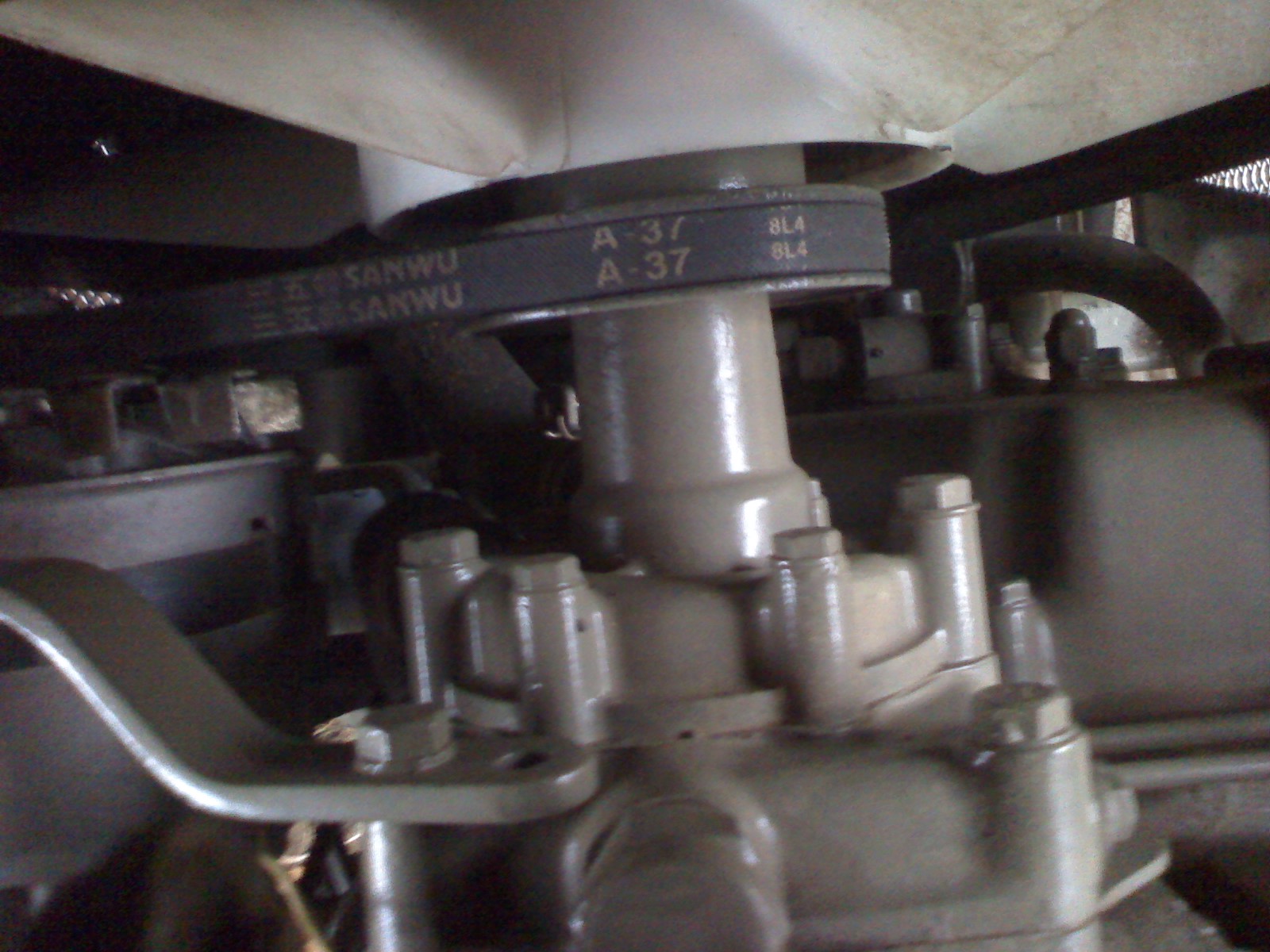

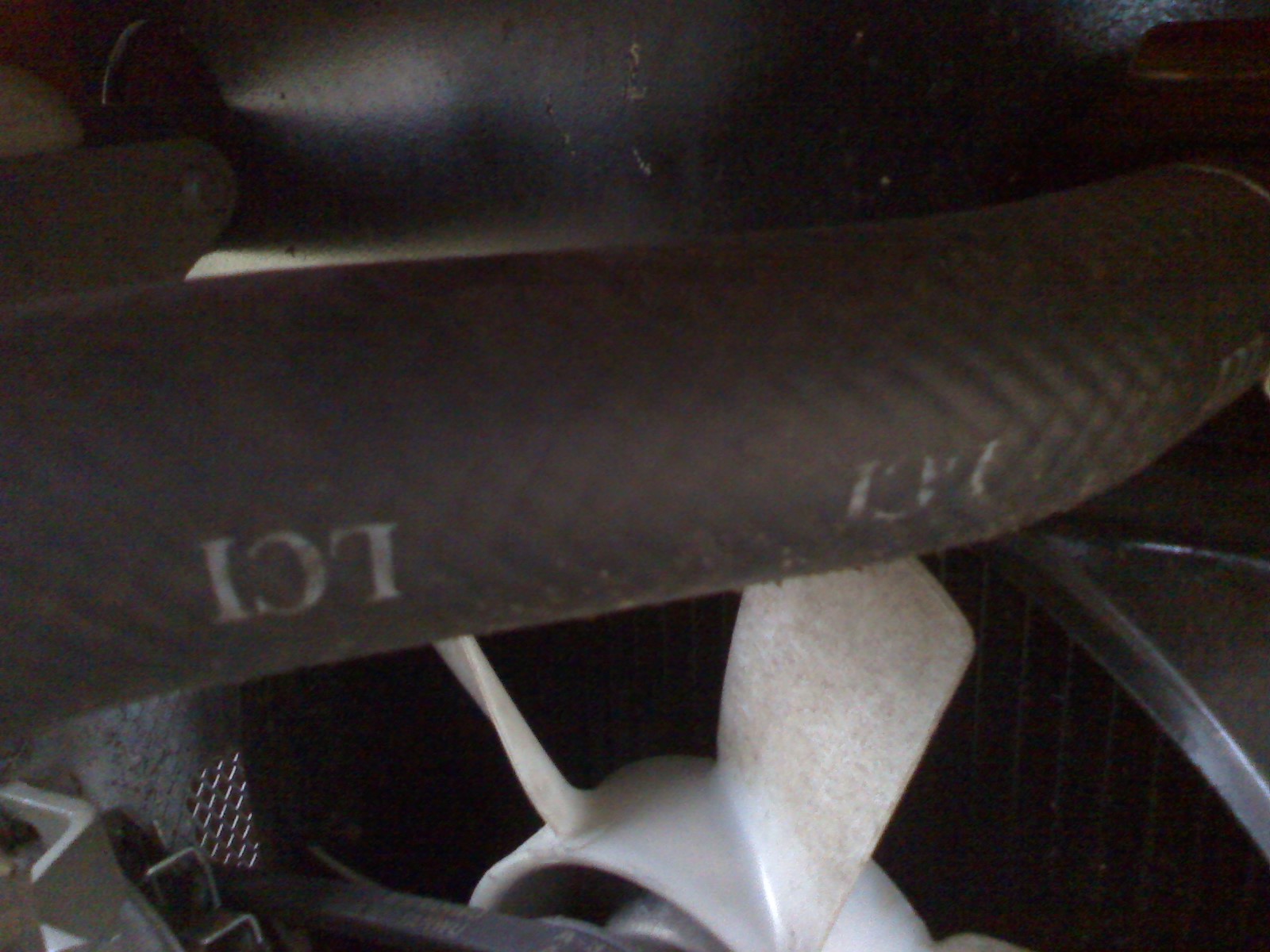

Here is the pictures of my belt. I was wront it does not say LCI. The hoses i was positive said it so i included a picture of it, that must have been what i was thinking.
I meant to post the last paragraph and pics for a different thread, i forgot which it was in and accidentially put it here. Since i cant figure out how to delete the pics i will leave it up, to not have the confusion of the deleted text but the pics still up.

It looks as though your radiator shroud is missing. which helps funnel the air through the core. . :)
Also, replace that busted up fan. These 2 parts will help in keeping the engine cool
