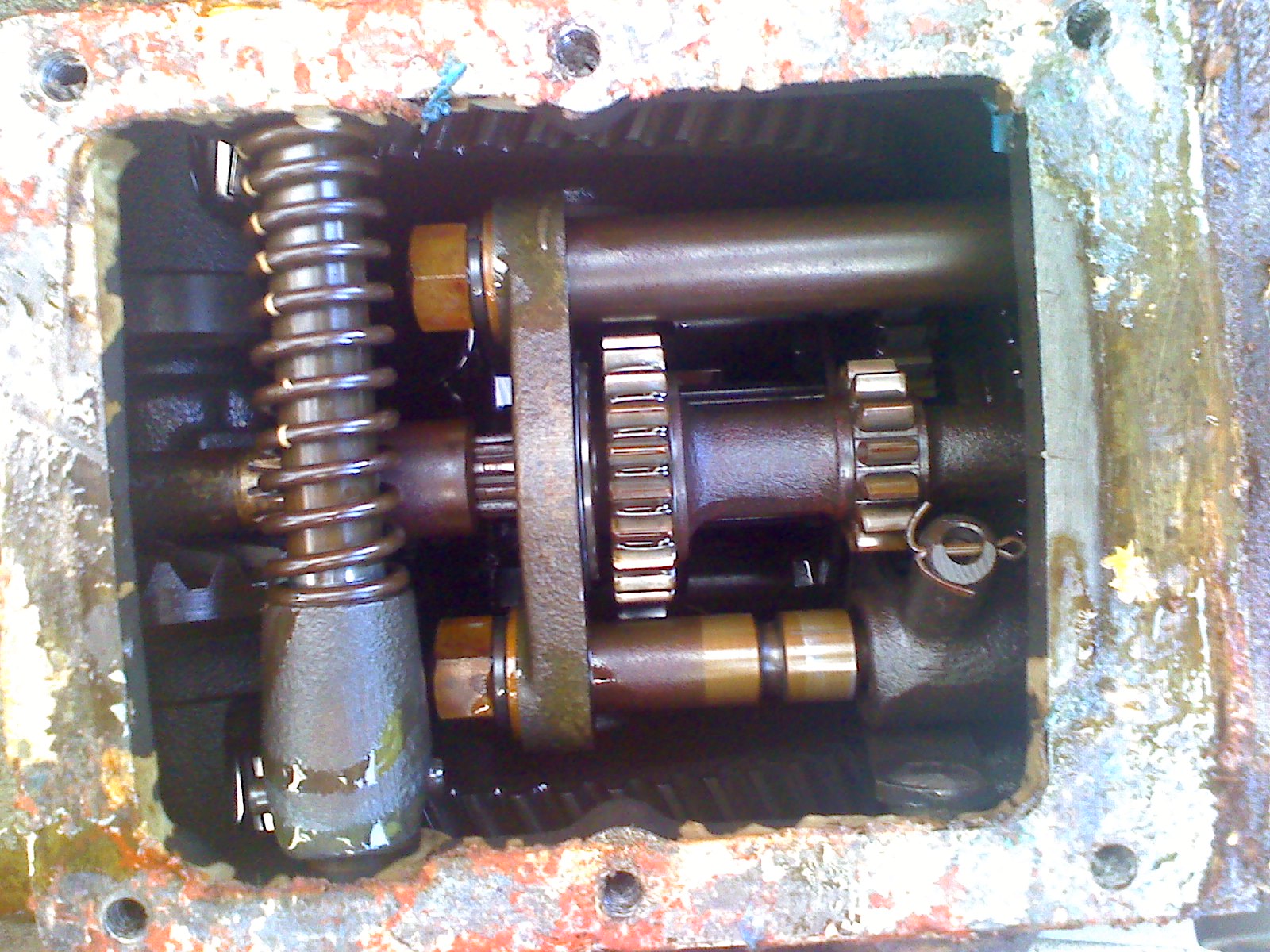

Clemsonfor was referring to removing the hydraulic lift unit which covers a large area on top of the transmission. Picture of what you can see with his removed. Started this thread a couple of hours ago and just got back to it so a little late.
   / YM240D developed clunking at rear wheel #34
You can see the Bull gears in this pic. The huge gears at the edge of the case on the top and bottom side. But as you can tell there is no way to remove them without pulling the PTO. You can spin them with the wheels in the air though and look for missing teeth on them from the top at least.

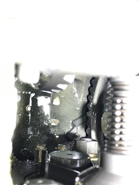

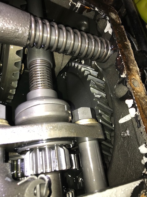

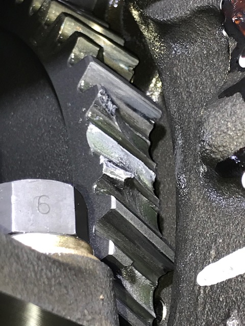

So again another update. I pulled the 3-point lift arm unit. WAY easier to remove than the PTO. I think it took me 5 minutes.
As I suspected.... missing teeth on the larger passenger side drive gear (bull gear?). In all there is a section of completely or 3/4 missing teeth. Oh I壇 say 5 teeth in total!
So, waiting on service manual to arrive, but in the mean time. Parts! Can I get new replacements or am I looking for donors? I found a guy in Portland (3hrs away) that I致e already confirmed has a a 240D with rear end internals in tact. I壇 prefer to buy new because there痴 no wear and it would save me 6 hrs travel time.
That appears to be the extent of the damage. Phew! The smaller drive gear driving that gear has some pitting and wear, but nothing major. Still needs to be replaced but it seem to sustain minor damage in comparison.

Here are some pictures of the carnage...
The very last pic you can see the broken off teeth at the bottom right.
   / YM240D developed clunking at rear wheel #40
Ow! Ow! Ow!!!
We've read that these transmissions are near indestructible. This is the first one with stripped bull gears that I recall reading about on here.
