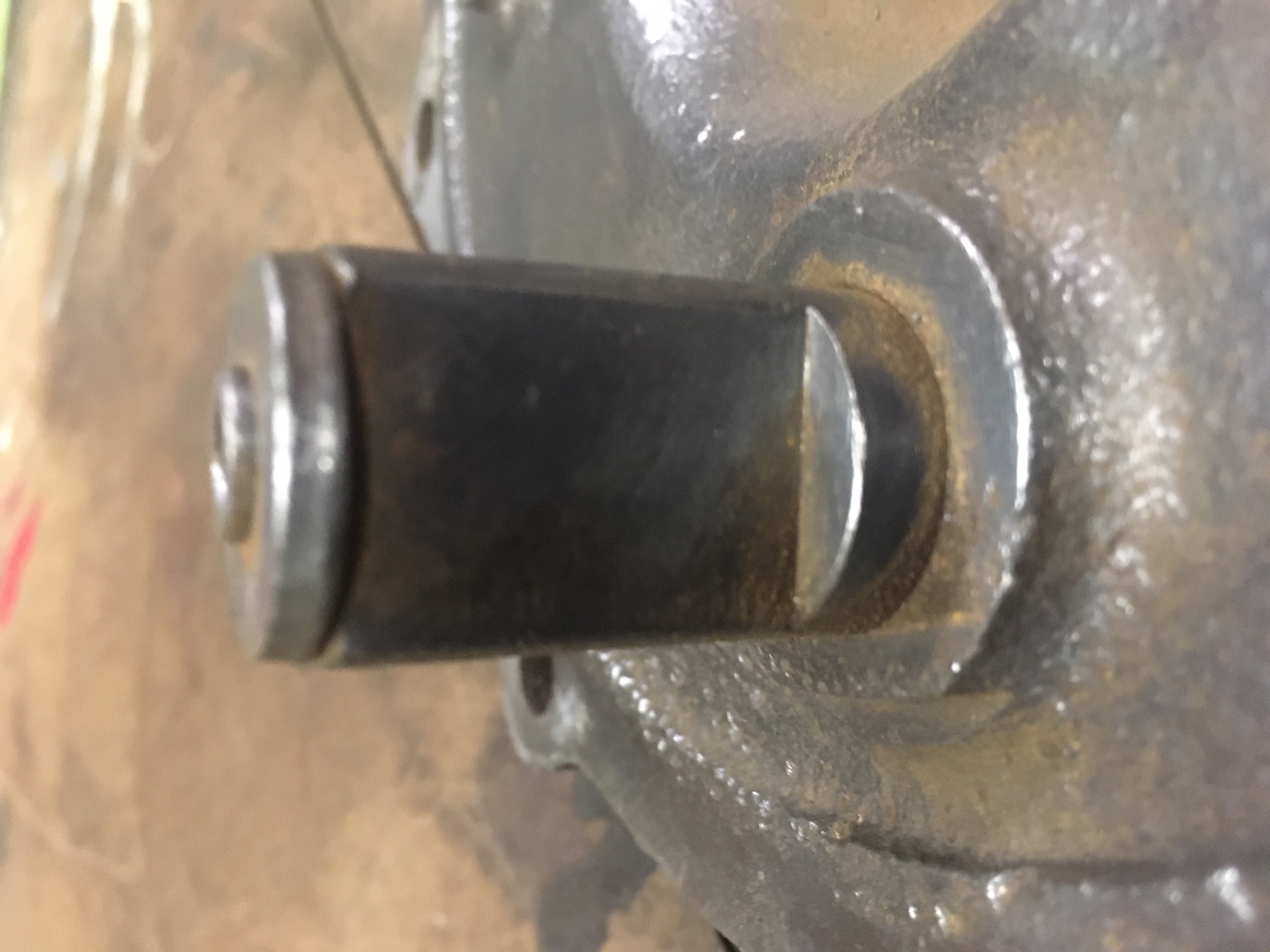

#45
Here is INSIDE the cover. This is the back side of the cam. Best I can tell the top one would push out the opposite way.
   / YM276D Brakes #46
California,
Do you mean a snap ring on the INSIDE where all the rust was? I have been cleaning it and can take a look.
There was a snap ring there on the YM186D, in such poor shape that I had to go to a specialty parts house for a replacement.
But I was mistaken re your tractor. Obvious from your photo, no circlip (the more correct term) there.
Listen to rScotty. He's a pro with much experience. (Winston too). I'm just throwing out opinions, obviously not always correct ones.
Now I'm curious. What does hold that shaft in there?
Incidentally - post #45's photo seems to have disappeared.
   / YM276D Brakes #47
I think maybe just the shoes hold it in there.

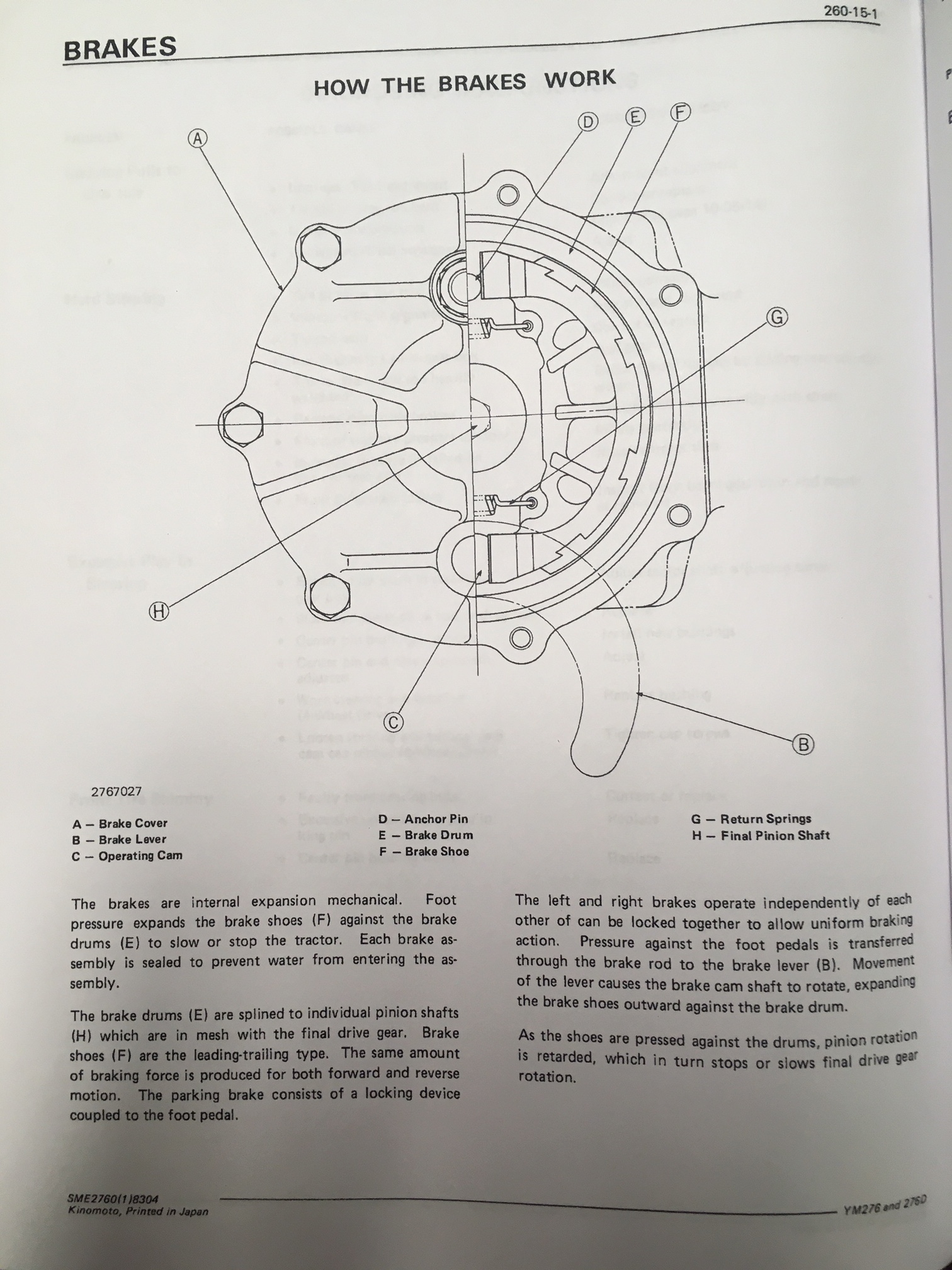

A couple of things. First, the cover doesn't appear to have any inlet to allow water inside, so if I make an inlet it would be the original, not simply enlarging one on the cover. Perhaps I should be looking elsewhere for the inlet. Second, the manual certainly doesn't offer much wisdom on how to disassemble the cover. It merely provides a rendition of the cover and simple explanation of how brakes work.
   / YM276D Brakes #49
Covers and vent holes in the covers - or not - did vary. When they did put in a vent hole it was a single simple drill hole about 3/4 of the way up the face of the cover and sometimes slightly angled upwards. Diam. about 3/32".
My guess is that Yanmar knew they had a water-in-the-brakes problem, and were trying simple ways to fix it. The same applies to how the brake cam actuator shaft is sealed where it passes through the cover. Take a close look at that as well.
My suggestion is to consider what happened to your brakes, and then ask yourself if that is how they intended the brake housing to work?
Did they intend for water to be trapped and cause corrosion? Probably not....so then how can it be improved? We may not get it right the first or secont time around...but then neither did Yanmar. The good news is it would be hard to make it worse. I see this kind of thing as being part of the enjoyment of having a vintage tractor.
BTW, make sure that the decal that is in the center of the steering wheel is intact. The decal is part of Yanmar's scheme to block water from flowing down around the nut that holds the steering wheel on and then eventually onto the top of the steering box where it eventually gets past the upper seal, displaces the oil in the steering box, and rusts the steering box bearings. So take a look at your steering wheel. If you can see the nut instead of a center mounted decal then check at the bottom of the mounting tube where there should be a small weep hole right above where the shaft connects to the steering box. Make sure that weep hole is open. Better yet, tarp the tractor. Or both.
