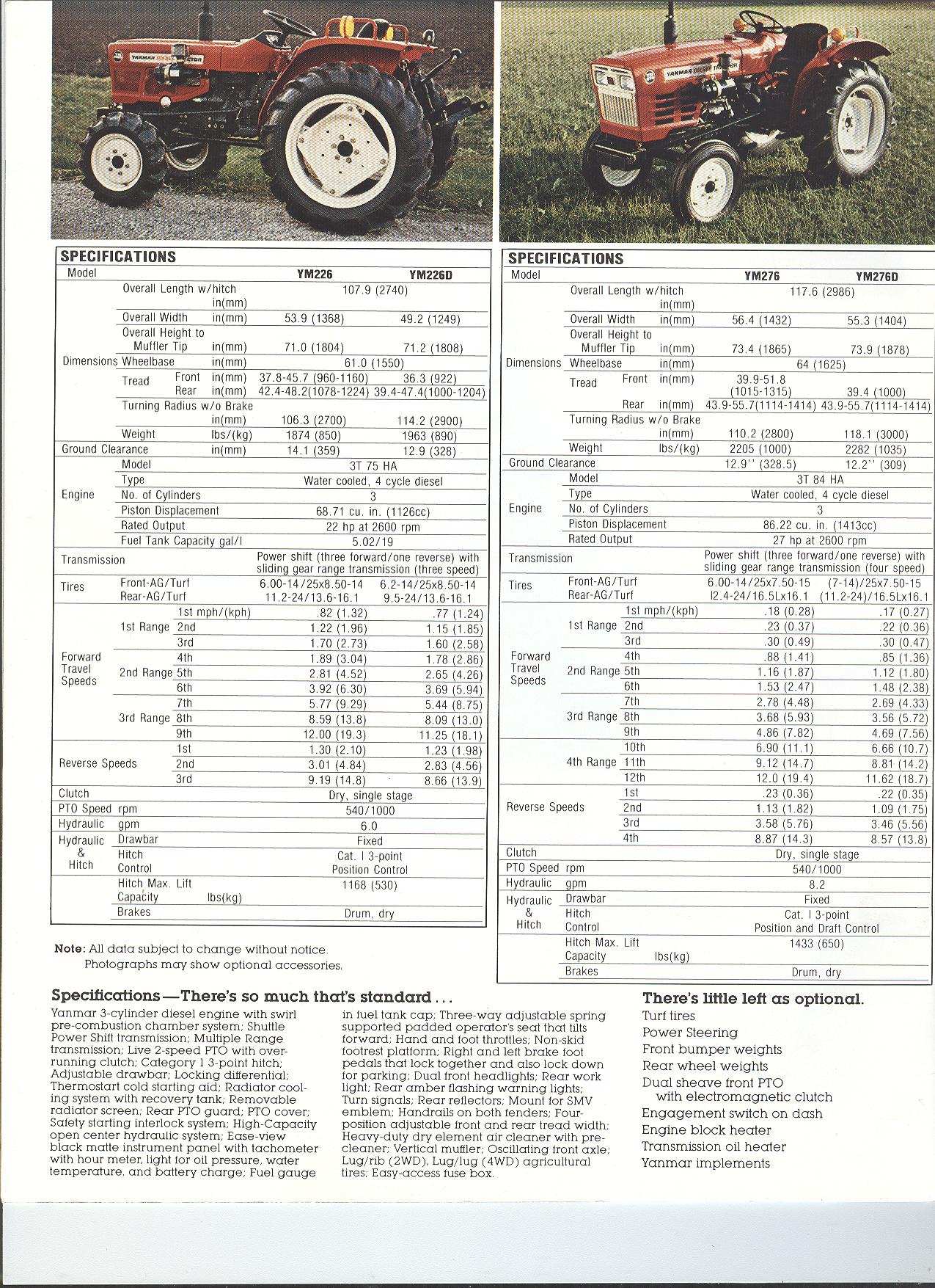

After a discussion with a tire store clerk who's been in the business a few decades, he explained that the "25" in the tire dimension 25/8.50x14 means that a tire will be between 25" and 25.9" in diameter depending on the tread. The 24/8.50x14 is between 24" and 24.9" in diameter.
The tires on the front of the tractor appear to be 25.75" in diameter. Does anyone have the formula for the size ratio for the front/rear for the YM276D? I can get replacement tires from about 24.5" in diameter all the way up to 25.9" in diameter. Does it really matter if it has industrial tread on the front tires since the rear tires have a deep tread? All the "turf" tires for the front have very little tread. Thank you again.

After a few decades as a tire clerk, he should have also explained that tire diameter doesn't mean very much because tires in use are round on top and flat where they contact the ground. So his information is just incorrect enough to cause you problems. Of course it is only partly his fault, the main criteria for a clerk is salesmanship, not technical knowledge. Unfortunately, it sounds like he was able to make his guesses sound believable. The critical measurement is actually the tire's "rolling circumference". The tire clerk probably has access to this information, but may not know what it means.
Anyway, the reason why simple diameter doesn't translate into rolling circumference on the ground is that the tire is round on top.... but flat where the weight of the vehicle compresses it against the ground. This is the case for any vehicle with flexible tires that carry weight. The amount of flex - and the rolling circumference - can change with weight and air pressure. However, a good average rolling circumference can be either looked up on manufacturing specs, or measured by putting a splash of paint on the tread and driving down a smooth road in a perfectly straight line. Carefully measure the distance between each set of dots that you leave behind. That average measurement is your rolling circumference.
To find the front to rear internal gear ratio is a bit harder. I've never seen that number in print. Basically it is a ratio that is set by the difference in gearing of the front and rear differentials. Obviously the design engineer has to know what he wants in order to design the differential gearing, but like I said - I've never seen the number in print. Luckily, you can measure that number by hand. It's a pain, but it is done by jacking up the tractor so the tires are off the ground, and then counting revolutions while you rotate one tire by hand. You mark one front and one rear tire and rig up a pointer. Then in 4wd you carefully slowly rotate one tire by hand while simultaneously counting how many times each tire goes around. Continue doing that until both tires return to the exact original position. You may have to rotate that tire a dozen revs to get both tires back to their exact starting position. But if you persist, then the front/rear internal gear ratio is the number of times the front tire went around compared to the number the rear tire went around.
An easier way is to be sure you have the correct original tire sizes, and then look up the manufacturer's rolling circumference for those tire sizes. It is typical for front/rear gear ratio to be between 1.05:1 and 1.1:1.
Here is a copy of specs for the YM226 & YM226D and the YM276 & YM276D. From an original sales brochure about 1983.
rScotty
