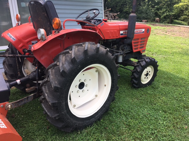

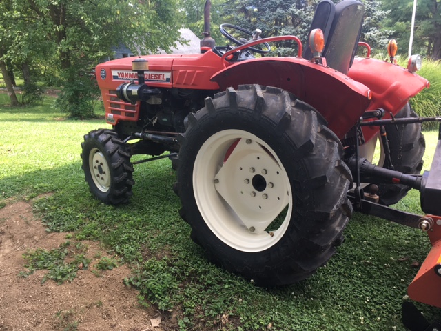

Well here is the YM276D with ag wheels/tires. I went with Carlisle tires because Titan wanted over twice the cost.
   / YM276D located and in garage #48
Just the fronts or the rears as well? Ready for work now!
