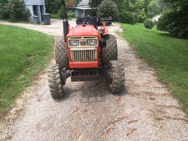

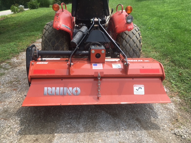

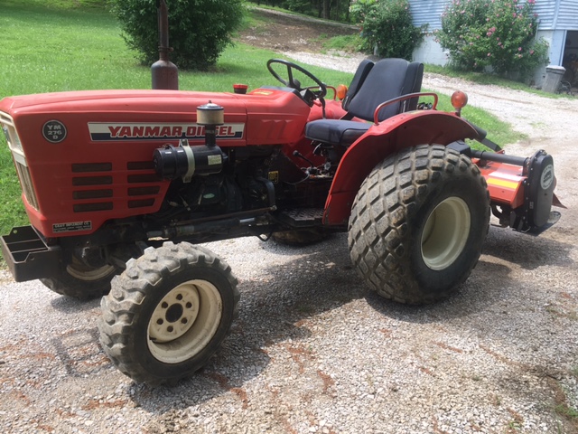

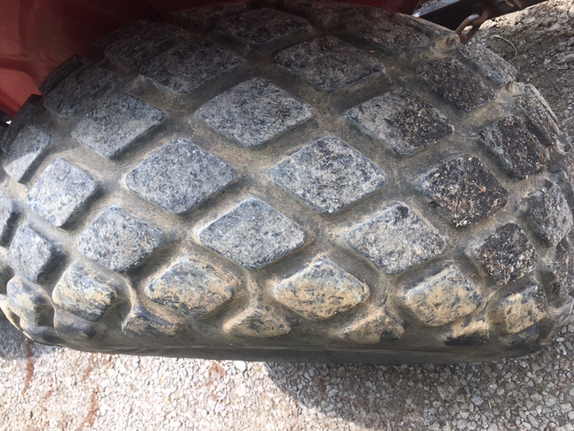

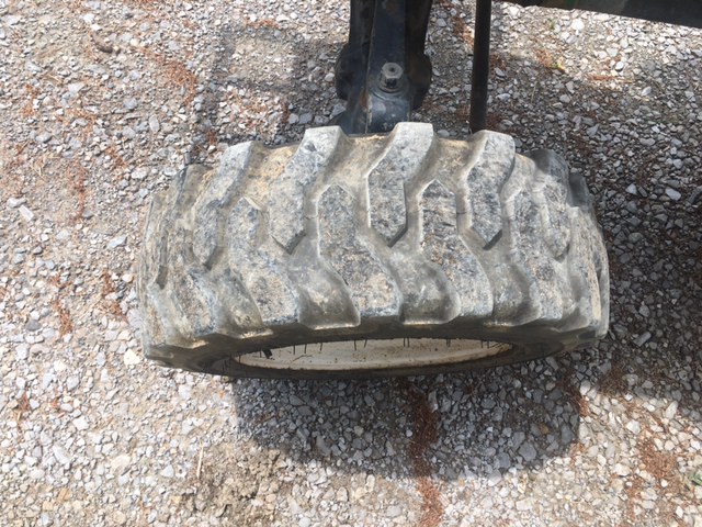

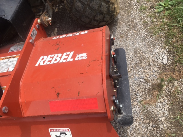

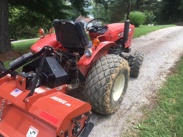

Here are some pictures that better illustrate the condition and the tires on the tractor at this time.
This the front tire.
That is the back tire.
Here are general pictures.
View attachment 516198 View attachment 516199 View attachment 516200 View attachment 516201 View attachment 516202
As you can see, it has a Rhino gear-driven tiller. Some think it's a superior style compared to the older Yanmar chain models.
I thought the yanmar tillers are gear driven?

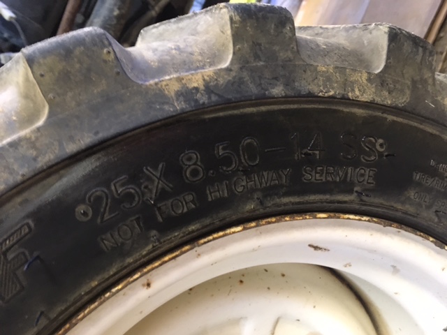

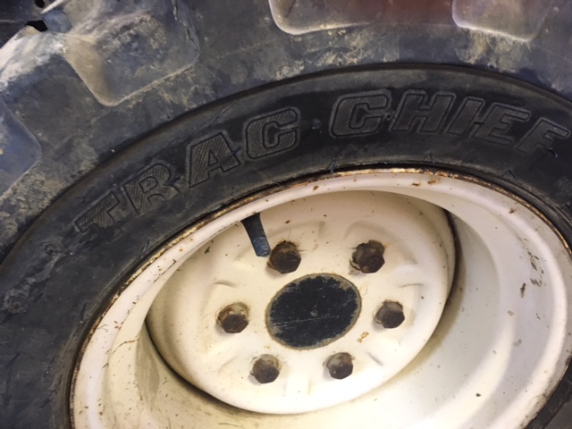

I am able to get the last page today. Rich, I cannot find the 25-8.50-15 tire anywhere, are you sure that is the correct size. I was wanting to do a little math on your setup but need the rolling circumference of that tire.
I am absolutely positive you are correct and the tire size previously stated was wrong. See the two included pictures. It's a 25/8.50-14 mad by Trac Chief. Sorry about that. The rear tires say nothing but the tire size and Goodyear along with "tubeless".
Oh the joys of finding the right tires for old tractors. Thanks for all your help.

I see Goodyear makes a front tire to compliment the Goodyear rear tire: Goodyear Softrac Mower Tire, Size:25-8.50-14, Ply:6, item number 4SR-327. They are certainly proud of them.
   / YM276D located and in garage #40
For what it's worth, here are some calculations. I'm unsure what you have on the back but if it is a 16.5-16.1 the circumference would be 109. Should measure about 40.3" tall. If that is the case a matching front tire would be a 25-8.50-14. Circumference 68". Doing the math that would give you a 2.187 front lead.
