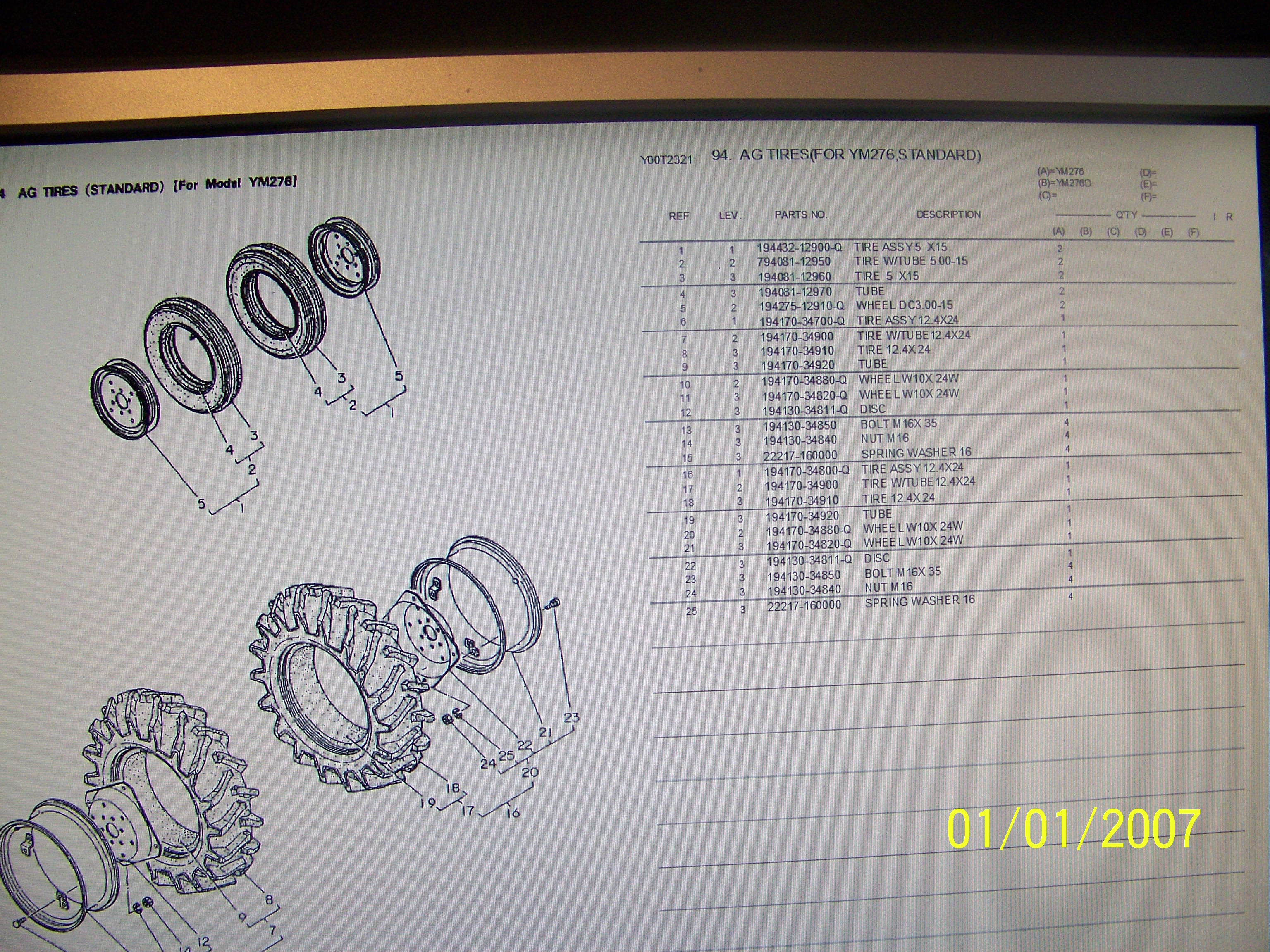

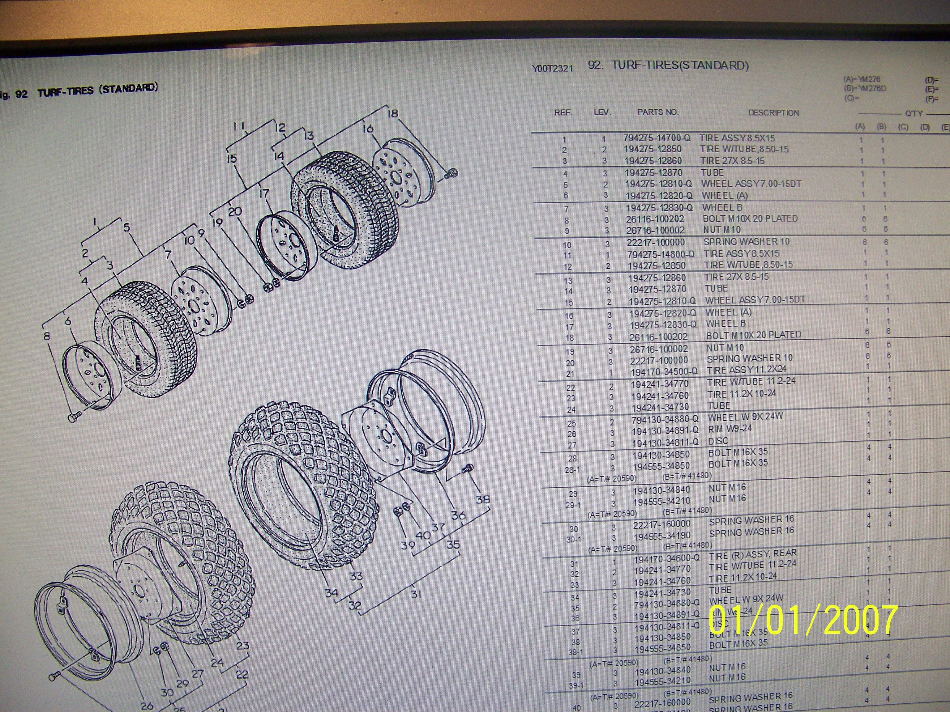

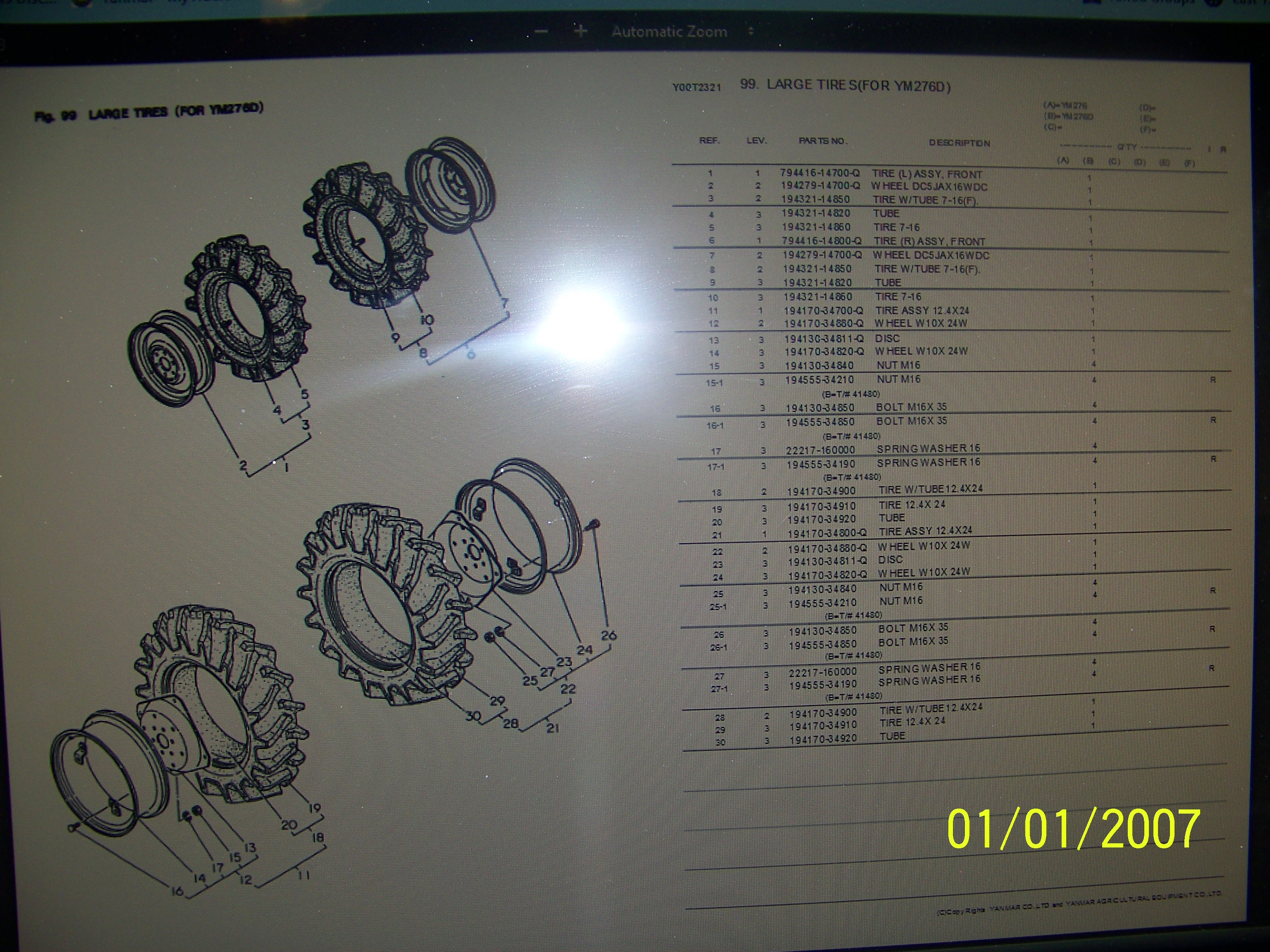

rScotty,
Thanks a lot. According to that brochure, the front tires should be 25x7.50-15......that was different than the information from the Internet.
   / YM276D located and in garage #24

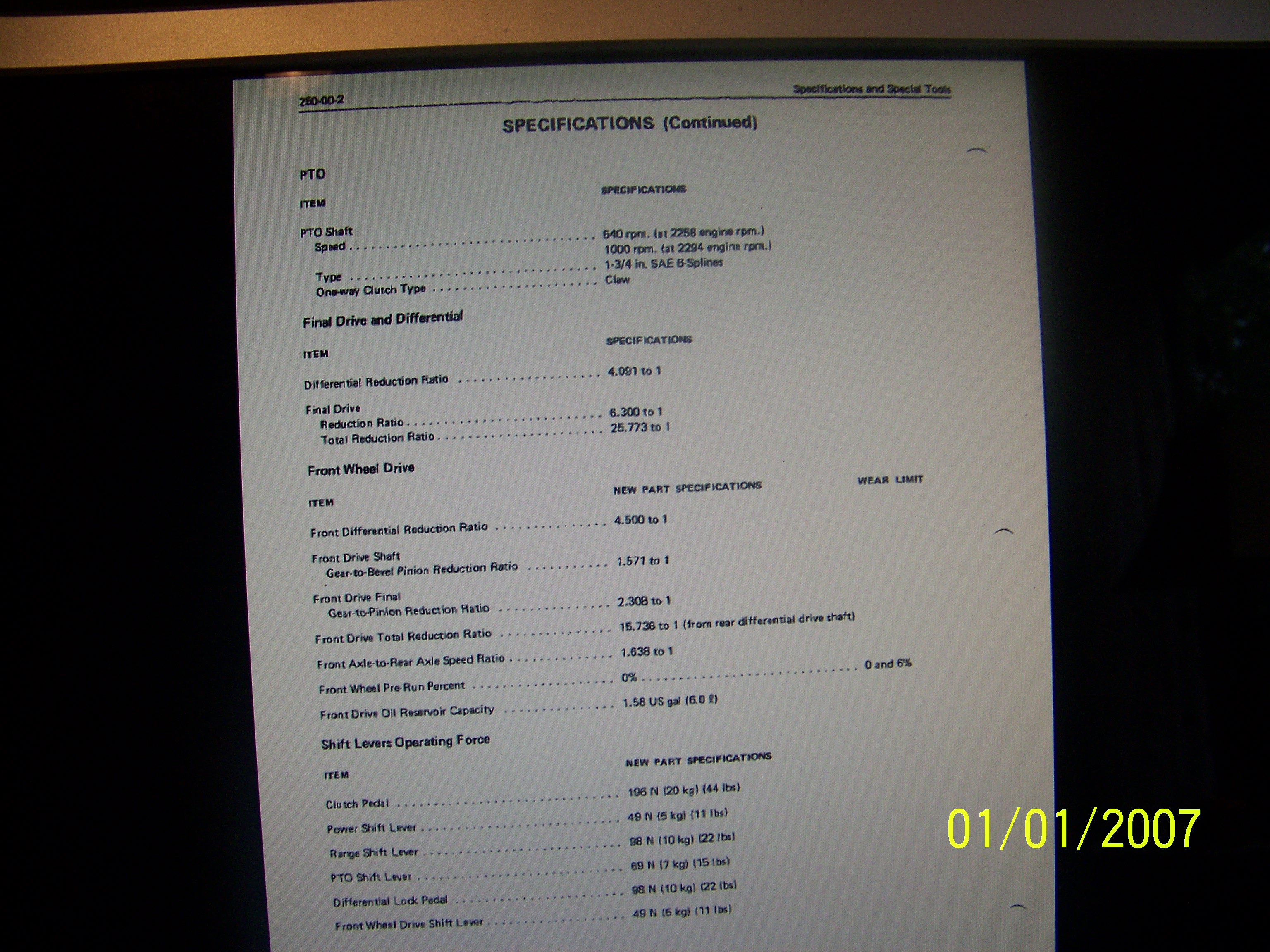

Page 250-00-2 in repair manual states 1.638 to 1 front to rear ratio. 0% runout with 0 and 6% wear limit.
Parts manual shows different wheel and rim size options starting on figure 92. The 276 actually had the option of standard or large ag tire options.
Winton, which repair manual is that? I don't find it in my Yanmar stuff...but maybe I've missed it.
Is that where you getting that tire info? Can you post a copy? I'm not sure what "runout" refers to, is it what US mechanics call "toe out"?
Likewise on the wear, how is the 6% measured? Six percent of what?
