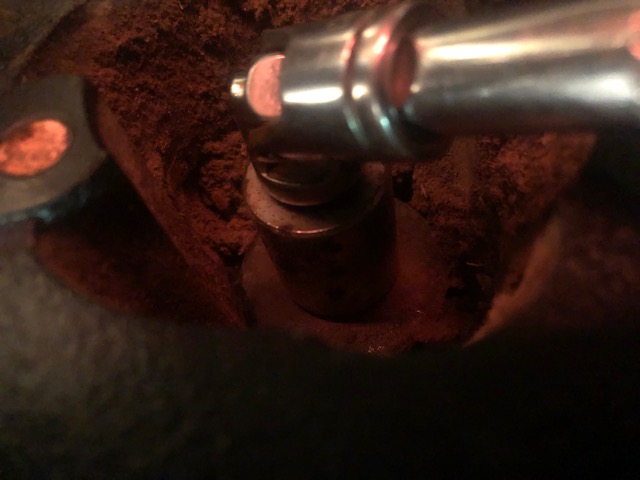

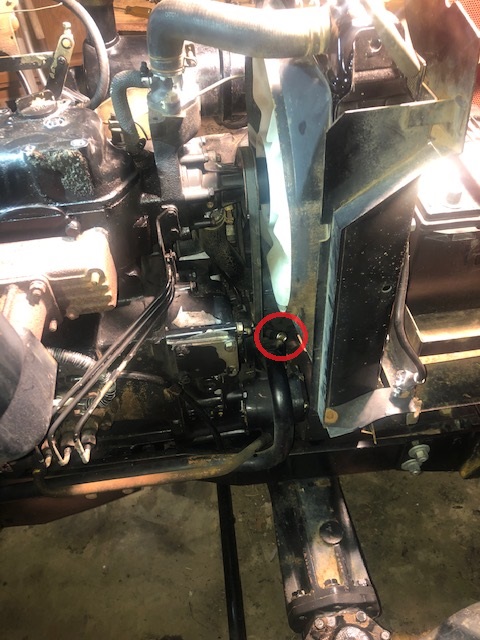

After working to gain access so I can turn over the engine, I can't help but thinking I'm doing something wrong. From what you all have posted, this shouldn't be as hard as I'm making it out to be, but I can barely get a socket on this nut and when I do, I can't move my strong arm at all.
From the pictures, can you tell if I'm in the right place? The red circle is where I can access the nut. The nut is way back and surrounded by everything.
Of course, it doesn't help that it looked like it would be a 17mm and I was too stupid to buy the whole set of deep wells since that would cost me $35 instead of $5 for just the 17mm.... when it turns out to be 19mm....I should have bought the set and saved the gas money and time. :confused3:

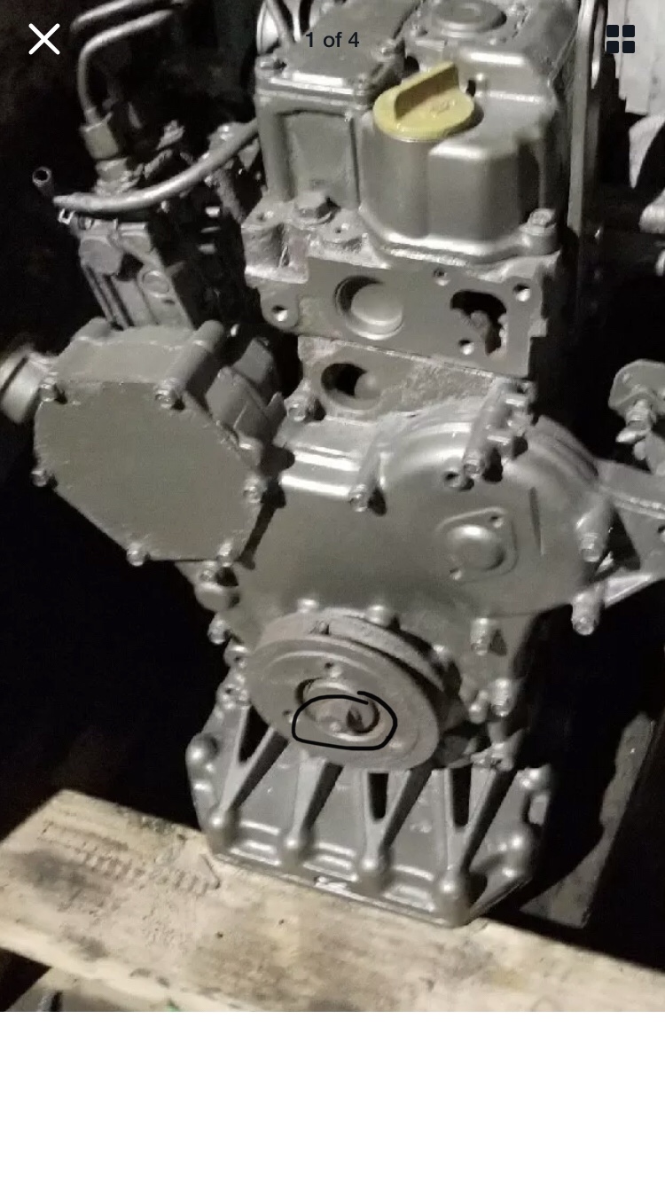

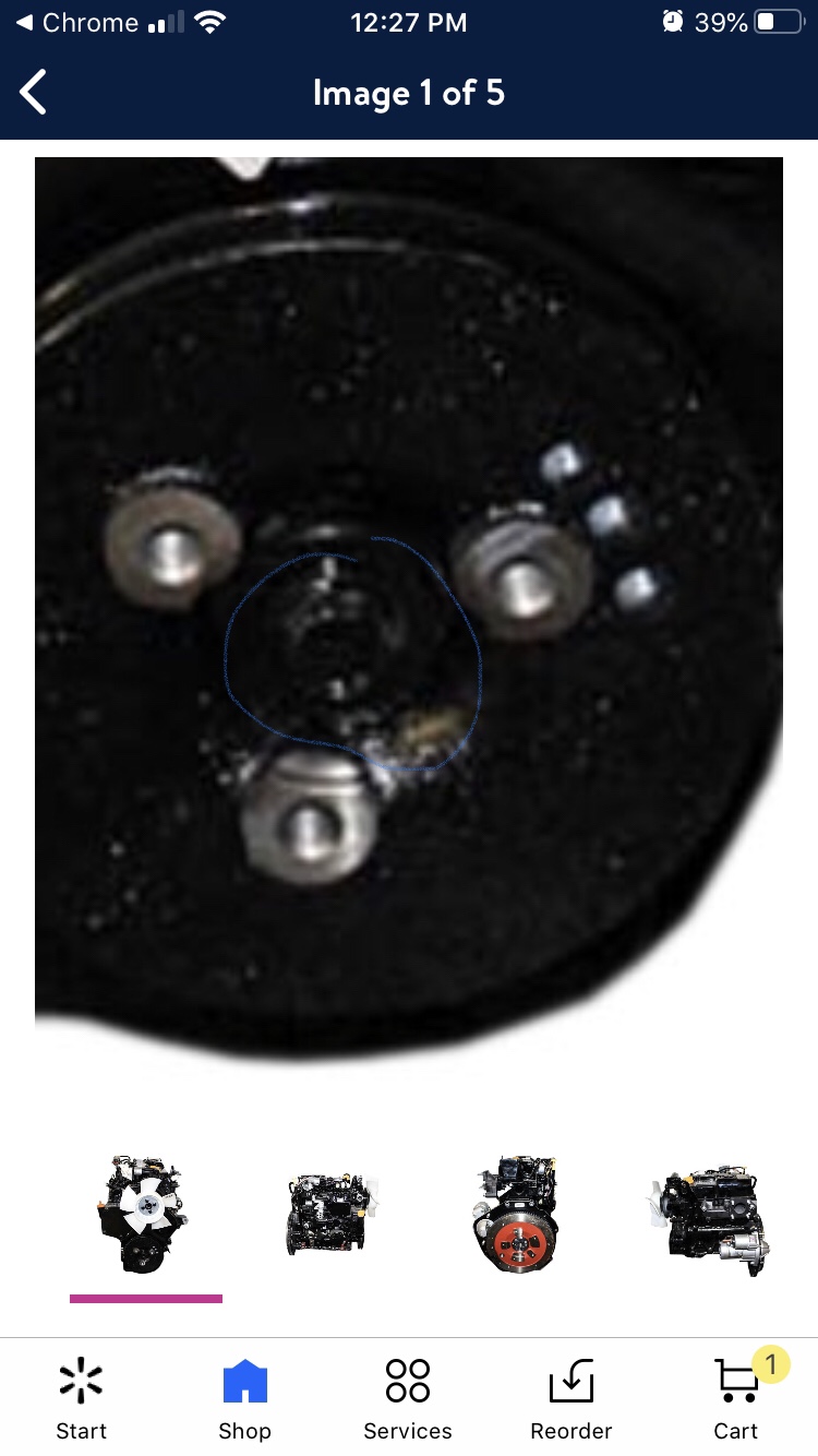

I can not see much from your photos on my phone, but I suspect you are not on the right spot. Your crank bolt that you need to turn the motor over with will be in the center of the lowest pulley on the front of the engine.
Deep well and extension have been recommended because it is a dish type of recessed bolt. Follow your belt(s) down till they start to go back upward then look for a bolt head recessed inside that pulley.
Not a terribly good photo but the very center is where you want to be.

Hi Munere, Not sure what that bolt is in the picture but to rotate the crank and therefore everything else the bolt will be as CoyPatton has shown in the center of the bottom pulley. Not that I'm trying to make a big tough job harder it doesn't look to me like there is sufficient space to do it without taking the rad out of the way, perhaps there is but just be careful of the rad and your knuckles!
View attachment 675148View attachment 675149
Always buy the set. You get to expand your tool collection.

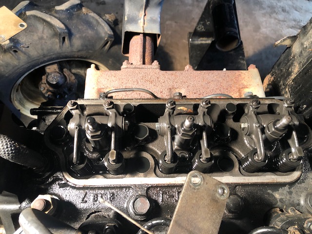

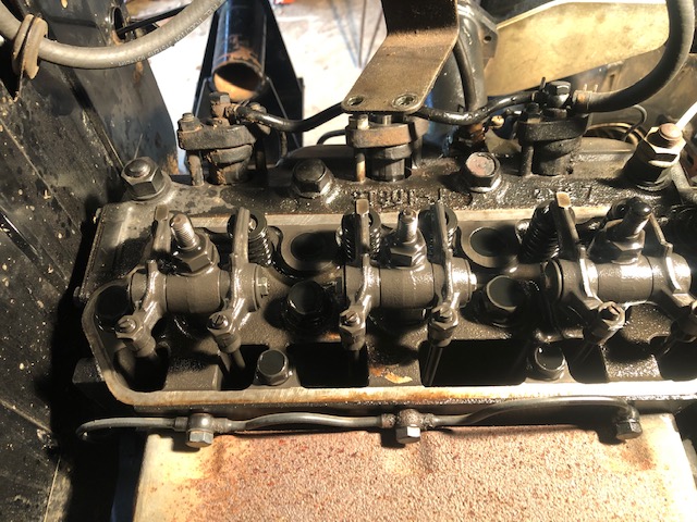

I was finally able to get a 19mm deep well on the nut and successfully turn the engine. Cylinder 1 valves check ok. Cylinder 2 exhaust valve moves ok, but intake doesn't do anything. So I thought I'd start by making sure the push rod was straight and.....I dropped the lock nut down into the push rod slot. I saw it in there, but moved the rod and now I don't see it in there. I'm going to work with a magnet to find it. Unfortunately, that stops my valve work because I don't want to turn the engine over until I get the nut out.
I even told myself, "don't drop this nut," as I took it off the intake valve.
I couldn't have gotten this far without all of your all's help.

Once you recover the nut, you need to get the motor so that it is in the compression or the power/fire stroke for that cylinder.
Reinstall the push rod and rocker arm but leave slack on the valve stem. Watch the push rods to determine when you are on one of those strokes. Them set your 0.006” gap. Now you can follow the Hoye link process yo get the correct placement of the cylinder piston to properly set the gap. It sounds as though you have only done 3 of the 6 valves to this point. Finish cylinder 2 then check cylinder 3. But it really sounds as though someone has played with valve or failed to tighten the rocker arm lock nut and vibration caused an issue.

Where did the nut fall? Just in the head by the rockers, you should see it.

it dropped down by the push rod (is that the rocker?). When I tried to grab it with a magnet, I pulled out the rod and hit the nut which dropped down another level. I'm guessing that leads to the cam shaft? I can't find a picture that shows all the nooks and crannies of the block, but it dropped a level below where the rod sits.
/ YM336D bad knocking engine #56
I can't really picture the size of the nut but it should be at the bottom of the "hole" probably sitting on the cam lobe. Unless it is very small I doubt it could fit through the gap beyond that. I do stuff like that all the time murnere. Take it slow and steady and with the right extending magnet it shouldn't be a problem to get it out of there. Good luck, buddy.
/ YM336D bad knocking engine #57
Unfortunately, it could be most anywhere in that cavity. While one would hope it would land in a readily accessible spot like the cam lobe ad described, it could (and in my reality probably did) bounce/roll most anywhere. If a bit of probing with a magnet, a flexible one would be better, then it might be time to borrow a bore scope or worse case buy one. The bore scope should allow you to locate where it is and retrieve it.
