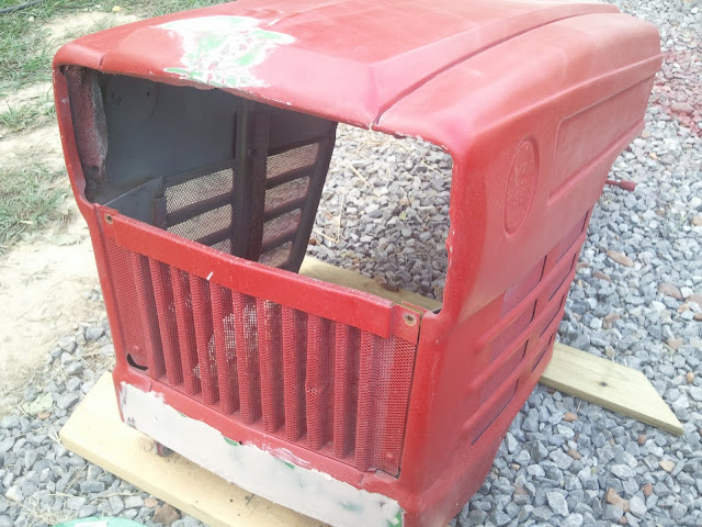

Big update today!
I am 99.5% finished the beautification and I must say.. you should really stop reading this crap and look at the pictures!. Where is a tractor parade when I need one?!
Without further ado.. the before and afters..
FROM:
TO:
And the during..
Here I test fit the gauges, which fit perfectly. The black really brings out the wood color.
After painting the entire tractor, including the engine, I threw on a full coat of clear which I happened to have hanging around from a cancelled boat restoration. Wait until you see the difference the clear made.. (I hope you can tell through photos)
The hood with a clearcoat
The dash is finally installed! This is right before I got down to the wiring, which took FOREVER. Man, added lighted gauges adds a TON of new wiring; The wiring was crazy enough with all of the missing switches and cut wires this tractor had.
