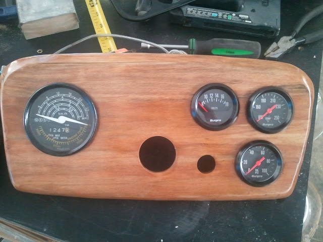

Here I test fit the gauges, which fit perfectly. The black really brings out the wood color.

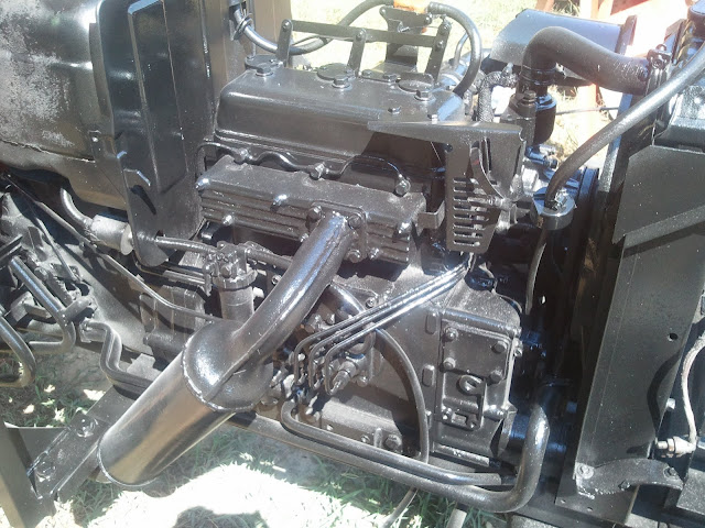

After painting the entire tractor, including the engine, I threw on a full coat of clear which I happened to have hanging around from a cancelled boat restoration. Wait until you see the difference the clear made.. (I hope you can tell through photos)

The dash is finally installed! This is right before I got down to the wiring, which took FOREVER. Man, added lighted gauges adds a TON of new wiring; The wiring was crazy enough with all of the missing switches and cut wires this tractor had.

The completed dash. Note the 1/off/2 toggle switch. Set to 1, the headlights only come on while the key is on. Set to 2 will bypass the switch, in case the tractor is off or I don't have the key handy. All switches are lighted, of course.
I moved the key switch to the bottom panel, as there is no reason for it to be always visible. It also seems more natural to turn the key where it is now.
Close up of the wood lights and trim.

Dash while the engine is running. I have a bit of an anti-freeze leak after removing the thermostat I need to seal up and a coat of paint on the steering wheel is still pending, but otherwise she's a done deal for now.
