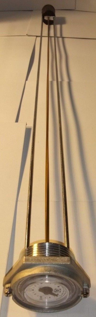

My 3 foot long Rochester Manual Fuel gauge was picked up for me yesterday, so my tank build should start shortly. Now that I say that, I realize I don't know if I can make the tank shorter on account of that spiral type fuel gauge. The gauge could go into the sump, but not sure if I want it sitting in water.

Tilt the bottom plate by 3/8", raise the screw in bung for the gauge 3/8"
Thats a nice reliable looking gauge, we have a similar one in the Farmall 400

Your fuel pickup should be an inch off the bottom of the tank which will allow draining water off before it ever reaches the drop tube even with a flat bottom tank. I’d put a drain on the bottom plate though.
Also, cut the end of the drop tube at a sharp angle so it can’t easily pickup rust scale from the bottom of the tank when it inevitably forms.
The best drop tube is steel tubing, drill out a compression fitting so the tubing will pass all the way through to the bottom of the tank. Infinitely adjustable and no hidden joint under the scully to let air in. Put another compression fitting on the top to adapt to pipe thread or better yet run a one piece tube all the way to the engine.
I’ve seen at least a dozen let air in at this joint and techs change out an entire fuel system trying to fix hunting or hard starting. And note that I did not say copper tube.

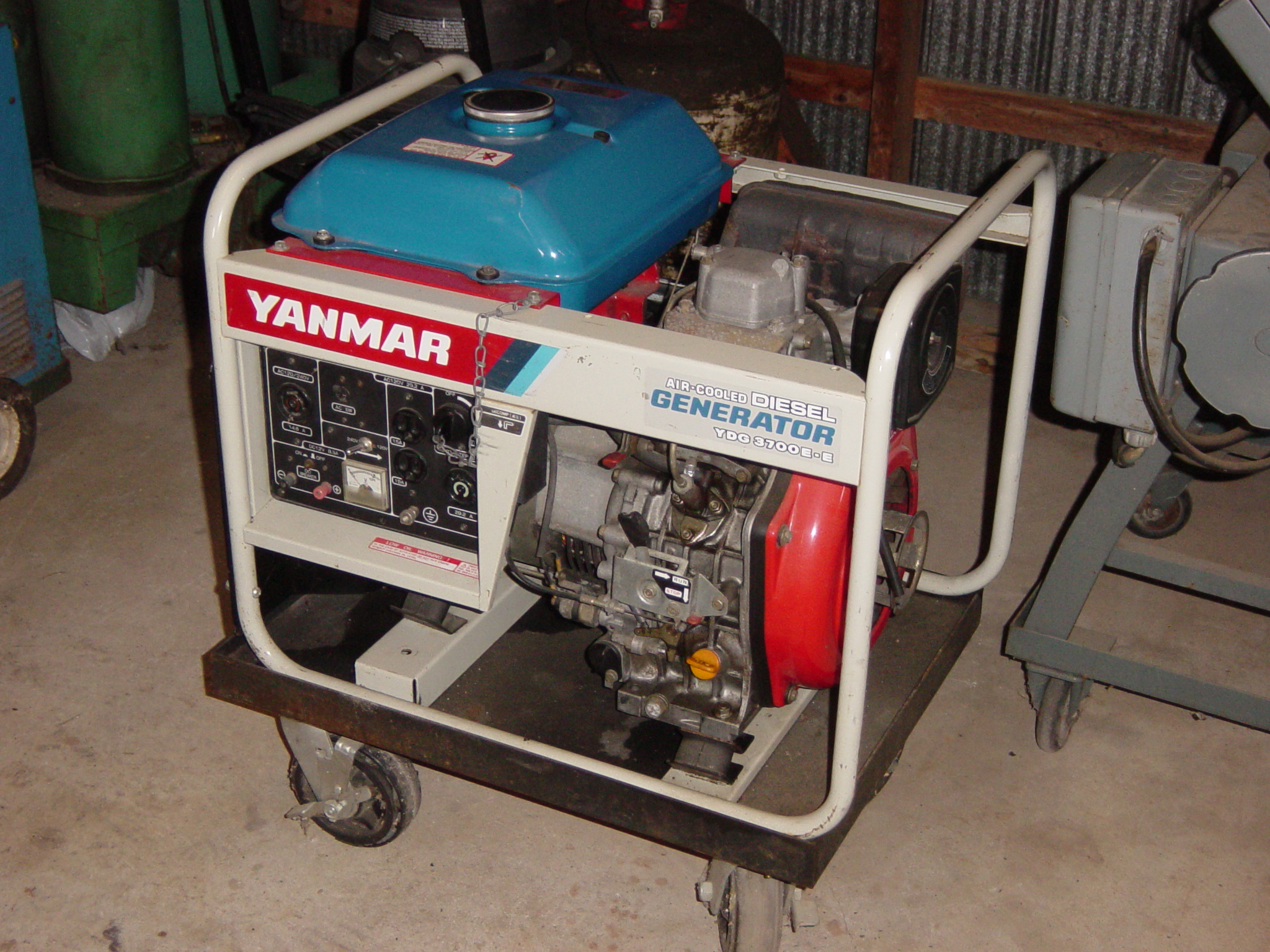

Today was my monthly test day. Ran it for an hour with a 42 amp load. All good!
