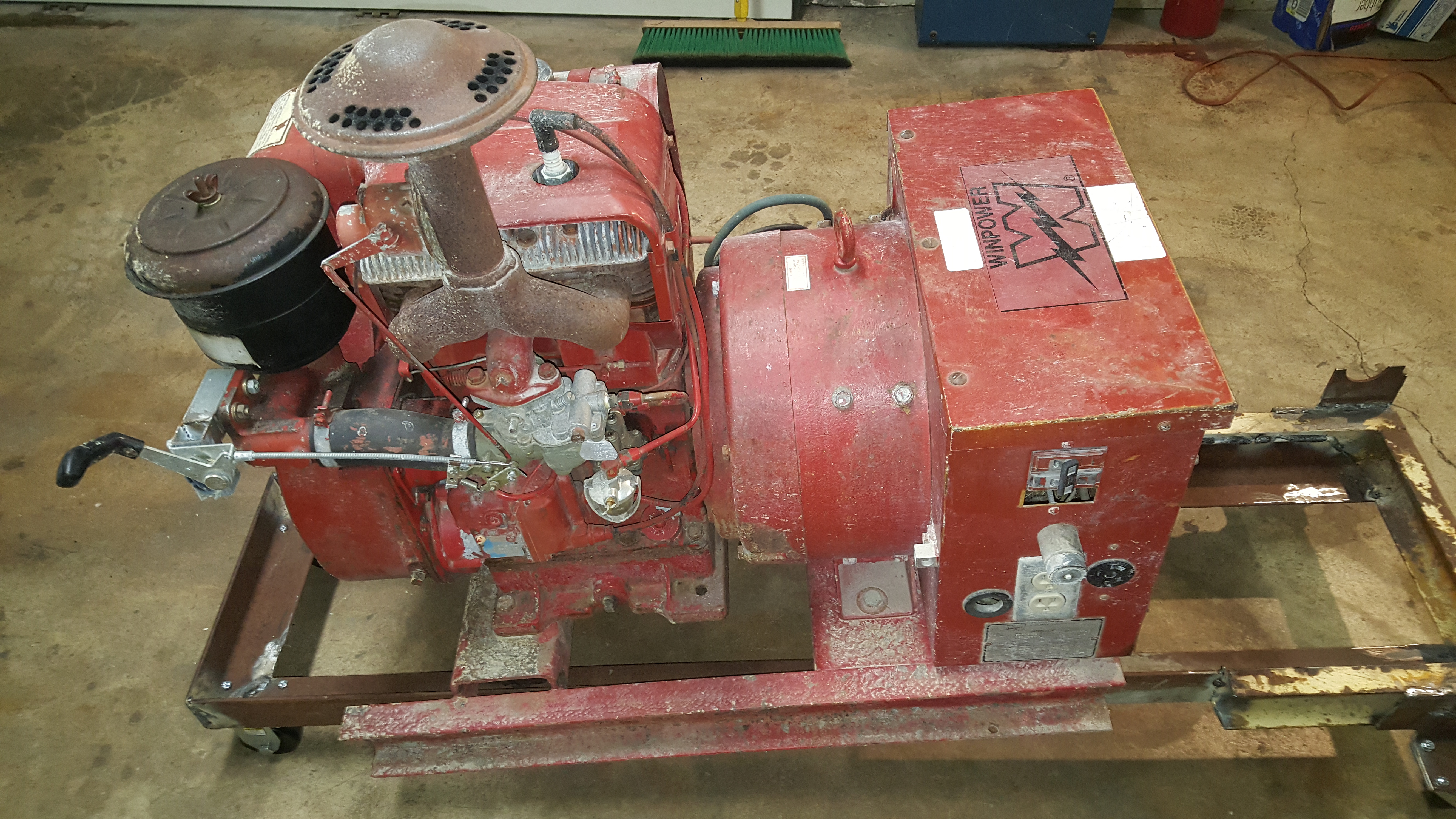

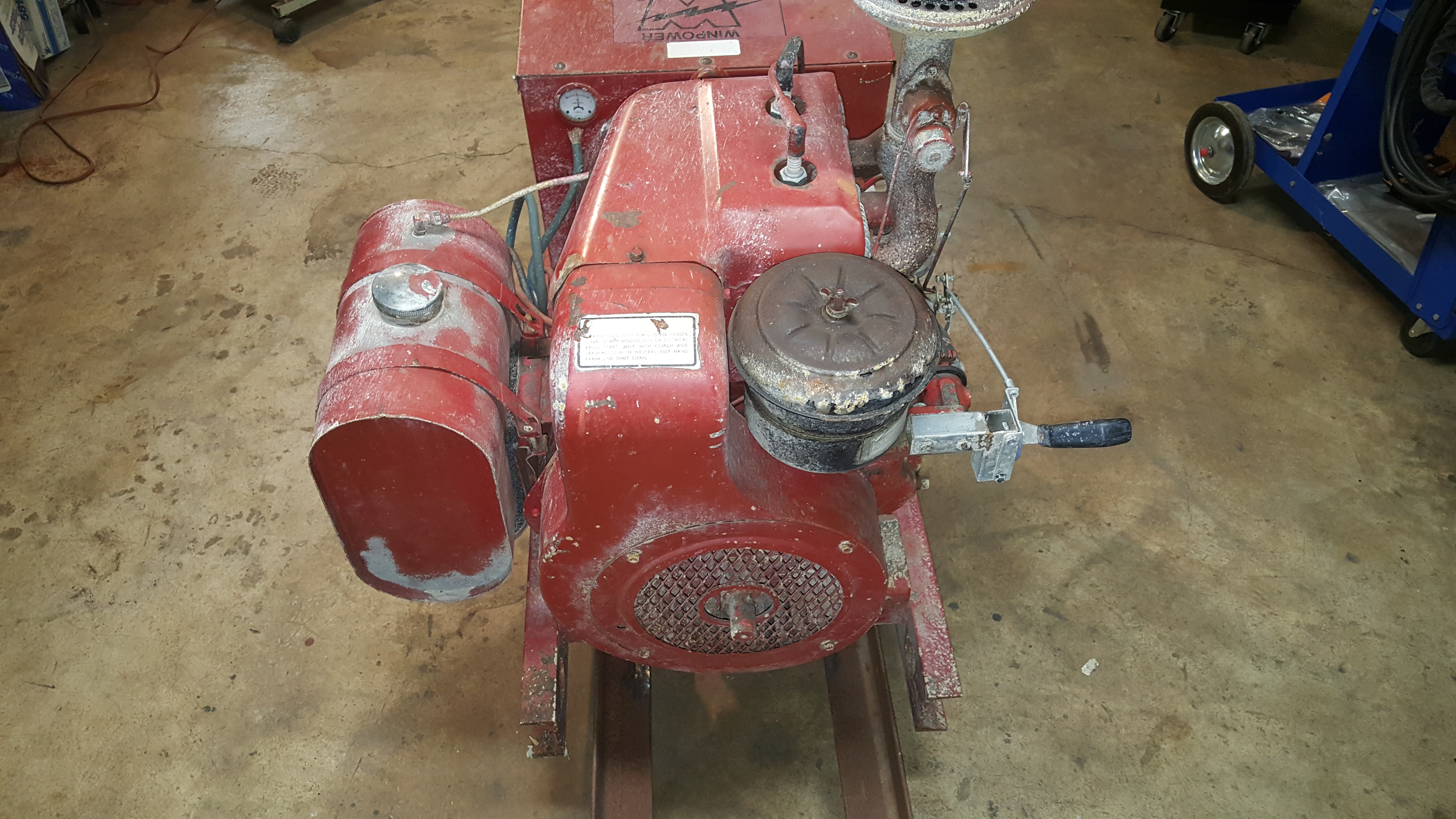

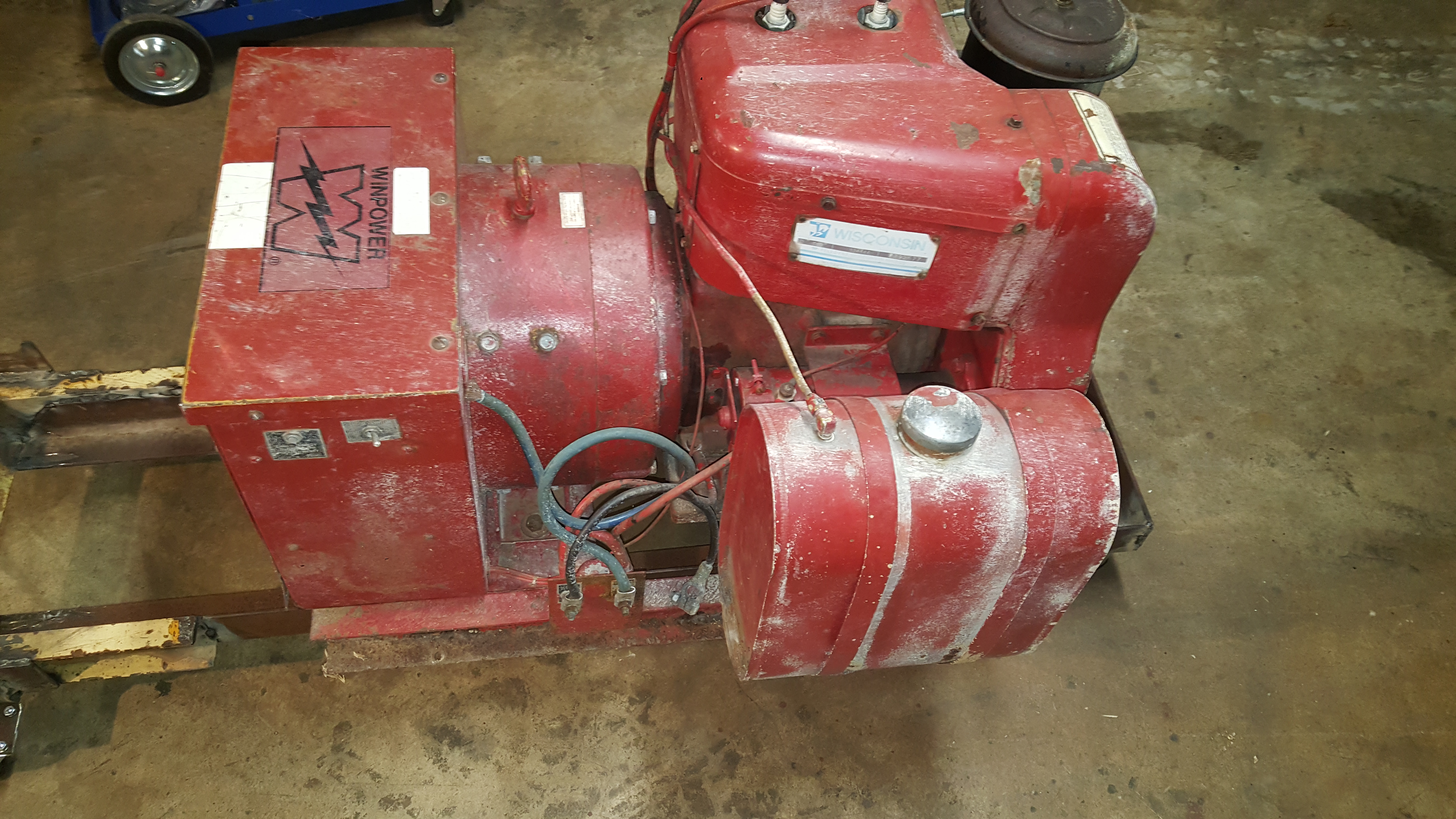

Just picked up an old Winco 6KW, made I think in the '80's, it's powered by a Wisconsin JTD 2 cylinder 18HP, spins at 1800, and sounds very strong. I am going through the gen-set electrics as it was made to be a stand-alone unit from what I can tell, with bonded neutral to ground and isolating the neutral is not an easy task, as the 12V system that primes the gen-set on startup is at ground, not neutral, but I added an isolation transformer on the self-excitation and a relay to temporarily bond neutral to ground on start-up for excitation initiation. Now, I have a floating neutral generator that can be docked to a residential 2-pole transfer switch where the common neutral to ground bonding occurs and adhere to code, but have the option to run standalone by inserting a bonding plug on the generator when non-docked locally grounded use is desired. In doing all this work, I then went to do a maintenance check run, and no output?? Well, the 30 year old breakers both failed, one 2-pole for the 240V side had one pole go open, and the single pole for the 120V convenience outlet on-board also failed, so am replacing both of those - finding NOS QC breakers turned out to be a challenge, but google located some. Lastly, I replaced the 3-pole 240V twist-lock with a 4-pole L14-30 so I can carry the neutral separately from ground when docked.
This thing is HEAVY, I estimate somewhere around 600# due to the heavy casting of that indestructable JTD engine, so I built a 4-castor dolly to set it on (the one in pic is borrowed one).
Bottom line to this story, I found it interesting in my research of just how many generators are sold and installed for docked use that are internally bonded such as mine, which creates a safety hazard (there's another thread here about bonding neutral in remote panels). Anyway, I'm now comfortable that I have a robust backup set that 'can' be used portable if desired. I've got some cosmetic work to do, and I'm going to see about a true 'muffler' as the exhaust is quite loud. I also kept all the remote start capability there, so this thing only requires flipping a single switch to start, all the start-up is automated (quite a feat in that era, it's simple relay switching).

EXCELLENT find, and thanks for the pics too.
Nice to see old-iron being brought back to life. You'll have all sorts of options avaiable, but one thing I've seen used successfully at low cost is something like a 600cc street-bike "take-off" muffler - if you want to stay vertical.
(Street racers will often buy a brand new bike then immediately yank off the stock muffler for replacement. Depending where you are geographically, there may be take-offs available cheaply online/local ).
Great recovery project, and pls post final pics later !
(P.S. - consider Stabil 360 protection for that metal tank, if you haven't seen it before.)
