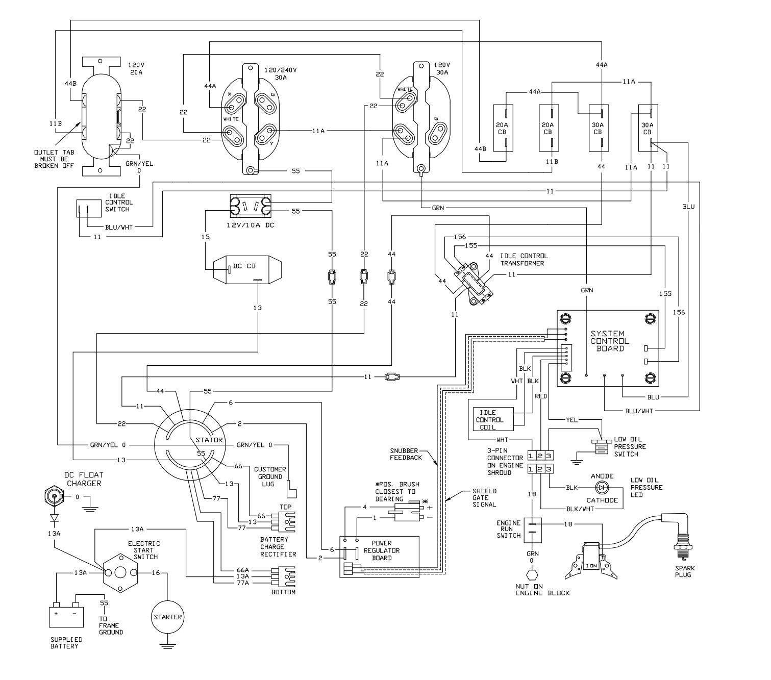

My Generac exl7000 just failed after 18 years :(
Having done monthly exercise at close to 50% load religiously, regular oil changes, and sheltered from weather, I am disappointed. It's putting out 170v on the 120v outlets and 340v on the 240v plug. Took out several surge protectors and an HVAC transformer.
I agree with the high load / low duty cycle comments about non commercial generators, which is why I got the 7k. Replaced with a Winco 15kw PTO generator, which now powers one complete panel.

Sounds like the voltage regulator has failed.
Aaron Z
Alas, no. That was my first thought and replacing it did not change anything. I didn't check the frequency, but the engine is running at the same speed it has always run at over the past 18 years. I should probably check the frequency though.
   / Your last generator Maintenance Run #3,750
Check for voltage at the AVR sensing terminals if it has separate power supply and sensing inputs. Sounds like the regulator is not seeing output voltage and trying to compensate.
I agree, if it's not the AVR, it's probably the sensing input to the AVR.
Thank you both (Aaron Z) for the info.
This is probably out of my league, but in the diagram below do I check for voltage on #2 and #6 wires?
Of note, I did find a bad crimp on one of those wires where it connects to the regulator. The connector was repaired though.

Yes, check 2&6. I would also check 1&4.
As I read the schematic, 2&6 are the sensing input to the AVR to tell it how many volts it's putting out.
1&4 are the AVR output to feed into the rotor (via the brushes) and control the voltage of the field that 2&6 are driven off of.
