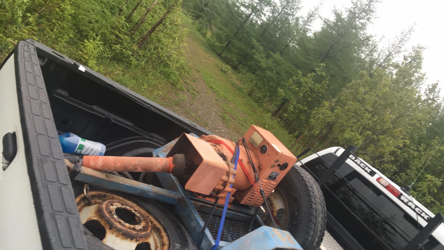

Ahhhh !! Generators, it seems we never have enough.... so I have a champion 3000/4000 bought 10 years ago, been reliable, but it was too loud when going camping.....
Few years ago I got a deal on a yamaha powered off brand 3000w generator, bought it to be the backup of the champion, barely ever used it, so it sits in my Dad garage he use it around his propery
So I kept the champion for around the house and bought a honda eu2000i for camping and hubting camp, so quiet.... I love it.
But last year I bought the wife a chevrolet bolt EV, and I use it to charge the battery bank on the rv at our fall boondocking spot, so quiet, no more need of a genset at the rv when I have my wife EV there.... but i did kept the honda eu2000 anyway, usefull, easy to cary, quiet, etc....
But, all these small genset where not big enough tu run my water pump for my well in a power outage.
So as I bought a tractor 3 years ago, I started to look for pto generator.
With the covid, most of the flight to northern canada have been cancelled so 2 weeks ago, I drove my pickup from home on the Gaspésie coast to Labrador City for my 2 weeks work rotation, and while I was up there I was talking generator with a coworker and he spoted a decent price pto generator in Matane, wich was on my way back, out of the dang Ferry ! So I talk with the seller, saying I wanted to test it. Got to his home and he had everything setup. We tested ( Some basic test, unloaded, at least I know it is producing 120/240)it with his tracor.
So short story, 2 days ago I added, for 850$, a trailer mounted 15kw pto generator to my generator collection. So now I really need to install a interlocking kit with a 60 amp male generator plug to my house.
Eventually, I want to try to charge my wife car with it, so I can have a fairly accurate kw/h usage and I could get a good idea of how many kw/h per gallon of fuel this setup is using. And even just for the heck of it figure the diesel mpg for my electric car.
And eventually, I will get me a 200 gallons fuel tank at home, for the tracor and Now and then I could fill my old duramax with it to have a decent fuel rotation in the tank as I don’t use the travtor more than 50-100 hours per year.
Ouffff another started project to add on the ongoing project listing....

Cool that you have a pto genny, I'm looking too. My concern with your diesel storage is that if you don't use enough it could get contaminated with moisture, algae etc. However, If you are going to use the same fuel in your Duramax, than you don't want to put coloured fuel in that big tank, as the fines for running off-road fuel on the hwy would be horrendous. I would just have several (5/6) good quality 20L gerry cans and use them up in order. Keep winter fuel separate in some other cans. That way every time you think that bad weather is coming you only need to fill up the last one or two that are empty... My 2cents, Dutchy

FIQ, good score, may it be reliable for you and should light it all up. I know running a tractor engine is not the most efficient per kw
but like the old drag cars, you run what you brung, and you have the tractor, which often needs some exercise anyway.
Nice addition to your power options Fi. A healthy used PTO unit offers lots of watts vs. $, and a properly managed cache of diesel gives you a great buffer for a long outage :thumbsup:.
Somebody 1 year+ back (can't remember name......) made an extensive post about managing large quantities of diesel. Water has always been an issue, but even more so now with ULSD.
A couple of ounces of prevention :thumbsup:.......
Rgds, D.
