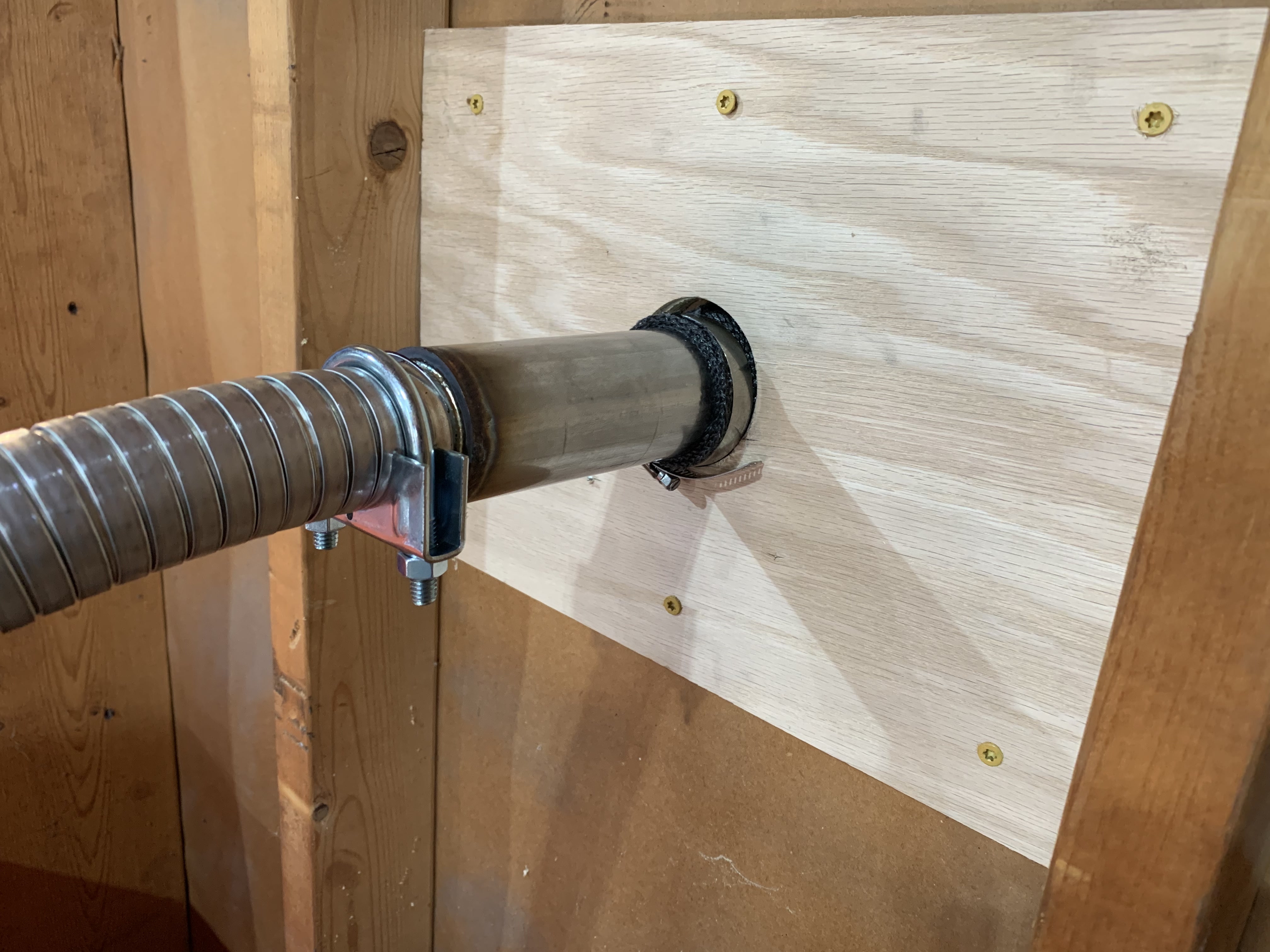

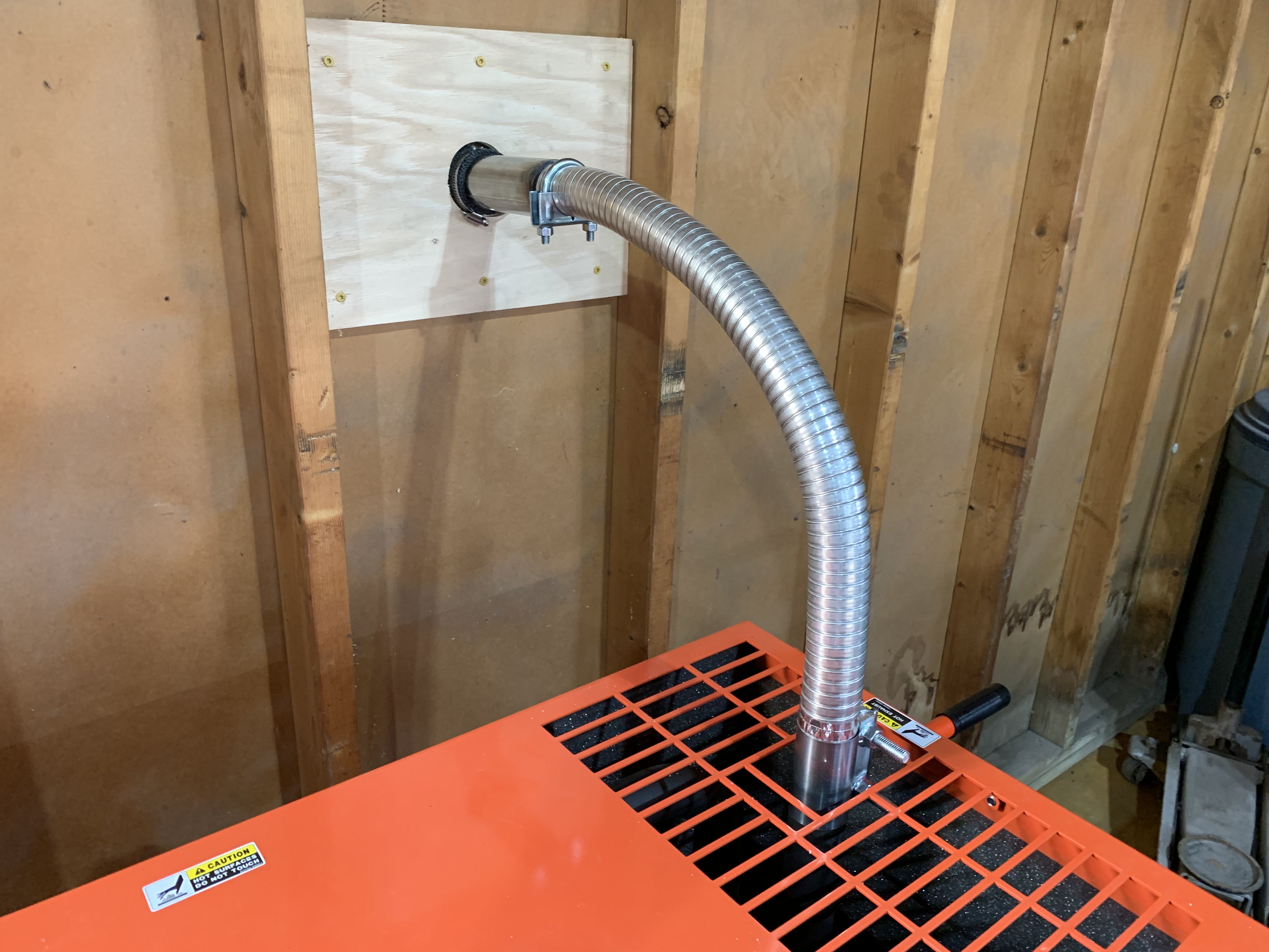

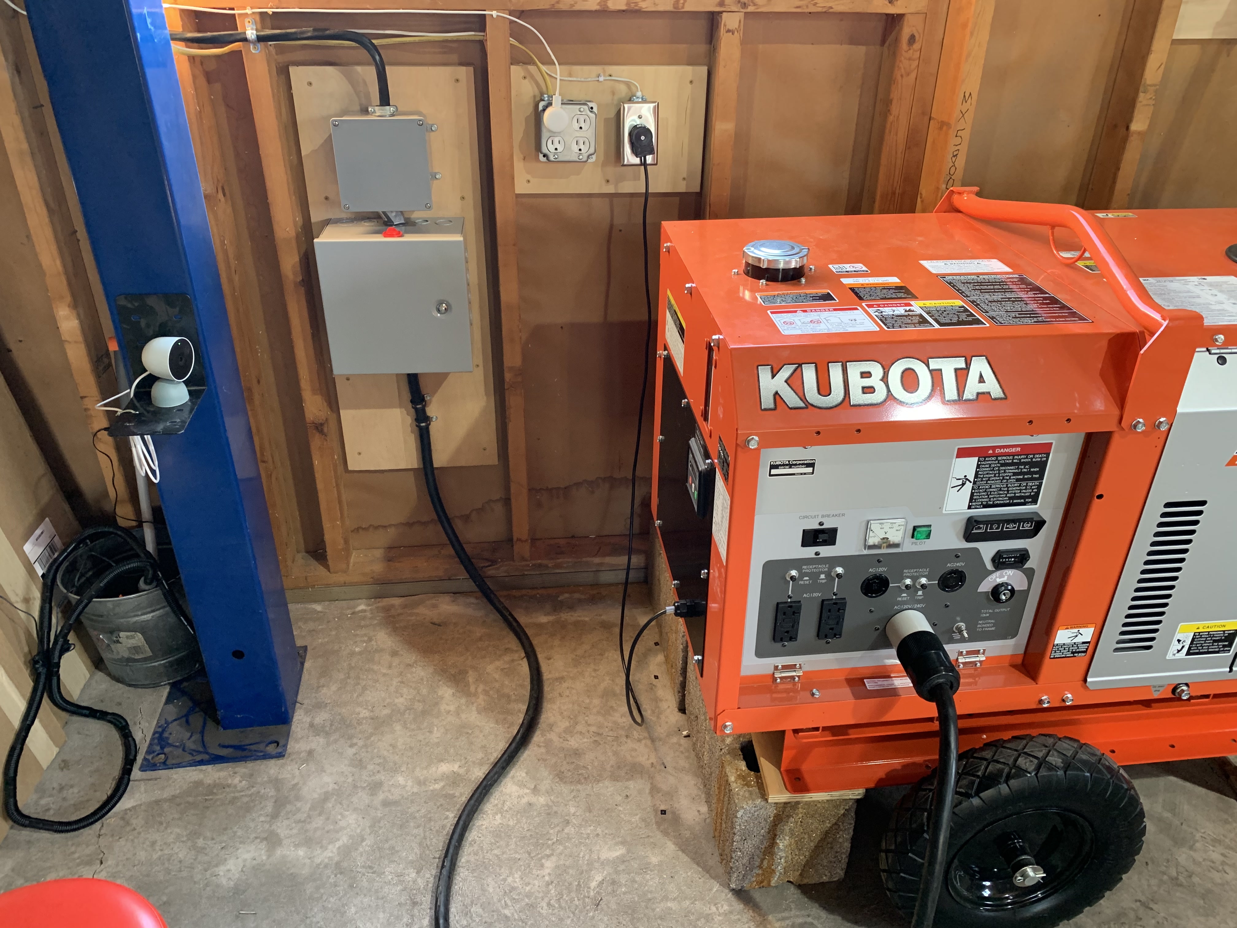

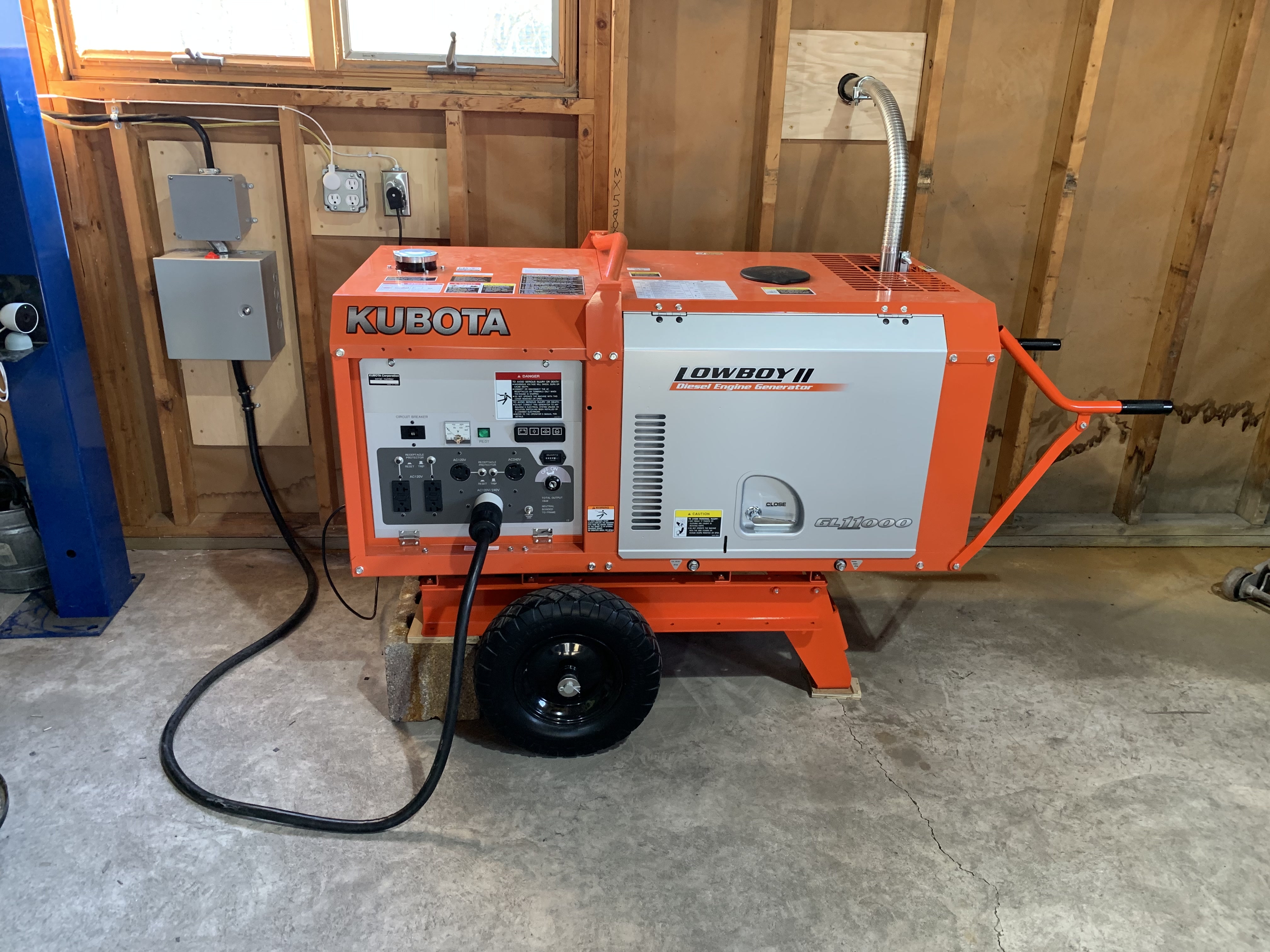

Finally finished my home backup generator project. It took longer than I estimated and I was getting a bit nervous. I sold my PTO generator a few weeks ago and power outage "season" is approaching.
It's a Kubota GL11000, 11 KW unit which I put in an unused space in the rear of the barn. It's up on blocks but I ordered the wheel kit in case it needs to be moved.
It's controlled from the house and monitored with cameras that I added to my security system. Rather than use an auto transfer switch, I elected to control it manually so I can set my own warm up and cool down times.
View attachment 1789811 View attachment 1789874

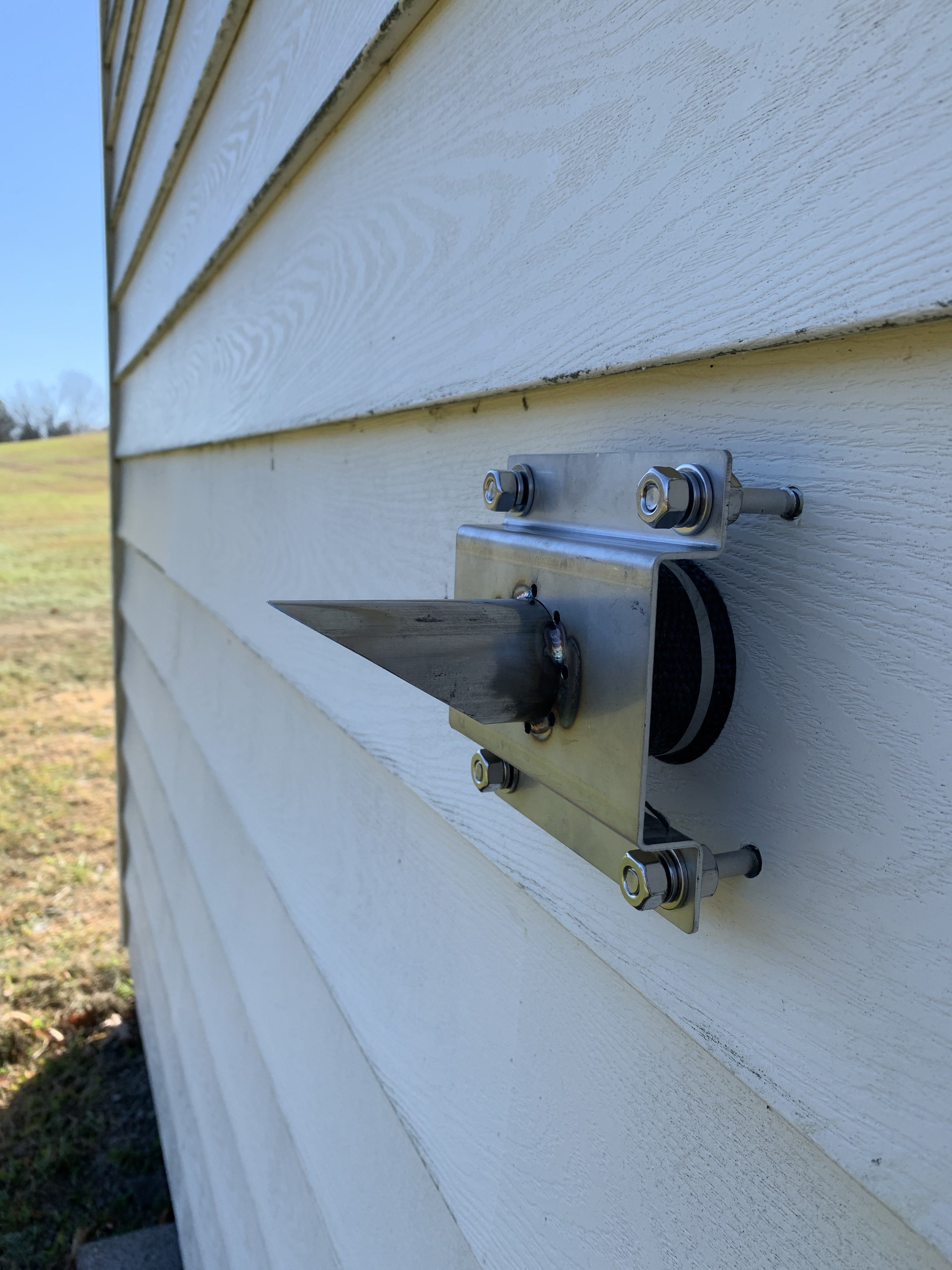

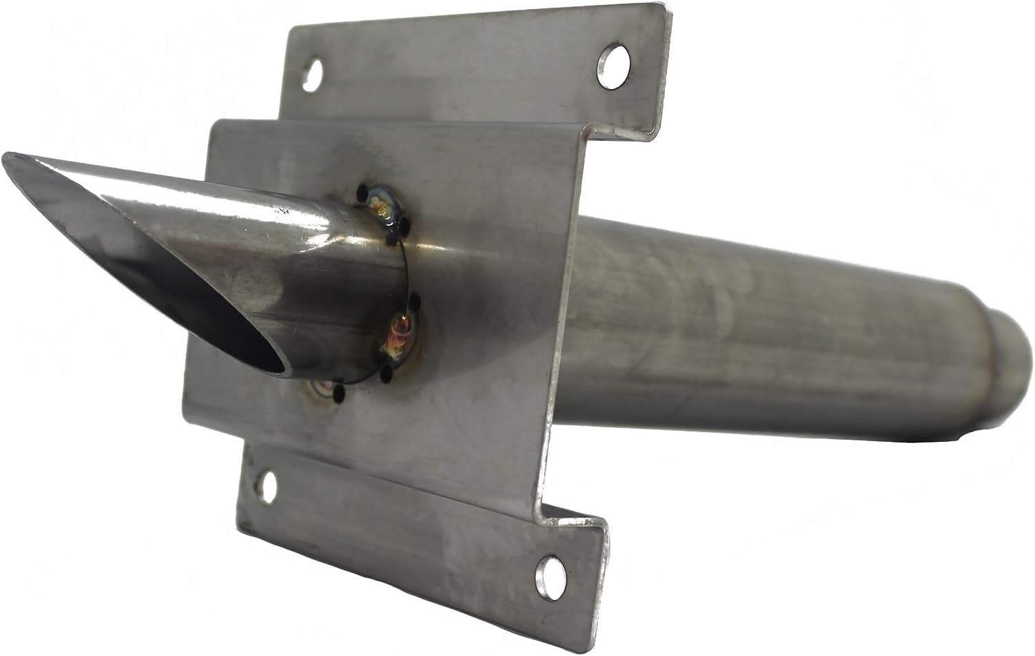

The trickiest part was the exhaust system. I needed something that would vent outside without melting the vinyl siding or burning the place down.
I found this product that works perfectly:
It's double wall, stainless steel design minimizes it's outer temperature. I used stainless bolts to offset the mounting flange from the siding and filled the space around the outer shell with muffler wrap.
View attachment 1789975 View attachment 1790011 View attachment 1790040
I'm still thinking about a block heater or some other prewarm method. I'll probably wait and see how it starts on cold days. The barn isn't heated but it does buffer the outside temps considerably. My tractors always start in the building, even on the coldest mornings, so I'm hoping the genny will too.
The only thing left to do is come up with a way to fuel it. It only has a 7.4 gal tank, which will provide 13 hours of run time at 1/4 load, or 7 hours at full load. I fuel my tractors from my fuel oil storage tanks in the house. The generator is stationary, so I'm looking at a caddy to transport fuel to the barn. More to follow.
Nice clean install, and beautiful Kub ! Thanks for posting the pics (y). Good to see you are operational, before the "Season" hits.
IR Temp gun checks (likely already done), and maybe a loud/remote monitor smoke detector may be on your Xmas list.
One option (my Dad built his own, many years ago on a furnace vent-pipe) may be to add essentially heat-sink material (think finned sheet metal) to the flex, before it hits that dual wall - needs to be observed closely during testing, as more heat will radiate off the flex.
Rgds, D.

Good idea on the heat sink for the flex pipe, I'll look into it.
It can't be seen in the pics, but the engine radiator fan blows cooling air upwards out of the housing around the flex pipe. Yes, it's warm air, but it is still much cooler than the pipe, and will certainly have some cooling effect.
Yes, I did check the temps with an infra red thermometer. After an hour, the wood and vinyl siding adjacent to the pipe were just 2 degrees F above ambient. I'll check it again on a hot day to be sure.
Thanks for the tip.
Thanks for the tip.
Your #'s sound great (y)
Belt+suspenders may look goofy, but is not a bad thing.... On Things That Matter...... :cool:
Let us know what you move to for more fuel capacity, on this very clean installation.
