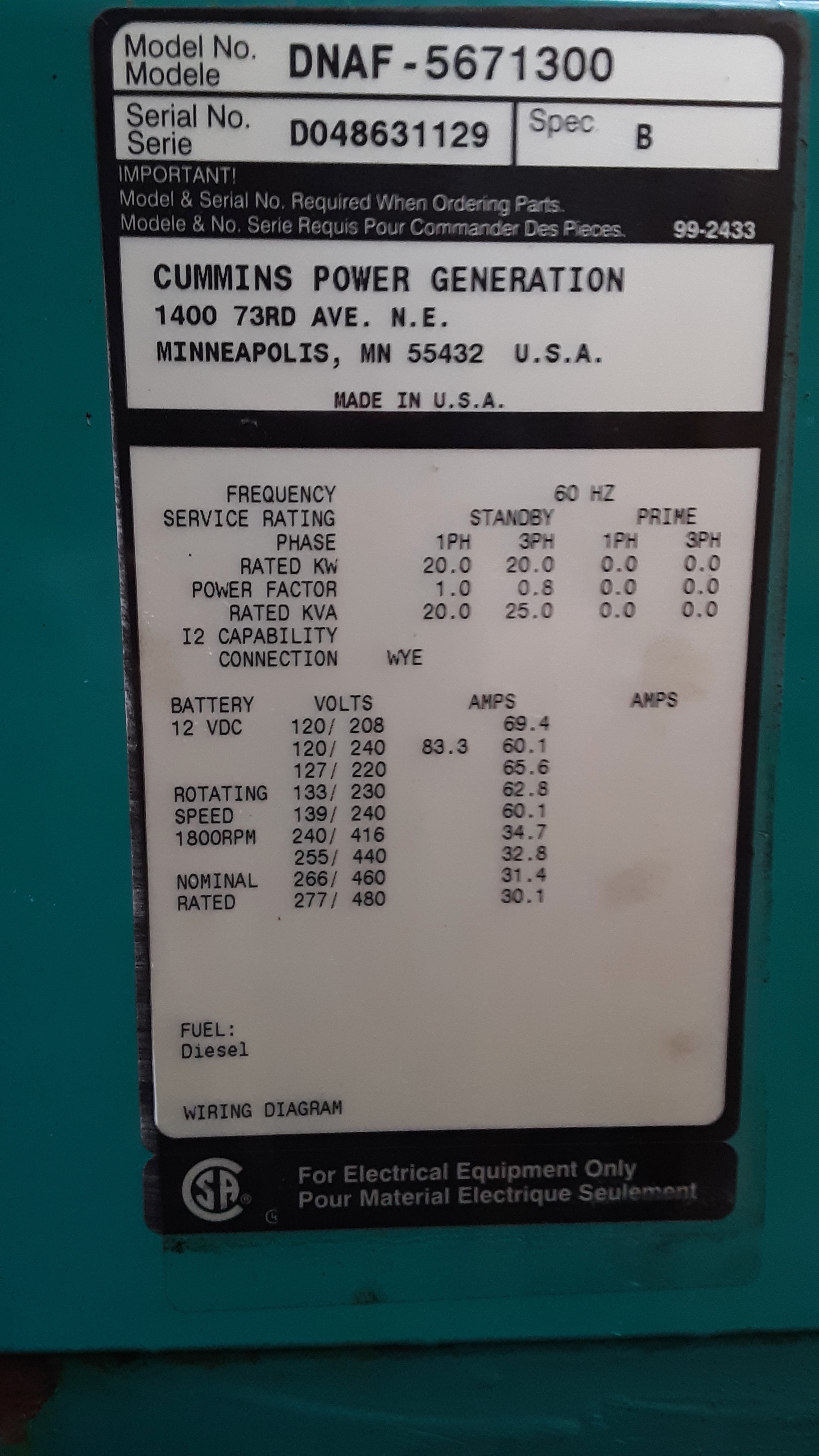

I'm going to need a water pump for my 20kw onan diesel. Chilliwack Murphy sent me something that I - 1 cant find, and 2 don't remember if it was a parts list.
Is this something that I can find avoiding a dealer? It's just dripping a very little, I'm guessing that after sitting for ?? (prior to my purchase) and my usage has aggravated a dried out seal.
FWIW here's the info.
Eventually I'll ask about the type of anti freeze, and after my electrician put's his meter on it to measure the "cycle", (remember the microwave and range clocks being off?)
   / Your last generator Maintenance Run #5,110
Are you ready to mortgage the house? Best find the pump from the Engine Manufacturer. Or take it apart and put a bearing /seal in.
