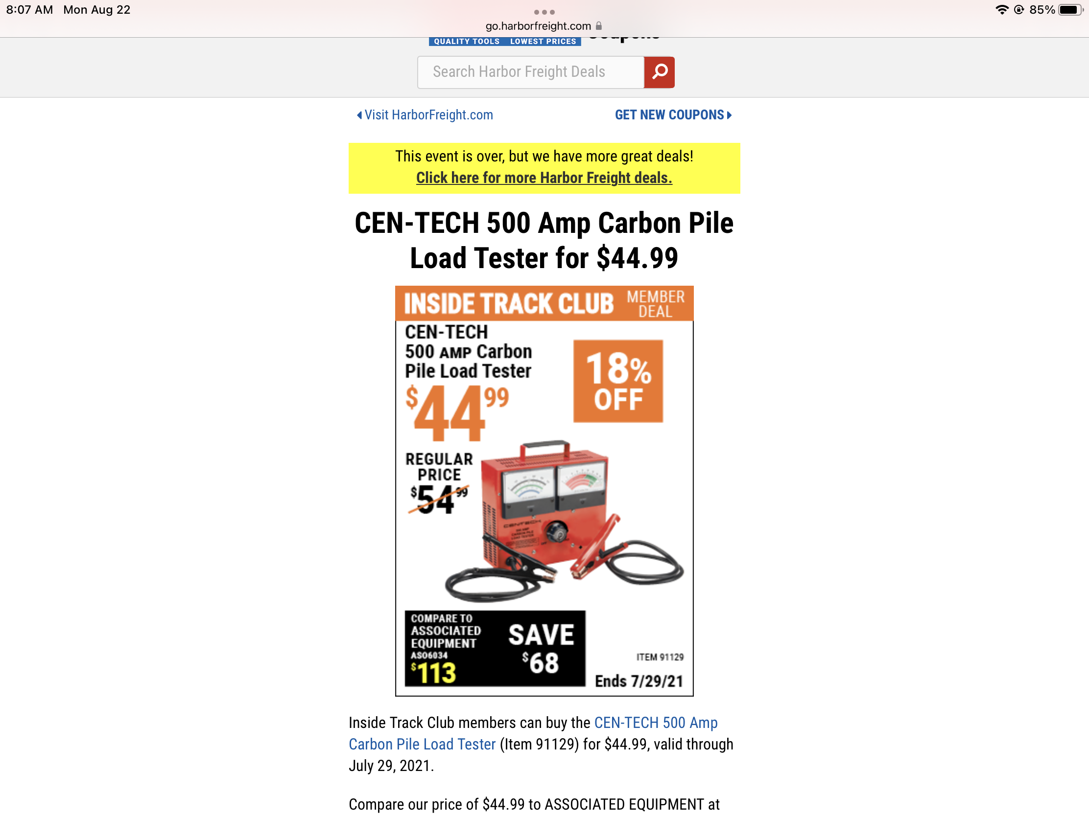

recommendations on an inexpensive battery load tester?

For a small generator the 100 amp tester is likely fine, if I'm going to have one around it will be a 500 amp to get a better test on a battery especially if it should have more then 250 CCA. They do cost more, but.
   / Your last generator Maintenance Run #5,830
A standby gen usually has a minimum of 550 CCA battery, and you need to load a battery at least 50% to test. I have one of these chepo testers that i use to take the fake peak load off of a charged battery
works pretty good at seeing general health of a battery, but wont find dead cells. For that i need to use my midtronics tester, but those are not cheap by any means. But for a general go to tester, i like the harbor freight one. I also had a 100amp tester like shown above when i first started out, but it passed too many bad batteries. I was told by exide tech that its because it didnt place enough of a dead load on the larger battery.
as a test, he took a known bad battery and it passed test on the 100 amp carbon pyle tester, and just failed on my 500 amp tester at 50%. When i tested it with my midtronics unit, it showed it only had about 100 amps CCA Available.
