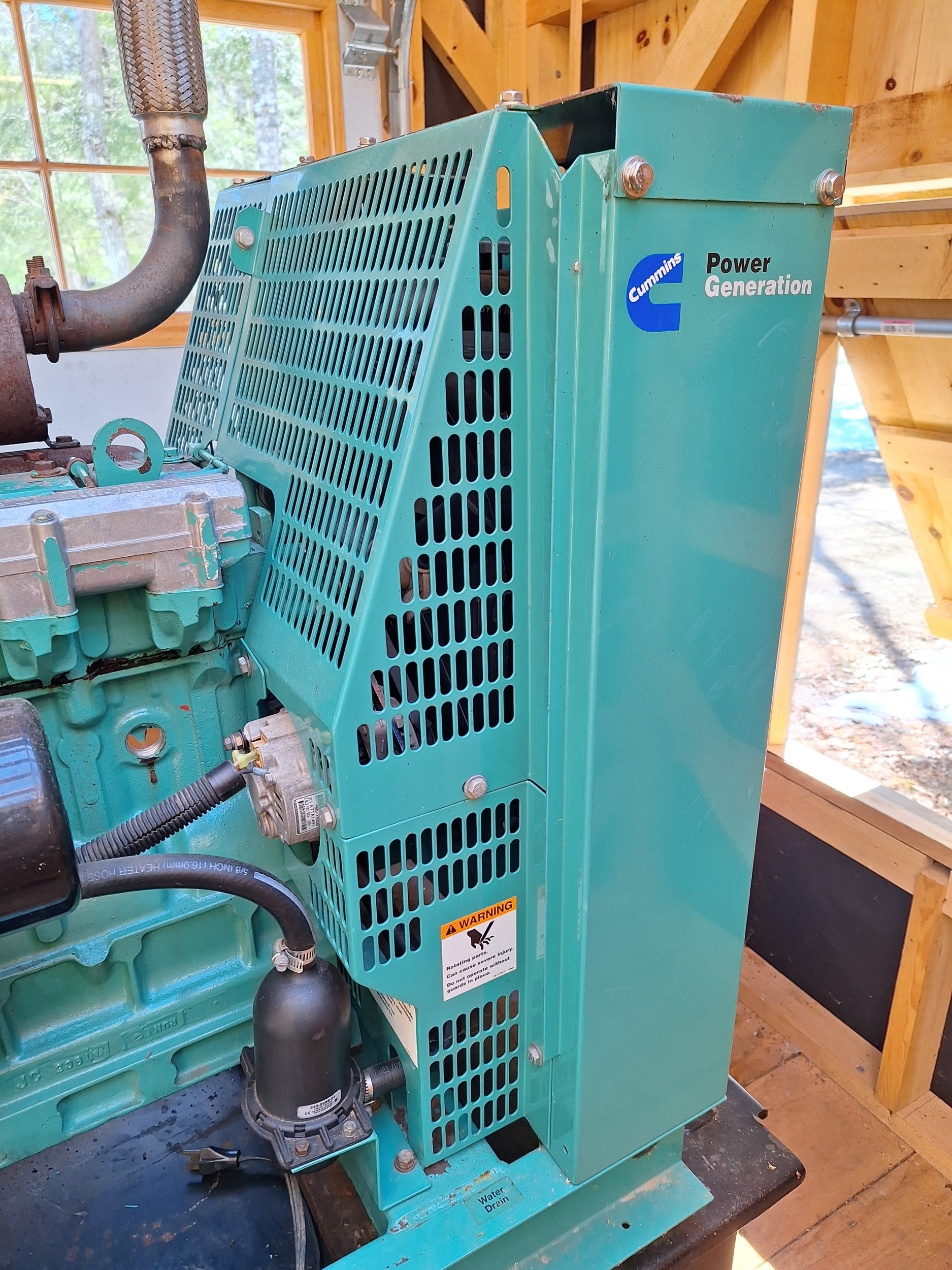

I definitely have the fuels "health" constantly lingering in my thoughts. I treat with a biocide and the normal anti gell, certain boosters. So far, so good. I am (strangely) eager to refill with fresh fuel.
At the end of this last run I heard a odd noise that seems to be the frequency and sound of a belt. The only one is the fan/alternator. I'll get that replaced and verify.
Early on with this unit water appeared under the fan/water pump. Just a little bit that stopped on its own. Being optimistic I hoped that it was a dry seal. Someone along this journey told me that the Cummins generators had proprietary (expensive) parts that only were available from a dealership. I haven't researched this or the price yet but I'm going to.
With all the guarding, even a simple belt replacement gives a modern car equivalency in terms of convenience. 😆
I bought this unit with 1060hrs. now it's got 1365.1.
The little "dog house" project that I finished up the last outage with. Just to stretch its legs.
6500w little Kubota diesel a little bit short on juice I think, and the 20k is a little big but it seems without consequence. At least that's what I'm going with. 😆
