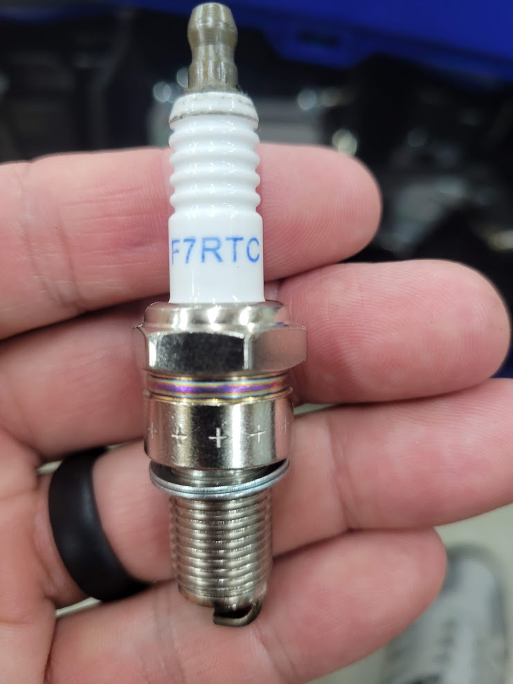

Haven't looked up your gen yet.... guessing from the "i" - perhaps it's Injected ? If so, the resistor plug may be to avoid interfering with the computer.....
Rgds, D.

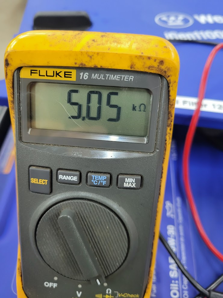

nah, it has a carb. I think the "i' is two fold, people think anything with an 'i' is cool, and it's also an inverter generator, and I think that's really what it's for.
And it's odd, that it lists the plug as a resistor type. F7RTC with also crosses to other resistor types.

yeah, definitely a resistor plug installed. The manual contradicts itself. Specifically lists (and has installed) a resistor spark plug part number, while also saying not to use a resistor plug.
I emailed the company, last time it took them several weeks to reply.

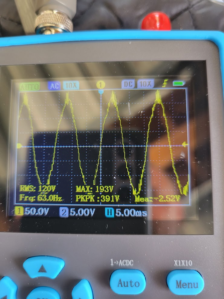

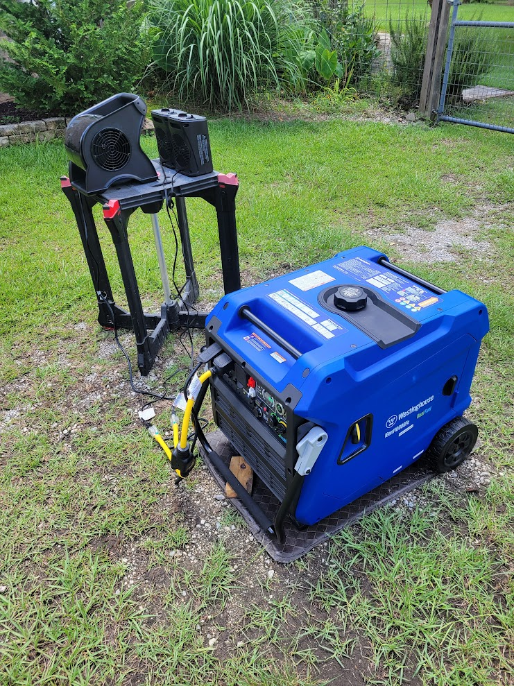

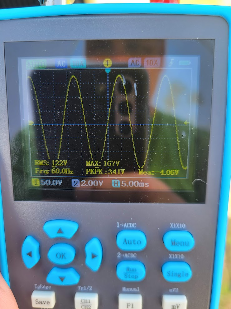

Good news is that it is running like a champ. I put an oscope on it, nice clean stable power. After about a half hour I put just under 4kw load on it. Says keep it under 1/2 rated load for the first 5 hours. It's an 11000/9000 rated unit. Nice an quiet too. So far I like it.
Cheap little load bank, I split the 30a 240 into (2) 120 legs, and have a 500/1000/1500w heater on each leg along with a fan to keep them cool/running (it's almost 100f out)
After the 5 hour break in, I'll split the 50a circuit and add 2 more 1500w heaters and fan, so up around 8kw then whatever else I want to test with.
this is with 3.8kw on it.

Excellent (product, and 411 that you are posting). I don't think we've seen that Inverter line before here....
I'm envious of your instrumentation - what is the Make/Model of your Scope ?

Just a cheapie scope, all I need these days lol

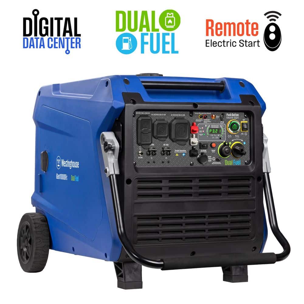

That igen 11000 is new this year, I've been wanting a large inverter for a while, was finally announced but not onshore or in stock for several months. It arrived last night.
I think HomeDepot is about the only place with them at the very moment.
During the last big hurricane here where we had no power for a week, one of my freezers and none of my UPS' liked my conventional generator. I have a sewage grinder pump that needs a good bit of power to start, that's the reason for the large generator. All the hot shower water does me no good if I can't get rid of it.
The generator has a locking handle, but it vibrates and is louder than the motor, that's the reason for the block of wood under it lol It vibrates in both the up and down position.
**Old conventional generator was noisy
I should explain that comment. Yes there are other 10k inverters on the market and they have 50a sockets, but none I came across could actually provide the full rated power through that 50a socket.
This new Westinghouse igen11000 is the only one I have found where Customer Service assures me (2 phone calls to different people and also an email from a 3rd) that it will provide the rated output through the 50a socket.
Here is an example from a review I left on a different generator.
Amazon.com Customer service is lacking and it took a while and several back and fourths to get the actual info, but you can not use the L14-50 socket to get the full 10000/8000 watt output, you have to use a combination of multiple sockets. The L14-50 Receptacle is LIMITED to 120 Volt output up to 50amps and 240 Volt output up to 30
amps. That is ONLY 6000w at 120v and 7200w at 240v, a far cry from the rated output, and that is max, not running! If you want to use a single output cable, this is a poor generator and can not supply the rated output. Understandable for 120v, unforgivable for 240v: deal breaker.
If you are wanting to use a 50a cable to hook into your house, make sure the generator will actually provide it's full rated power through that single port, most (inverter generators at least) do not, you'd need to use multiple sockets/cables to achieve that full rated output power. Buy a 10k generator but only get 7.2k, and you'd never really know Crazy!

If I remember correctly many many years ago the resistor plugs were
installed in vehicles to stop the inter interfence of all the static in the
car radio and I do believe they would also interfear with the computer
because of the wide band frequency that the plugs emit
