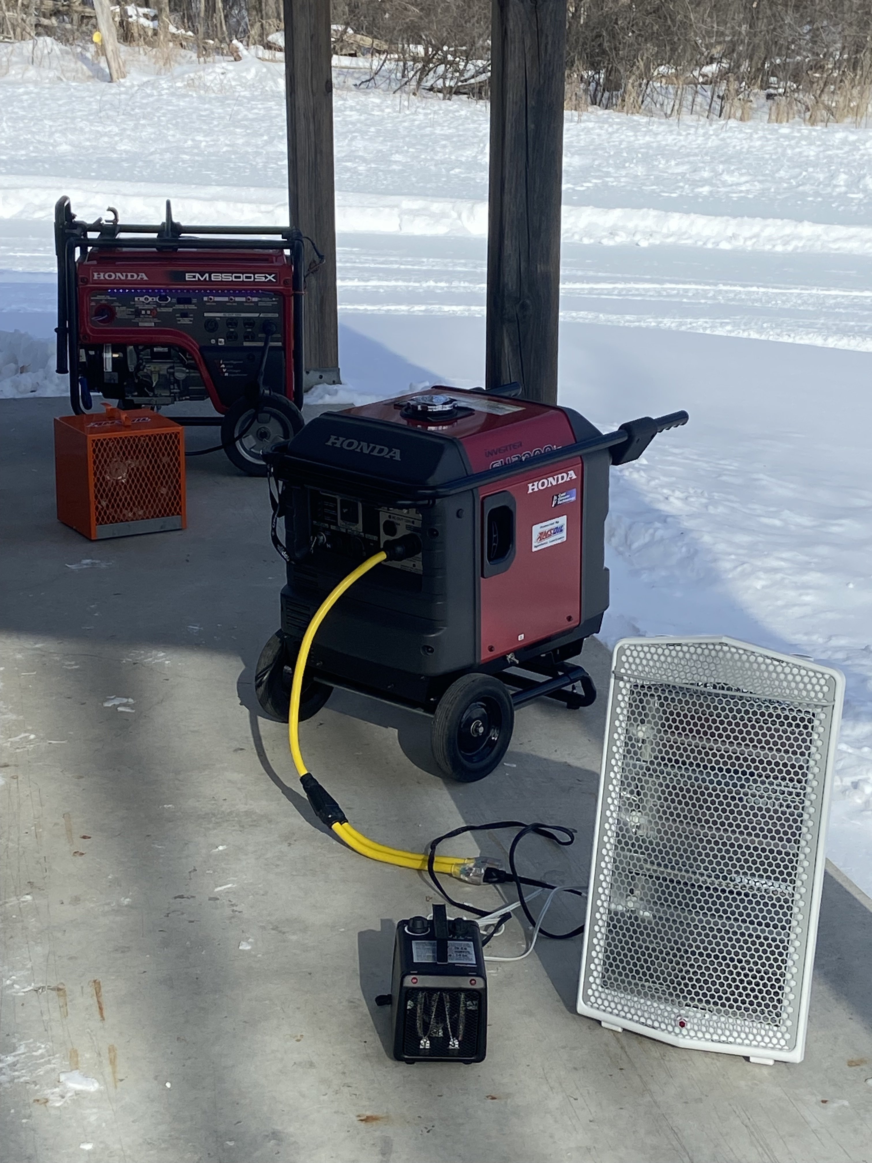

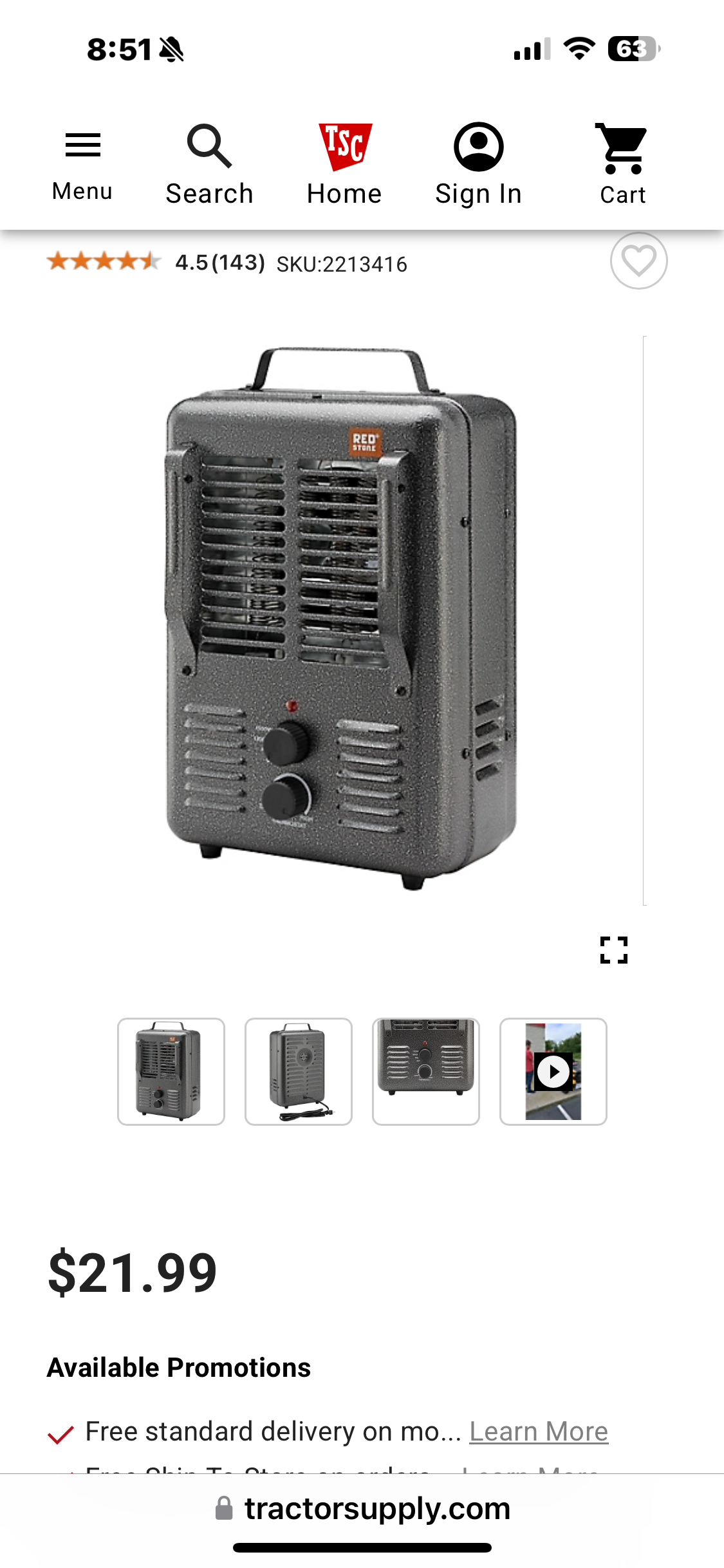

Building a load bank is relatively easy and affordable. I use portable space heaters for my testing.
They are typically 1400 watts and inexpensive when you consider the consequences of not loading a generator properly.
I have 3 similar to this and 1 with three heat elements of 2.5kw each. Combined load is over 11kw.
