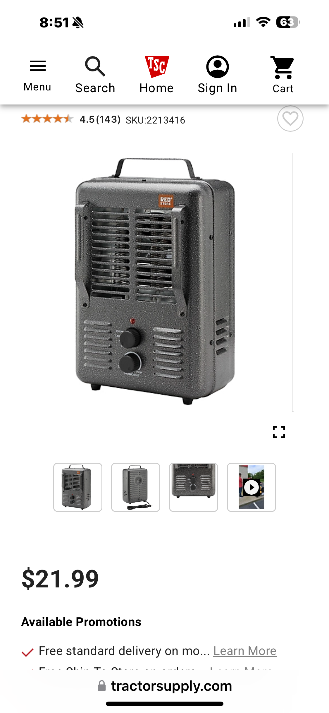

Building a load bank is relatively easy and affordable. I use portable space heaters for my testing.
They are typically 1400 watts and inexpensive when you consider the consequences of not loading a generator properly.
I have 3 similar to this and 1 with three heat elements of 2.5kw each. Combined load is over 11kw.
Inexpensive, and effective loads.... aside from their normal uses !
Def overkill, but I'm thinking of whoever on here that had that gorgeous MilSurp load bank.... does the same job, but the control-panel alone sticks in my mind, the same way big classic HF radio front-panels do....
I probably need professional help ^ :cool: , but there are worse obsessions.....
