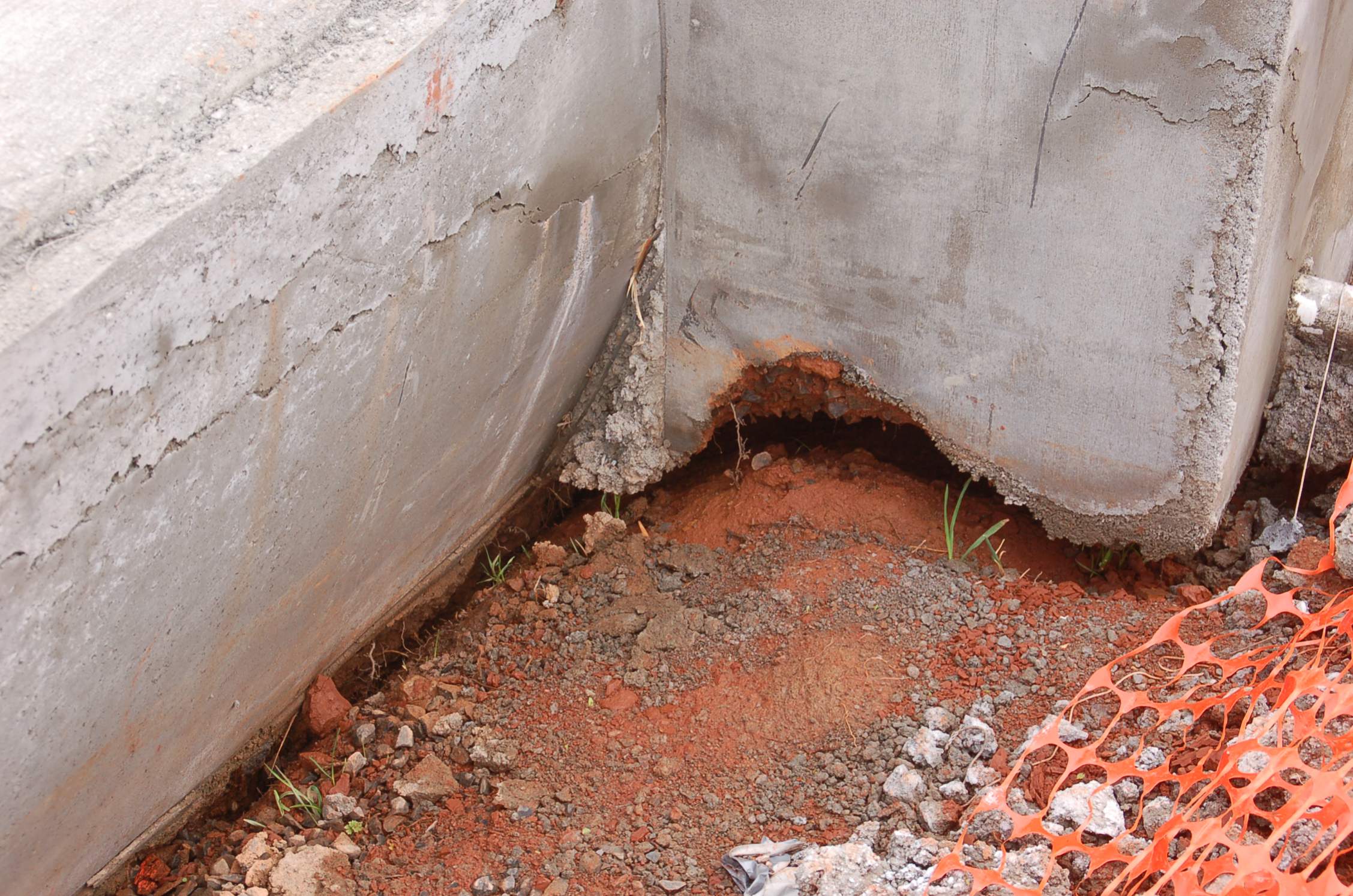

What about talking with a civil engineer, or dropping the group that did Harvey's testing for the ubunto box house they should know local terrain.
   / Your thoughts on my basement plans #117
Poor drainage around the construction site was root cause.
Note the red clay soil makeup.
Note the float!
