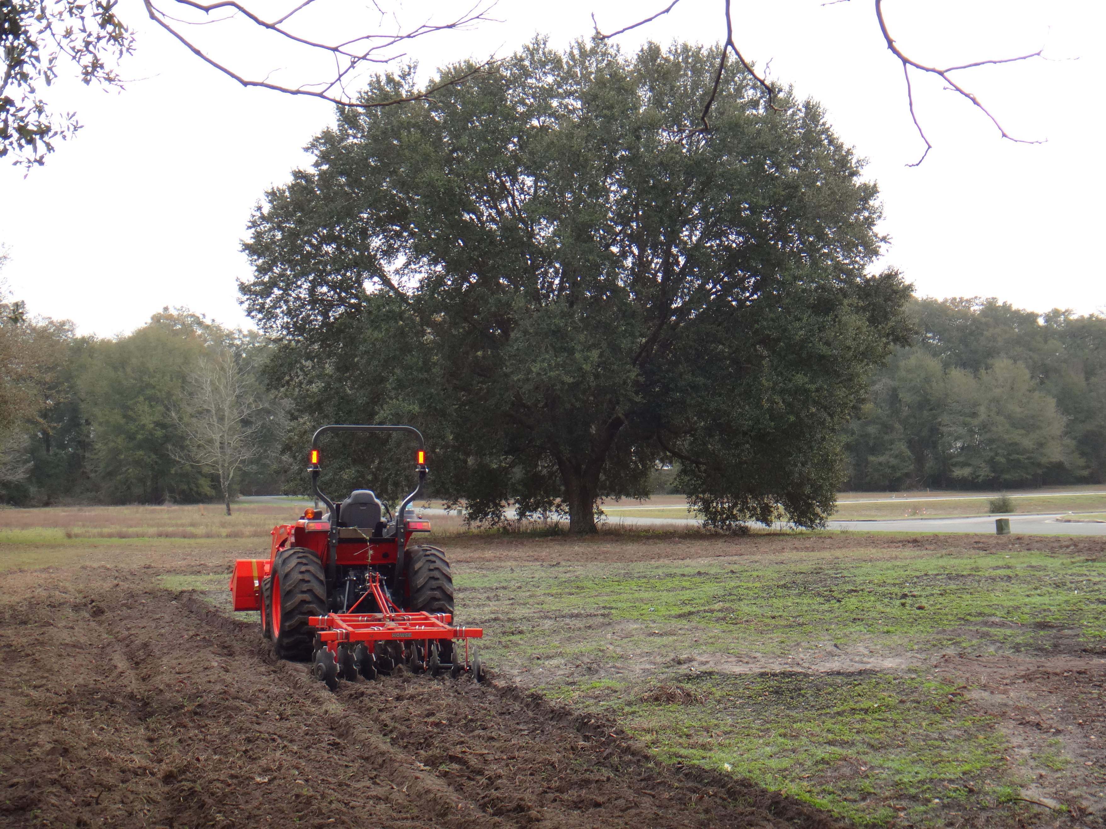

When land is tired, plowing is often the best restorative option. You might want a traditional Moldboard Plow or a Disc Plow, which is NOT a Disc Harrow. You might want to contract with a plowing service, as renewal is a once in ten (Oregon ?) year event and learning to correctly adjust a Moldboard Plow requires a lot of tractor seat time.
TDP2 Series 2 & 3 Blade Disc Plows | Tufline
After the plow, you need a Disc Harrow to reduce plow furrows from 12" or more to 6" or less and for annual soil preparation, should you decide to crop. An L6060 can pull a Disc Harrow with 22" diameter pans, a little wider than tire width in your soil condition. An M6060 can pull a Disc Harrow with 24" diameter pans, a little wider than tire width in your soil condition.
As Tandem Disc Harrows are pulled over land at a brisk pace, Disc Harrows mix soil and level fields. Leveling may require two or more years of disc work.
MORE: http://www.tractorbynet.com/forums/...ing-three-point-hitch-mounted.html?highlight=
QUALITY VENDER: HL Series Heavy Tandem Lift Disc Harrows | Tufline
After plowing and discing your pasture you will need to re-seed. Carefully research improved pasture seed specifically for central Oregon. Productivity may double but will require fertilizer applications.
