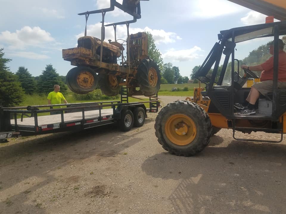

My father's 94 f250 460 5sp towed my allis chalmers forklift and trailer without even noticing it was there. Could start in 2nd gear most of the time without a problem.

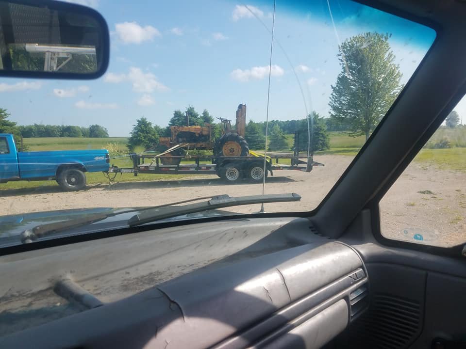

I did that once, bought the 91 F350 1 ton about an hour and half away from my house for $900. Towed an empty trailer, put my 1/2 ton on the trailer once I got there and pulled it home.
We called it the Christmas tree, because it had so many **** lights lol. Was a good truck though, after about $400 in parts. (Belts, radiator and heater hoses, drivers side rear axle seal, clutch pedal bushing, Master cylinder, ABS Hydraulic Unit, DOT 4 brake fluid flush etc.
When I bought it, brakes were super soft, clutch pedal wouldn’t come up all the way. Made a bushing out of copper because where the plastic bushing was, it was too hollowed out, had too much slop.
When I was done, sold it for $2200. Guy who bought it got two years out of it completely trouble free hauling equipment, I didn’t get an update past that.
Edit: I almost forgot till I saw the chains on the front of the truck, the truck died 1/4 mile down the road from my house. I had to bother a neighbor that happened to be outside and have him drive the truck as I pull the rig home with my tractor. The truck had a rear gas tank, someone before me dropped the tank and plugged the fuel lines with some bolts and random crap that slipped off so the truck ran out of gas essentially. I fixed it with a proper brass barbed fittings and hose clamps. Never had an issue after that.

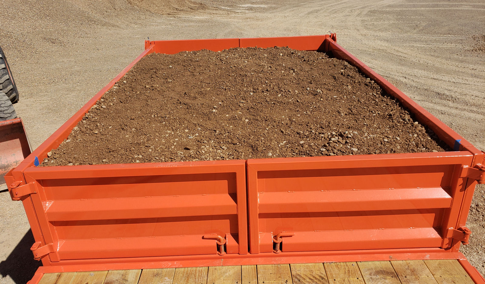

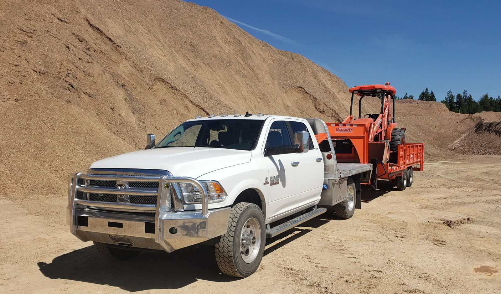

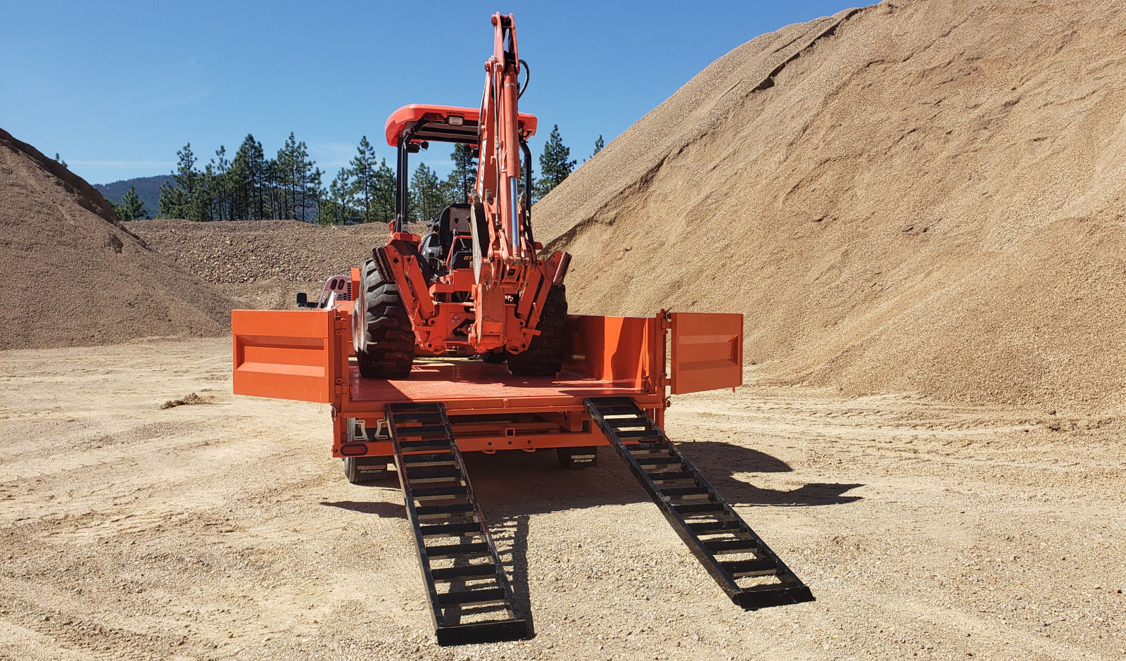

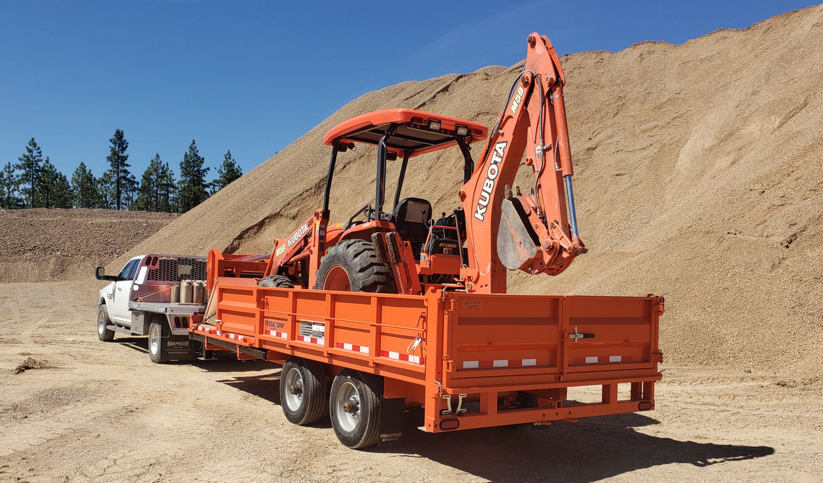

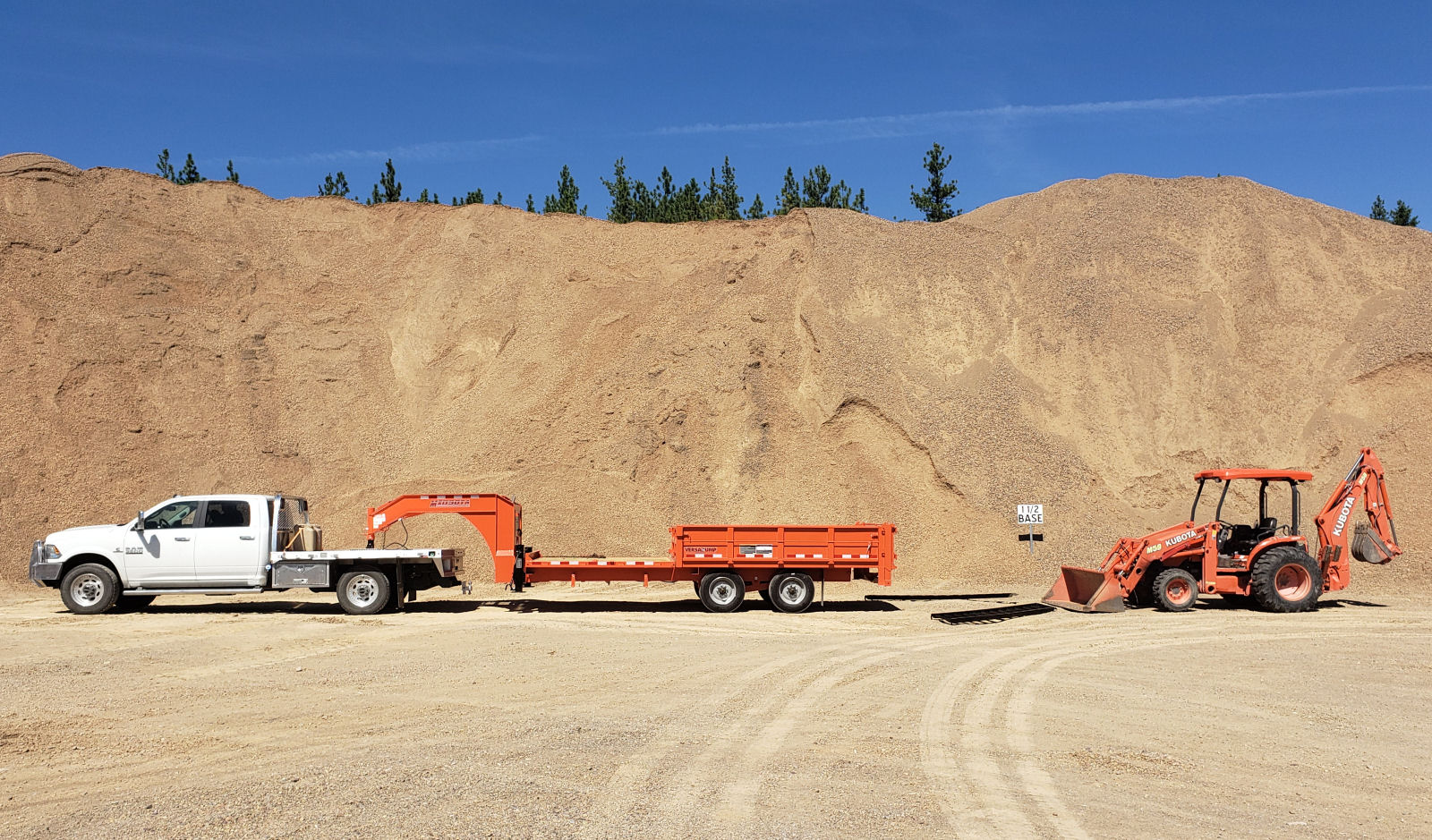

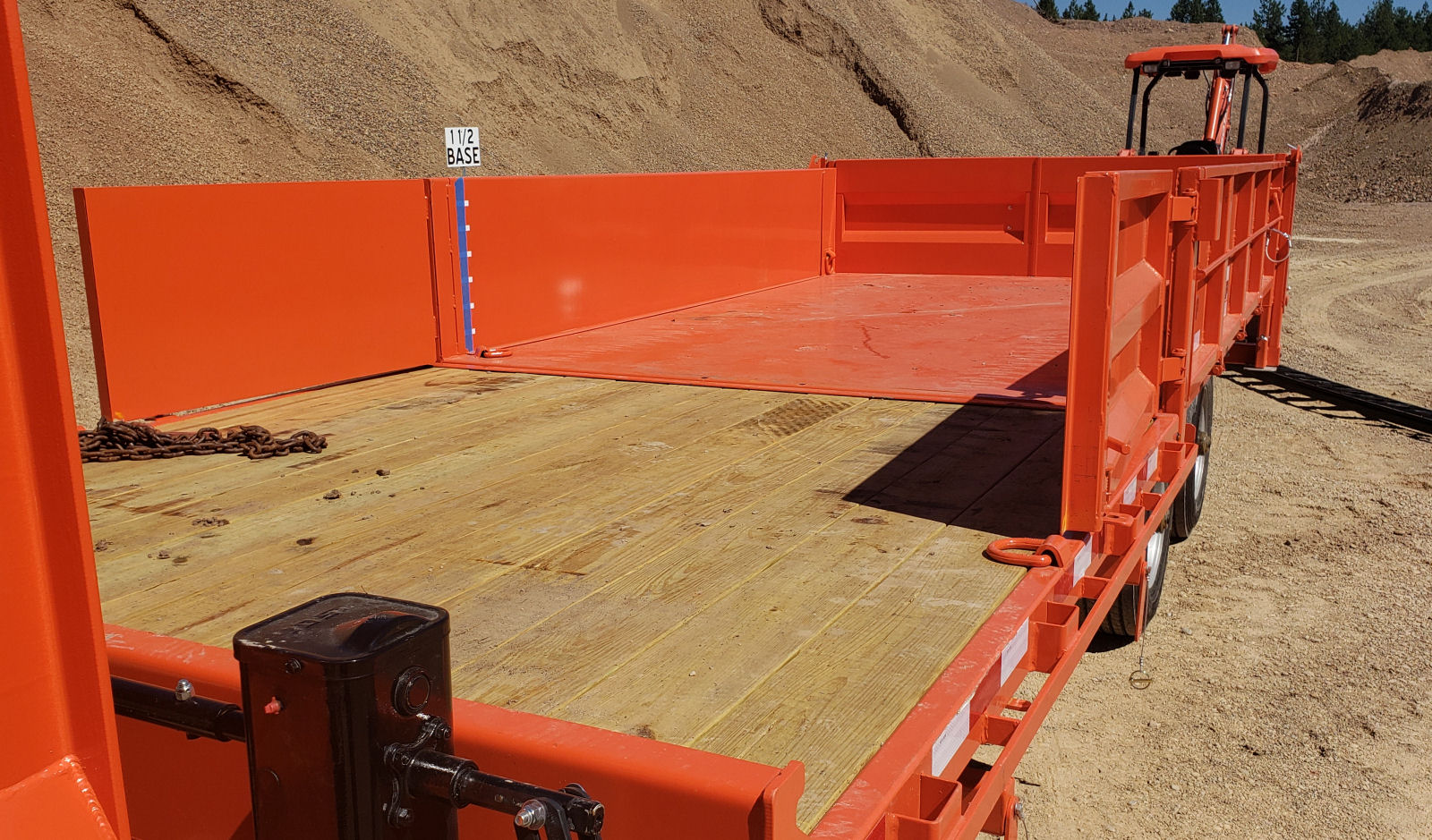

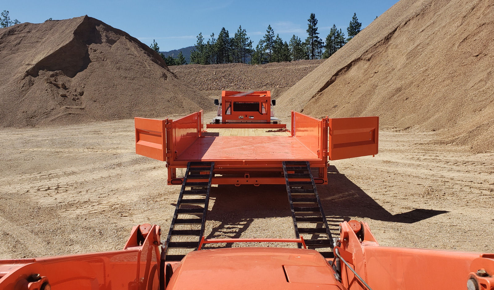

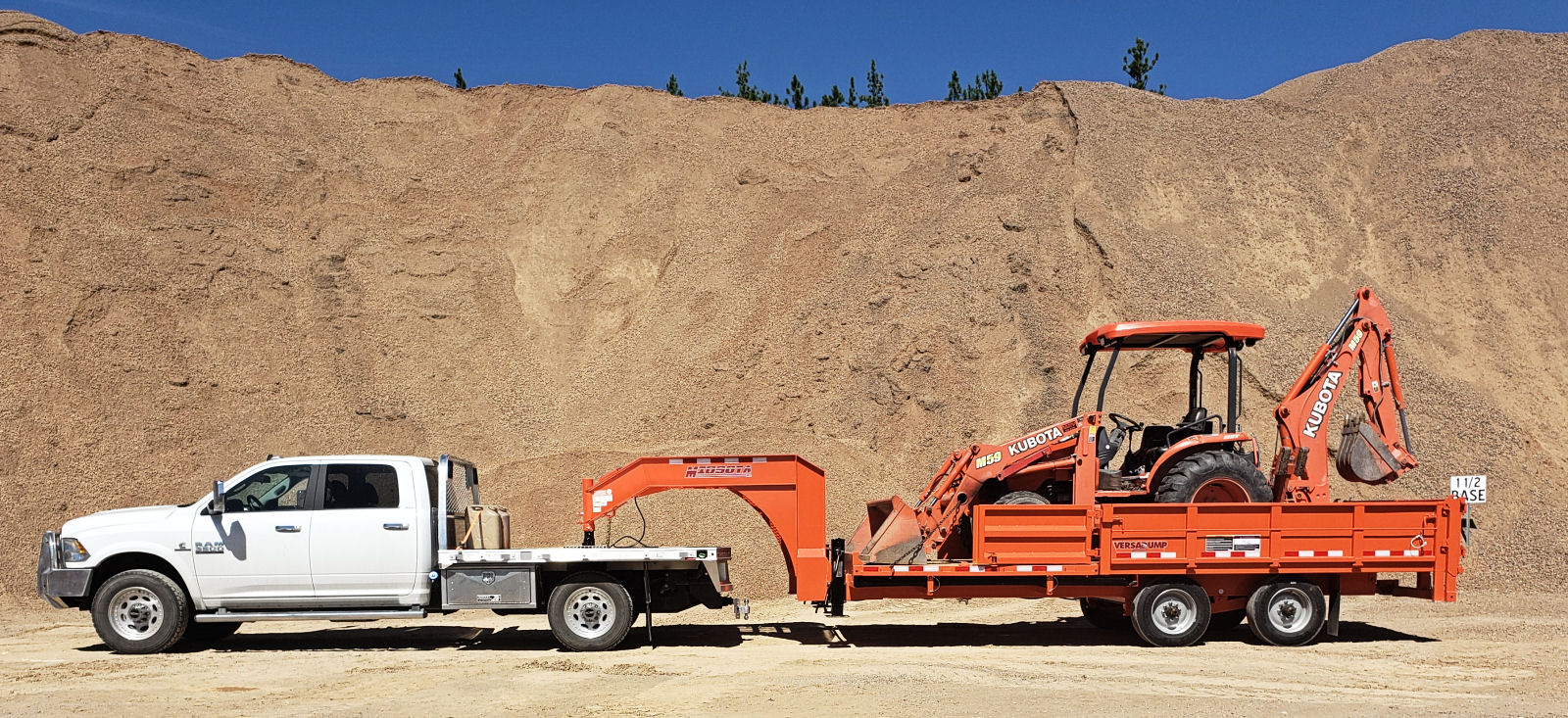

I needed a one man show, do-it-all truck & trailer setup so I just took delivery on a new completely custom Midsota FFRD for my good old M59 to ride on in style.
The FFRD has a 12' x 8' dump box with dropdown sides, 8' x 8' flatbed in front, pass through gates, 3 way rear gate, 9.5' ramps, wireless remote, receiver in neck and on rear, basket in neck, tool box, etc.
I am very impressed with how it works with 10k axles and super single 18ply 17.5's.
I pull it with an '18 Ram C&C dually converted to super single 19.5's. All the super single tires exceed axle capacity by at least 10% for safety margin.
It all works great together without having to worry about picking up rocks in between duals and a narrower track to fit through tighter roads & bridges out in the rural Rockies of MT.
Here are some pics:
View attachment 618338View attachment 618339View attachment 618340View attachment 618341View attachment 618342View attachment 618343View attachment 618344View attachment 618345
That’s an awesome trailer!! How much did that run? They have a website with different options ?
