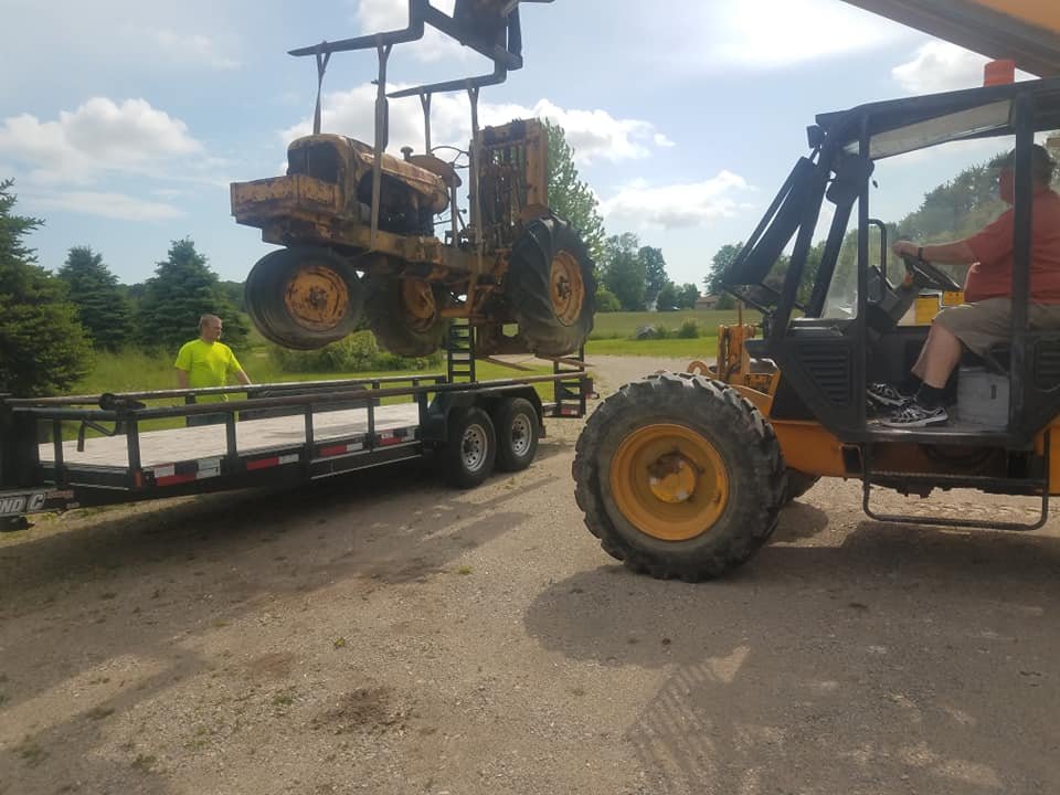

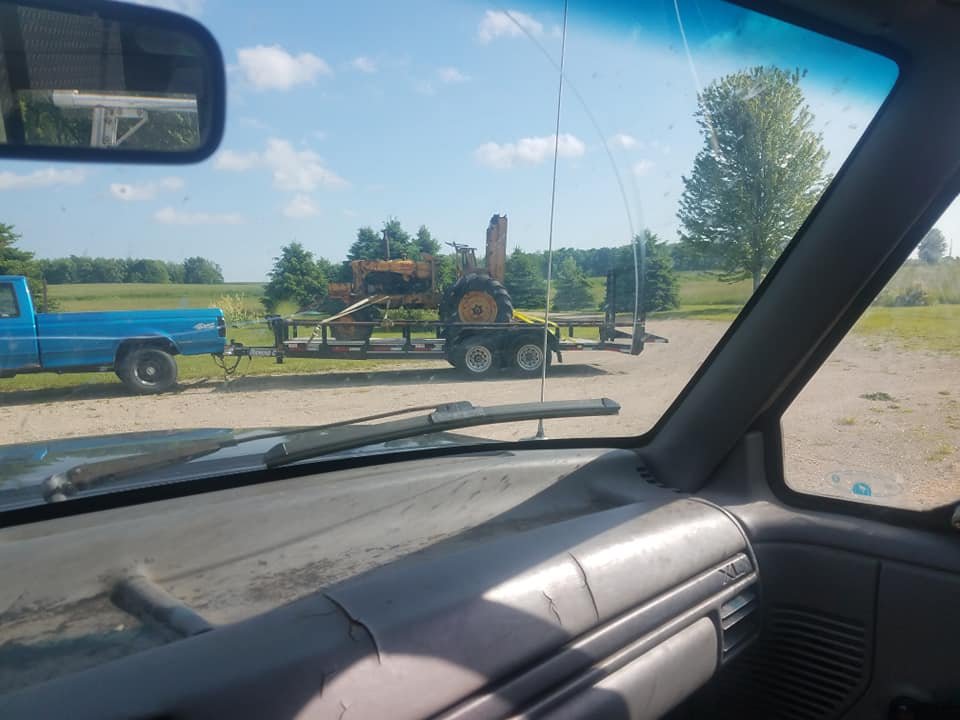

View attachment 619756View attachment 619757
I don’t want a PSD, too expensive to fix up compared to the IDI. A turboed 7.3 IDI puts out same stats as the earlier PSDs, I can build up an IDI much cheaper than a PSD and have a cheaper engine to repair down the road. From what I read.
My F350 with stock suspension would handle the load, would just have to make sure the trans stays cool, it’s already over heated on me once and blew out trans fluid all over the place (scared me, thought the truck was on fire). After cooling off, it sealed back up.
My truck has the 4:11 or 4:10 rear gears, so it has a harder time at highway speeds pulling a load, really heats the trans up. Plus my button to lock it out of overdrive doesn’t work at the moment.
The 14k load would just be to tractor shows, less than 10x per year.
