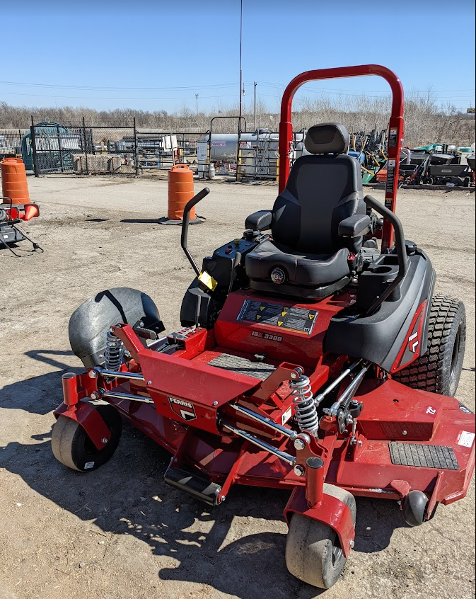

I will also chime in there with, the wife does most of the mowing, she loves the new mower:
She will also mow as fast as the thing will go. Our "yard" is bumpy as all hell, but this thing really soaks up the bumps. She has bent a blade on this one, I try to tell her to slow down a little, I see she is now slowing down for the mole hills, I guess that is a win. But most of the time it is balls out.
One reason I went with this machine is because how it will do over the bumps, at the time it was the only game in town.
It was pretty darn expensive, I would buy it again it is that big of a time saver, but damn they are expensive.
It will likely outlast me.
That is a beautiful machine! I always wondered how the deck stays at a constant height with shock absorbers, though? Always seems like the shock absorbers would cause the deck to dip in hard turns, etc.

The deck stays at a specific height due to the way it is suspended. I am shocked it works this well.
