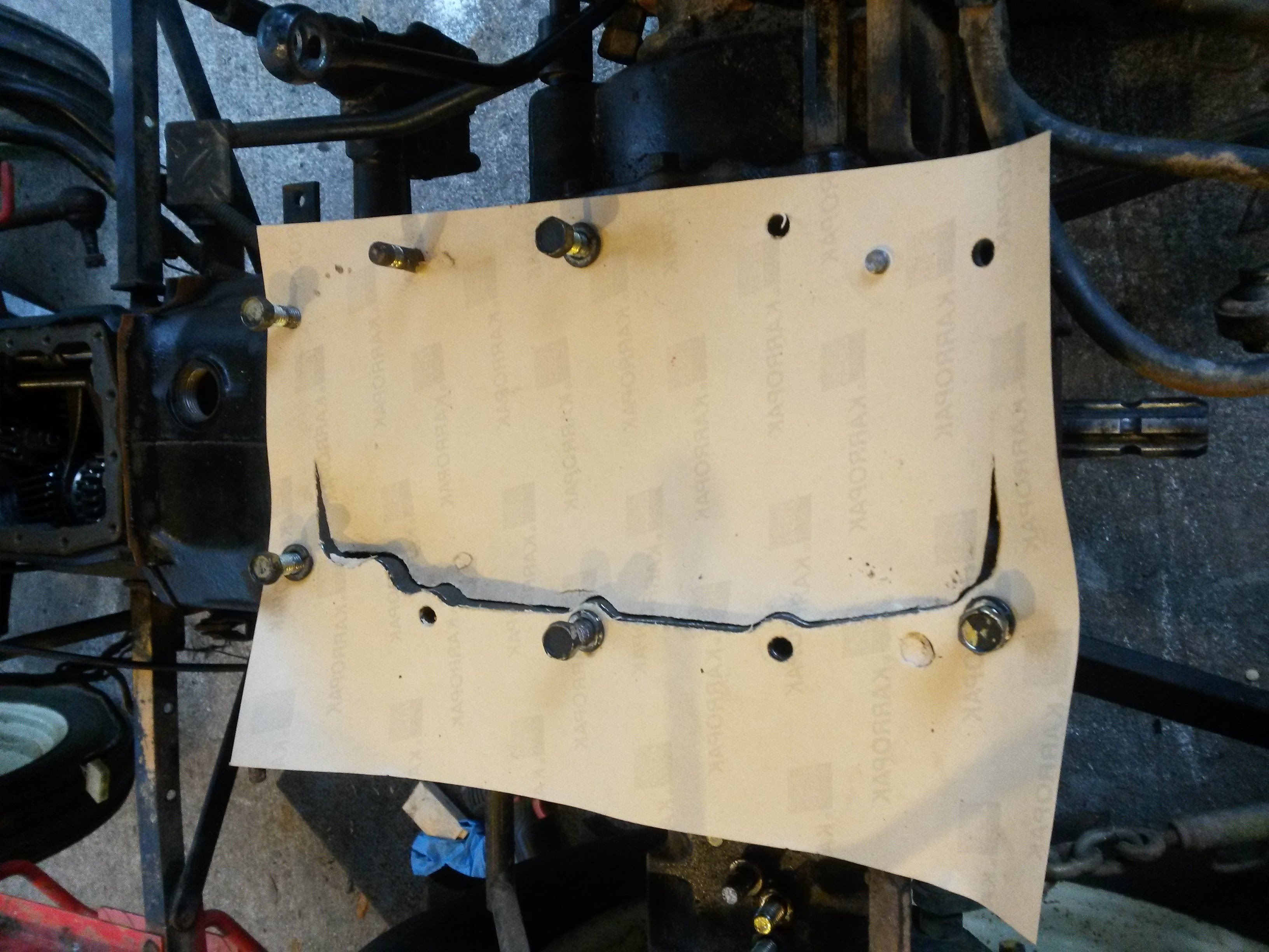

Worked as a Pressroom for quite a few yrs. and I would use Ink. Makes the perfect impression on a Sheet of Gasket Paper even upside down Etc.. Then wipes right off the metal. Ink from a Pen works also depending of the size needed.
   / Zen-noh Yanmar 22-24 transmission problem #52
he said he used a ball peen hammer. Never heard of the ball bearing thing. Maybe I out to keep some balls if I ever run across a bearing that big.
Noticed you 'tap tap' lightly to make out the gasket contours.
Do U also use big bearing balls to tap cut the stud holes? (an old trick I learned from an older mechanic)
I keep an assortment (like 1/2" and 3/4" in my tool box) otherwise use the ball end of a ball peen hammer.
Nice work and more than I'd like to take on these days.
Thx!
I used the peen to give me a location reference to use a punch set I have, but on a couple of them the peen knocked it out without the need for the punch.
I got the last join done last night. Can't get to it tonight though, will hopefully get to test run this weekend.

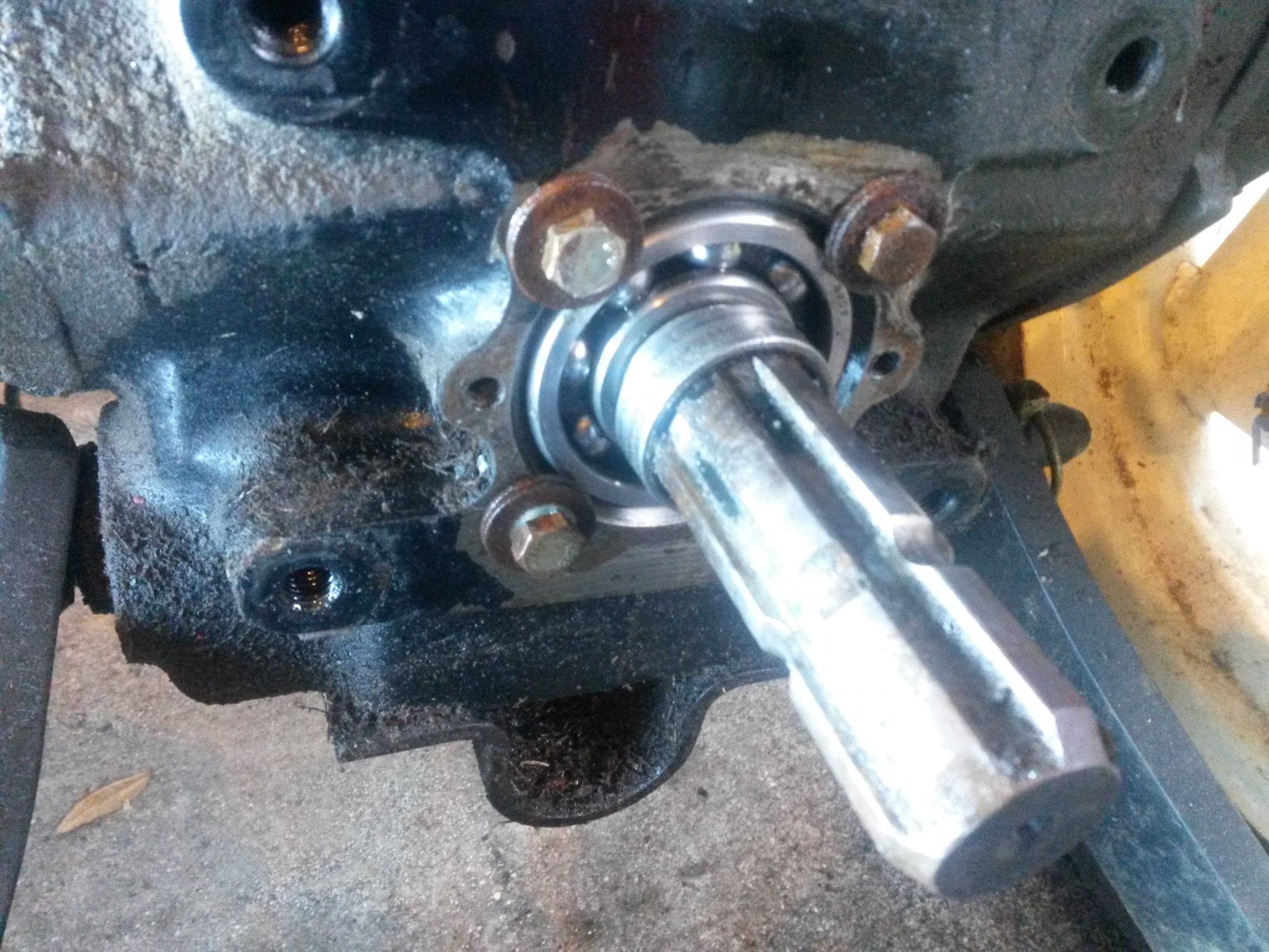

Good morning everyone. Got a little more done this week. Hoping to run today or tomorrow.
I used the recommended ball bearing method on my next gasket and it works fantastic!

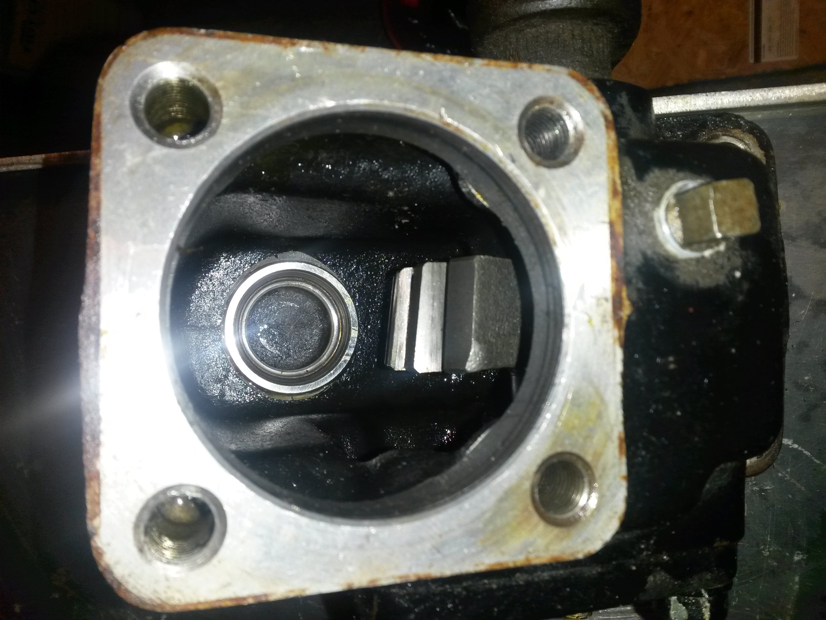

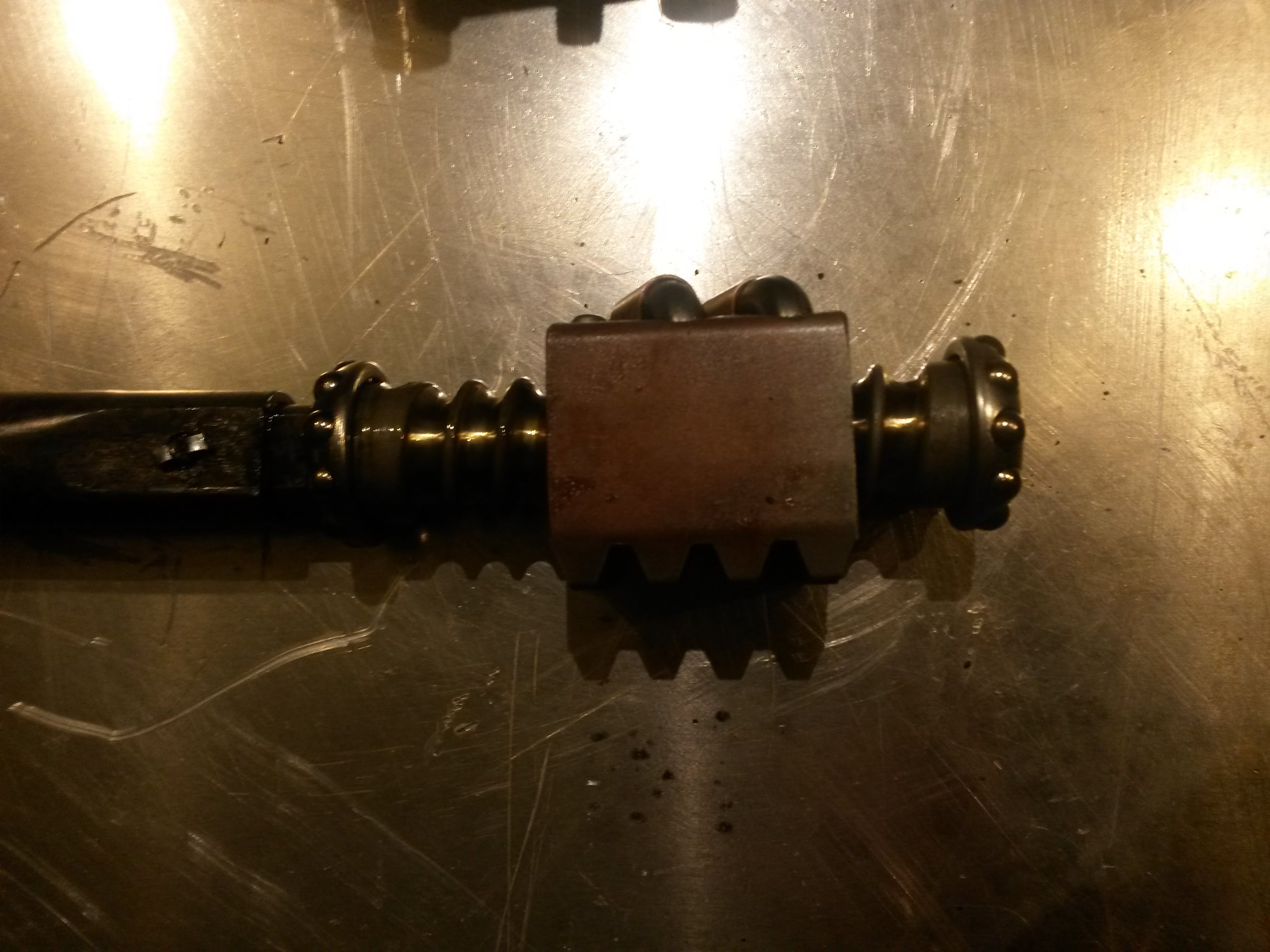

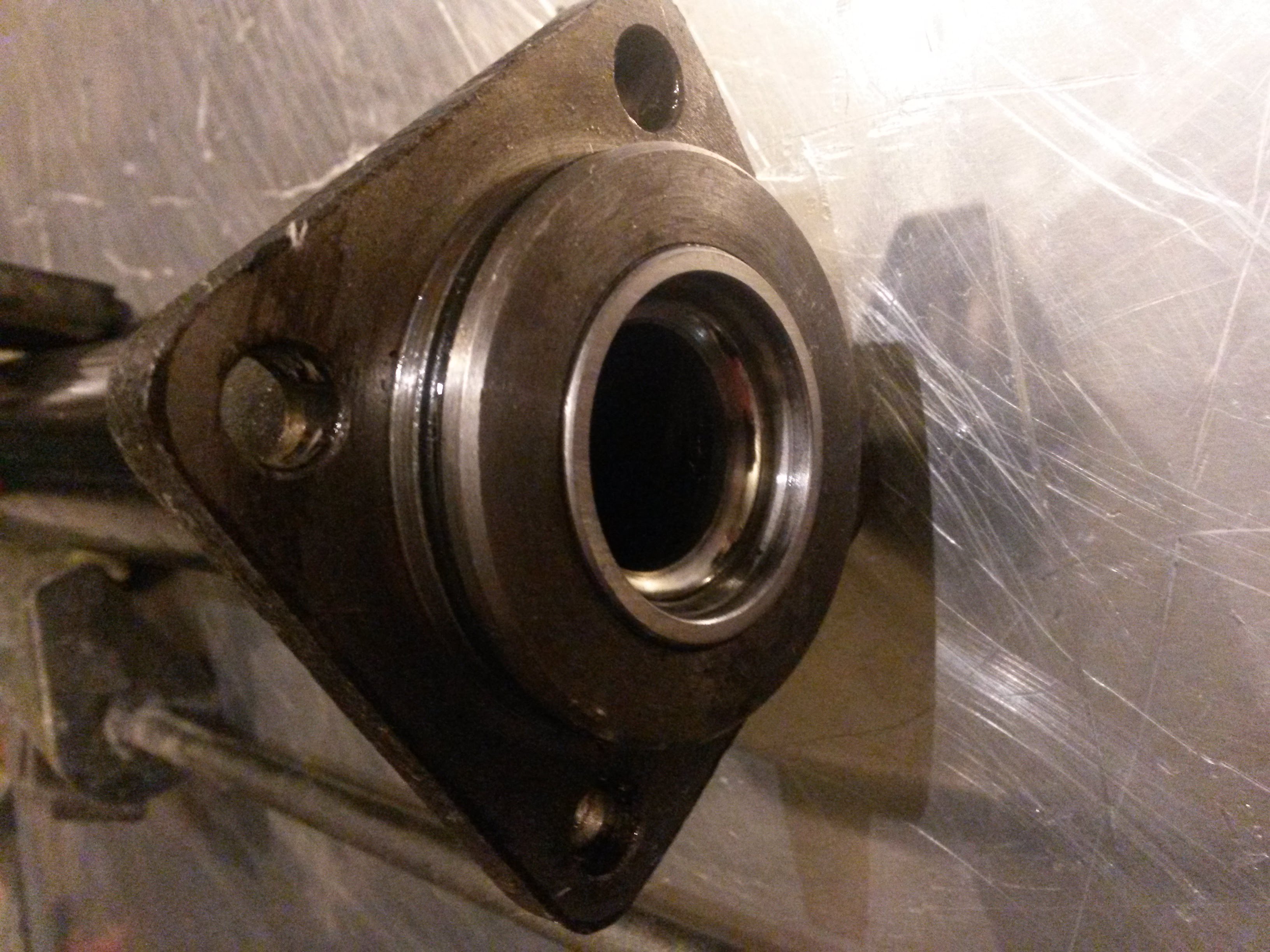

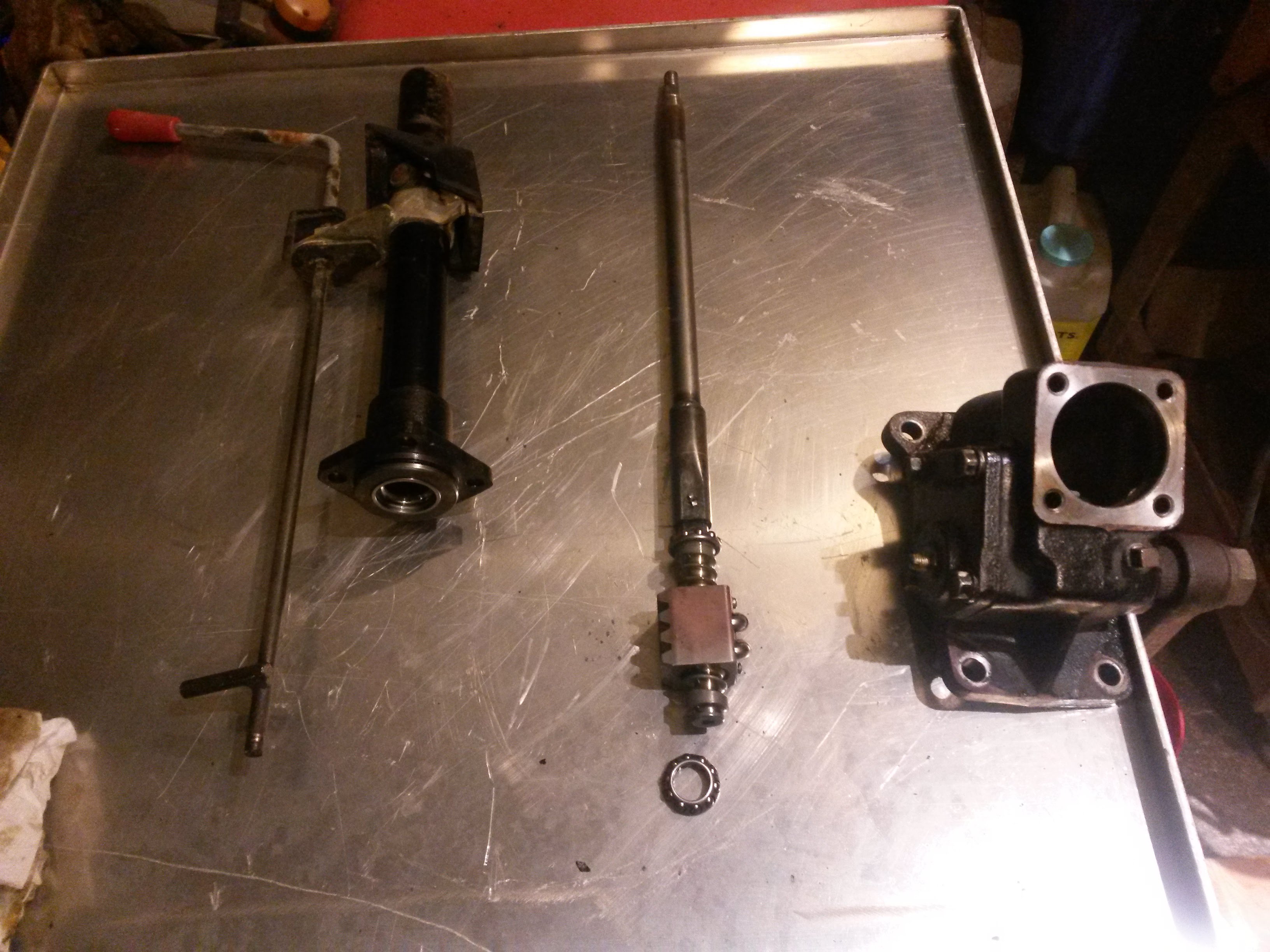

Had a little issue when reassembling the steering box. When I took it apart I removed the top section unnecessarily, and when I put it back together there was lots of up and down play when turning side to side.
So I had to clean it all up to see what was going on.... probably a good thing anyway.
What happened was the lower bearing had dislodged itself unknowingly, and that gave the shaft additional space. Anyone suggest the best grease to use?
PTO shaft is back in place, and I'm reassembling the gauge cluster today. Had a couple burned out bulbs I had to source too.

I used 90W gear oil when I rebuilt my steering gear. Works better than ever.
#59
Instead of Grease,huh? Never heard of that, but it would be easier to service!
   / Zen-noh Yanmar 22-24 transmission problem #60
From the pics, your gearbox is similar if not the same as the one on my YM2310D. The manual I have says to use gear oil not grease. I will tell you though, I am NOT a Yanmar expert by any means.
