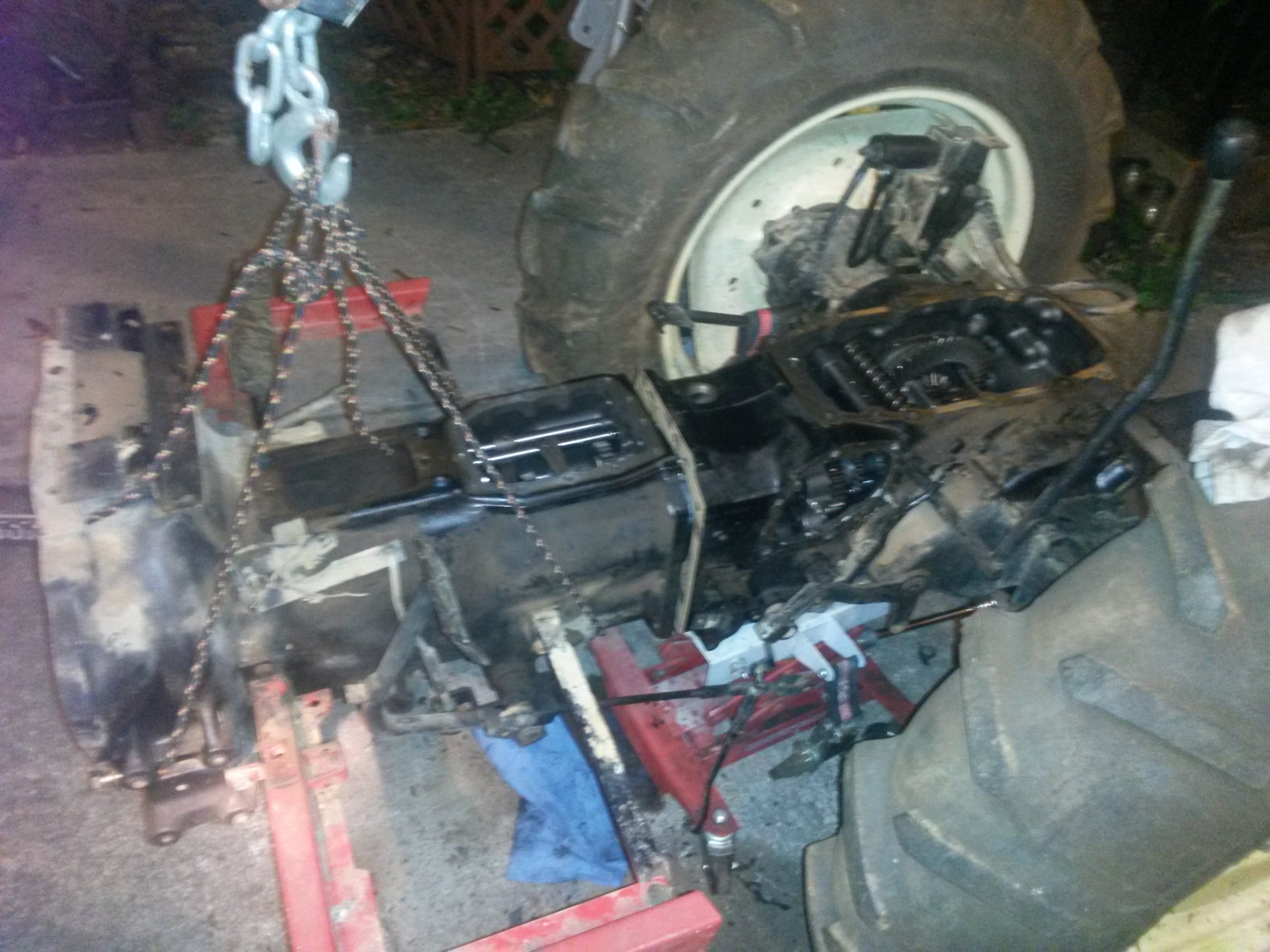

Gears are here!
Parts match up, and am installing now. I'll get the shaft assemblies back in tonight, gasket material comes in either tomorrow or the next day, and working on a final order from Hoye for some nick nacks..
:drink:
   / Zen-noh Yanmar 22-24 transmission problem
#34

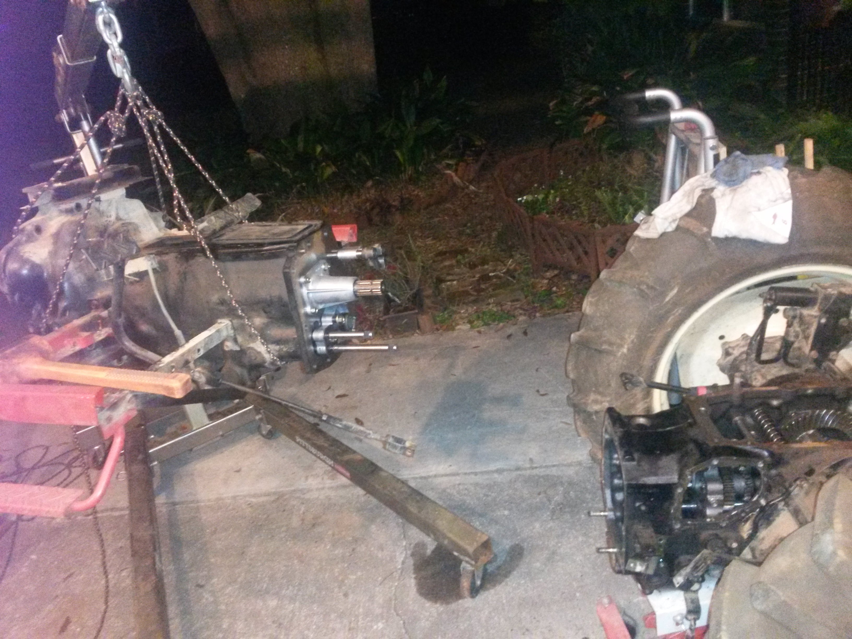

Got a little done last night. 3 sections are now down to 2...

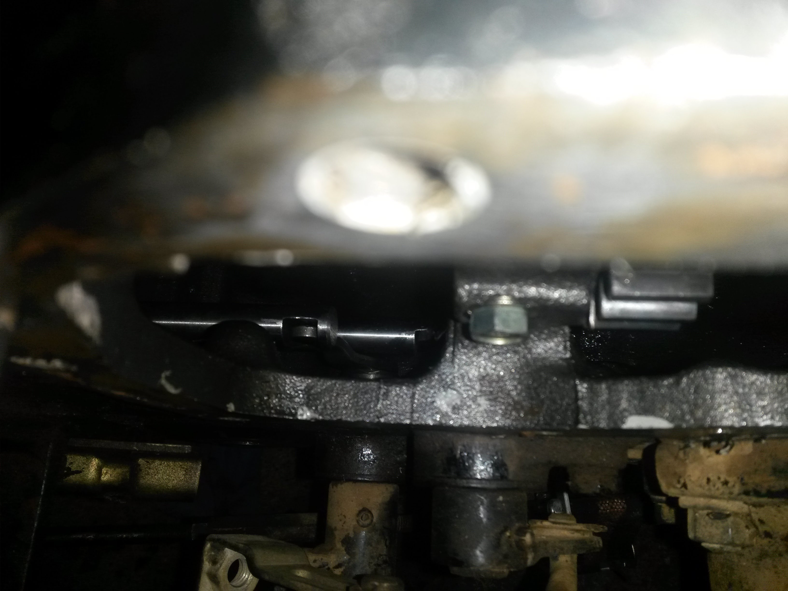

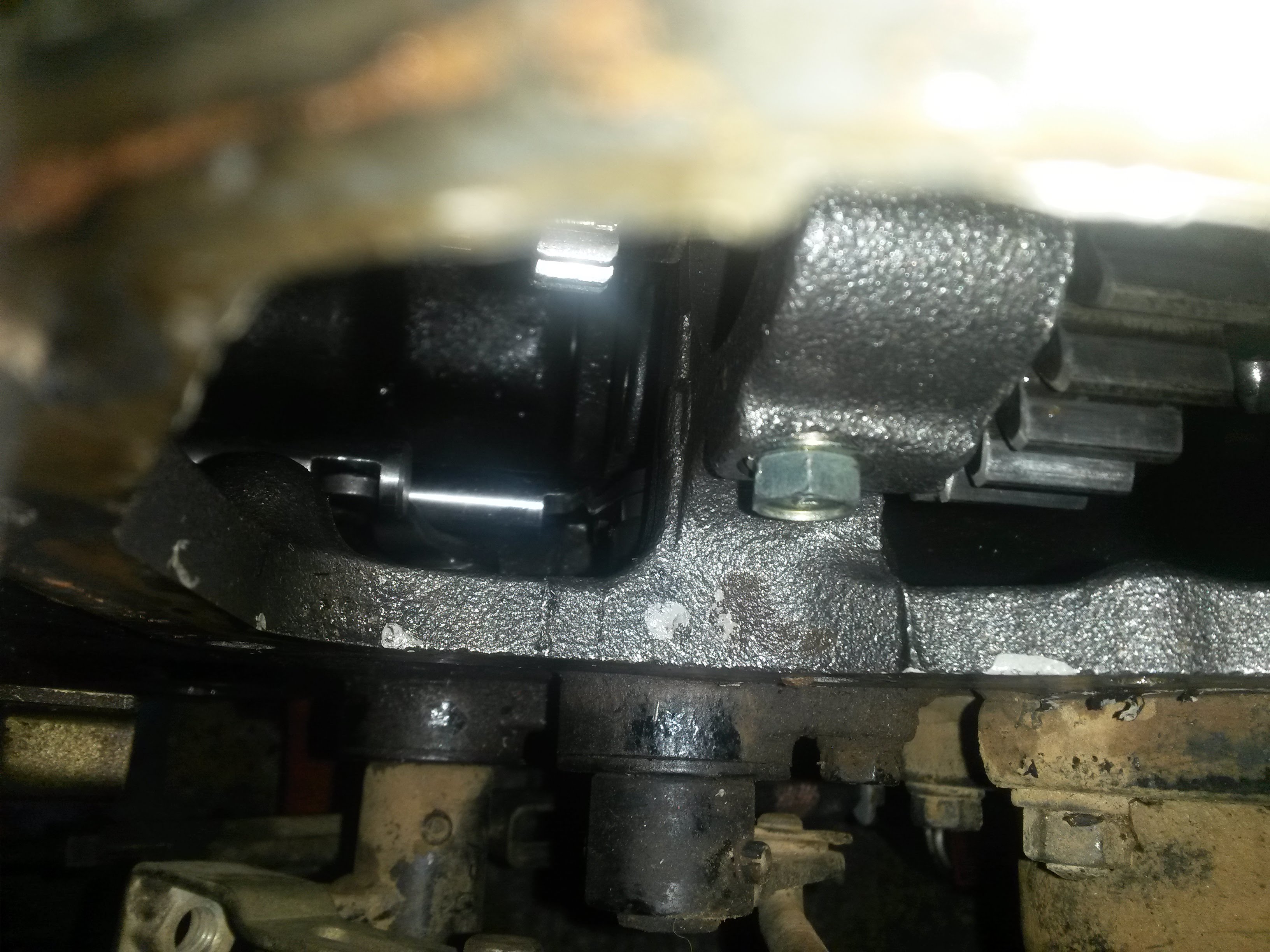

Here is the PTO shifting rod detent detail

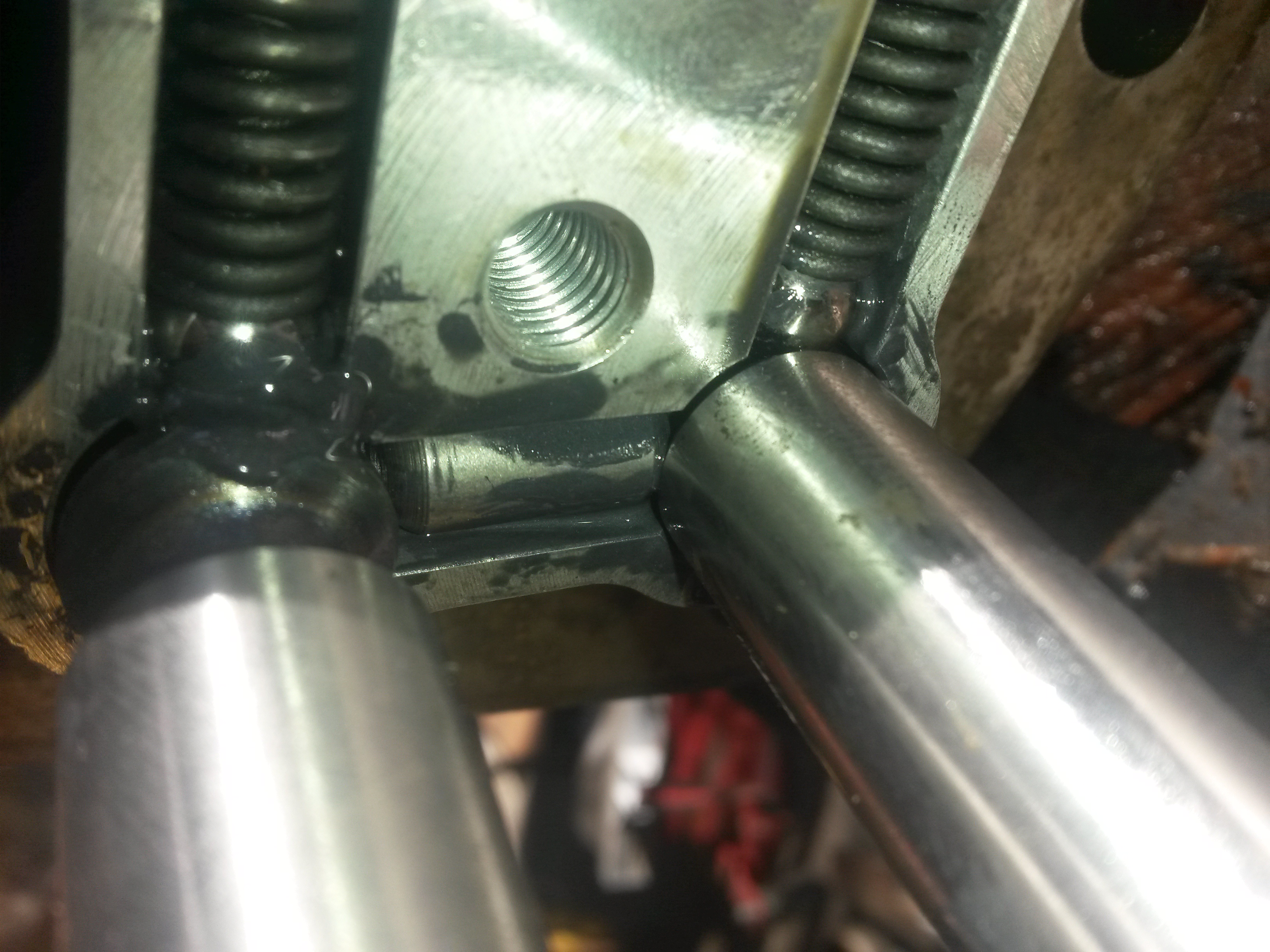

Here's where the rod ends meet the shift levers.

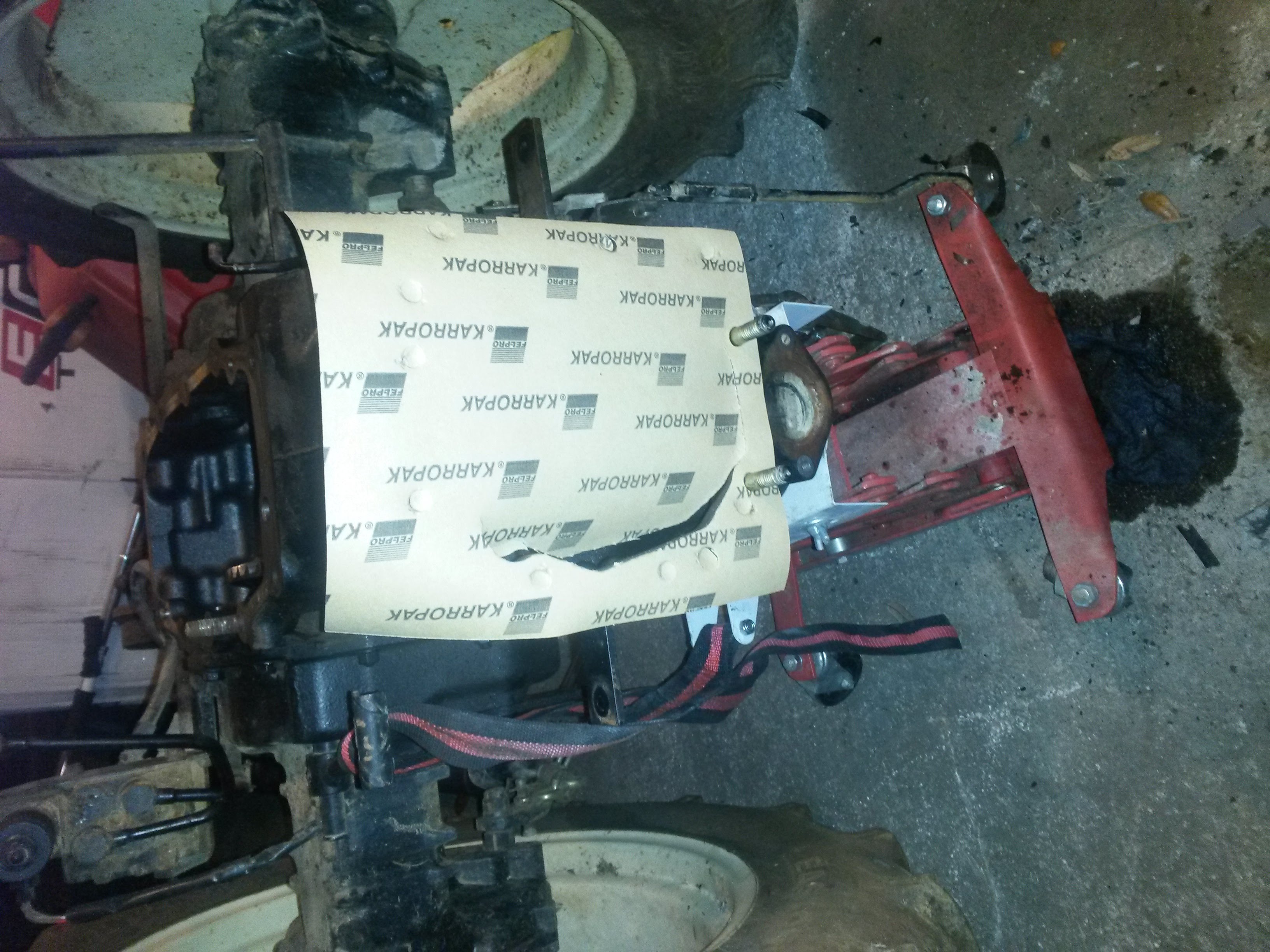

Making the gasket. Ball peen lightly and it cuts a perfect shape.
Joining

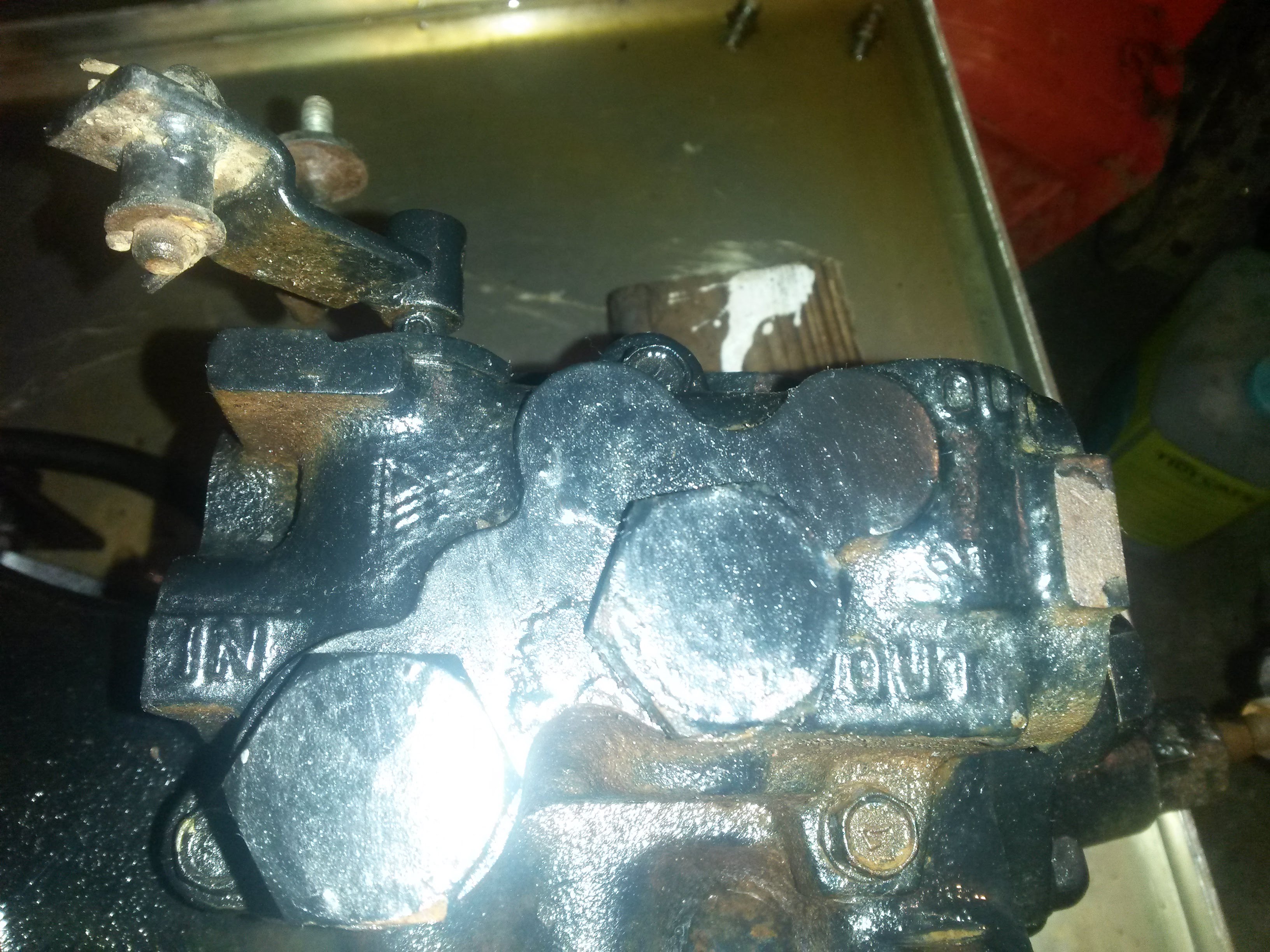

And here's a quiz... with this being a grey market tractor, what's wrong with this picture?
While cleaning up the 3 point hitch lift, I noticed this;
Apologies for the poor quality pics, I'll check them next time before saving!

Thanks for the pictures. quiz answer, grade 7.
Yes, grade 7, but not the answer I'm looking for. Hint #2, where was the tractor made?
