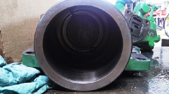

Serious Hydraulic Faillures & JD Not Admitting to Problems
Model Year: 2012
There are serious problems with the hydraulic systems on all "E" models below 80 HP. Problems cause serious overheating of hydraulic, transmission, and brake components. John Deere has not sufficiently advised dealers as to how to prevent unsold models from experiencing the problems, and how to correctly fix units experiencing problems the first time they are returned to a dealer for repair. One day, someone will lose their life when the fuel tank catches fire and burns the tractor and the operator due to the problems with these models, and John Deere will still deny there is a design problem in the "E" Series.
Pros: Unit appears to be well designed.
Cons: Poor hydraulic system overheats hydraulic and transmission components.
