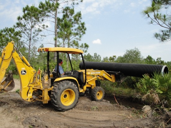

Everyone who has one loves the tractor for its versatility. Backhoe removes to receive 3 point hitch and hundreds of options of implements. Front bucket removes and steer skid loader attachments. Possibilities.... Picture shows up lifting a 700 pound scaffolding.
