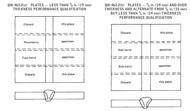

Road hunter, I may have missed it, but...was that a root bend or a face bend you made? I don't see both. There is a difference.
And did you post somewhere your process to authenticate the results? I am not saying you did not do this, but am wondering about your settings, and particular "troubles" you went to, including prep process, total plate length etc.
If you did post this, please provide a link. It's important not to know it is possible, but "how" it is possible...otherwise, it is just irresponsible for those of the guys who are impressionable by your post for them to think it can be done "any ole way".
