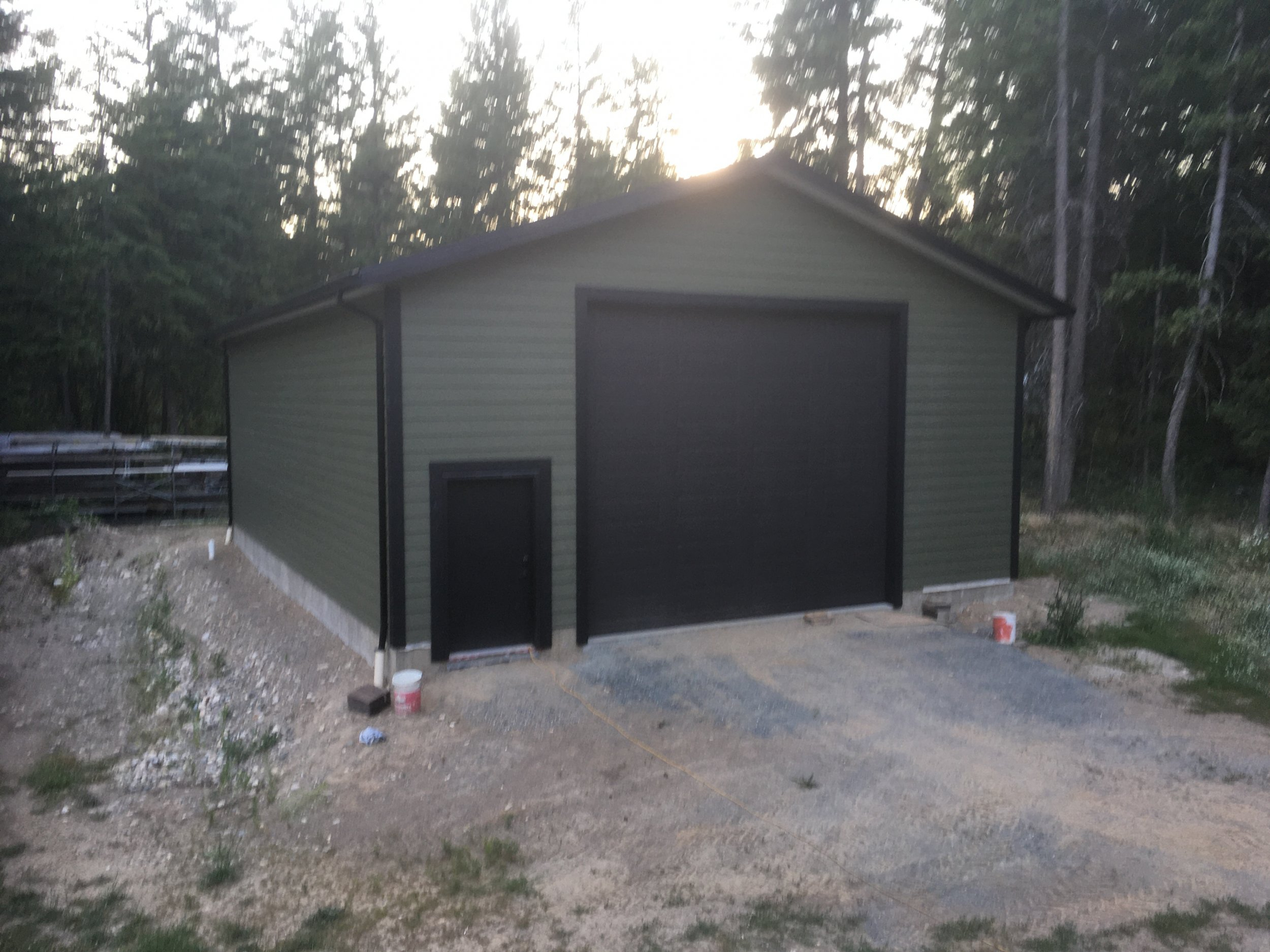

I have panel doors on one of my buildings and drum roll up doors on another, in my opinion the roll up drum doors are the winner hands down. They are easy to operate, don't require room for opening, they do not cover up any light fixtures when they're open and I also like the fact that you can get a good tight seal at the bottom when closed.

There was a 12' x 12' roll-up door on the barn when I bought the property. The barn is located on a hilltop with the door facing west into the prevailing wind. Driving snow & sleet would get into the joints and freeze making the door difficult or impossible to open in winter. Sometimes, I had to beat the heck out of it with a 2x4 to free up the joints.
I liked the roll-up since there were no tracks to get in the way of implement movement or storage. After the second winter though, I got sick of fighting with it and replaced it with a steel panel door.
