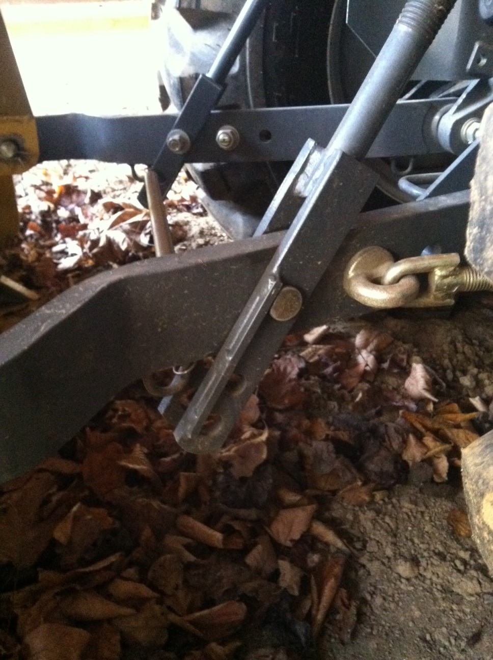

Hey tmajor, it sounds like you already fixed your problem, but here is my setup on my 1529. The bolts on mine are in the top holes in order to increase the height. I plan to change that because it is too high to pick up my flail mower as is. In the meantime I set the flail down on blocks to raise it up a bit. Thanks for the info on the lever adjustment.
Hey, you're welcome. I can not change holes any longer, as I replaced the right side lift strut with a "leveling box" ... only one hole.
Originally, I hooked the brush hog to the three point and it wouldn't hardly get the tail end off the ground. At that point, I placed the hitch pins on the brush hog in a lower hole. I'm redoing the driveway, as I had pretty much lost my "crown" and the water was just running down the ruts. I noticed, both the stone rake and box blade didn't lift as far, as I felt they should.
It works like a dandy, now.
