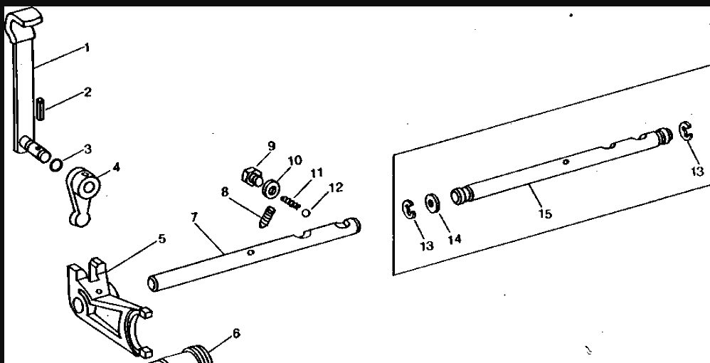

I have read stories about the PTO lever, that is behind my left foot while sitting on the tractor, shearing off the little roll pin that connects the lever to the PTO engage/disengage assembly.
Mine still works fine, but it does have some side to side play. So left and right play when sitting on the tractor. This is what has me worried. Is this a tell tale sign that my lever is about to go?
I have read the only way to fix this is by splitting the tractor. The link below shows another thread about this lever.

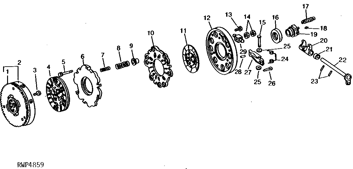

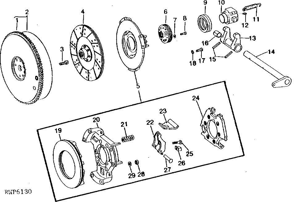

Looking at the parts diagrams for both pto models both use the same 2 roll pins to hold the fork. I don't see having much issue with this set up as two 3/8" diameter x 1 3/4" length roll pins should be pretty stout. Item marked #23 in the first picture and #15 in the second picture.

I thought PNW1020D was referring to pin(key 2) on pto engagement lever.
Re reading the thread you are likely correct. I was curious about getting to the pin and pulled up the above illustrations. Just from memory it would seem you could get to the linkage with the rockshaft removed but I was looking for a drawing to verify that.
PNW did not say how much the lever move left and right, that would be helpful to understand his problem.

So yea, I was referring to the pin shown as item #2. I would say I have probably 1/4"-3/8" side to side movement for the pto engage lever. Should that be concerning?
