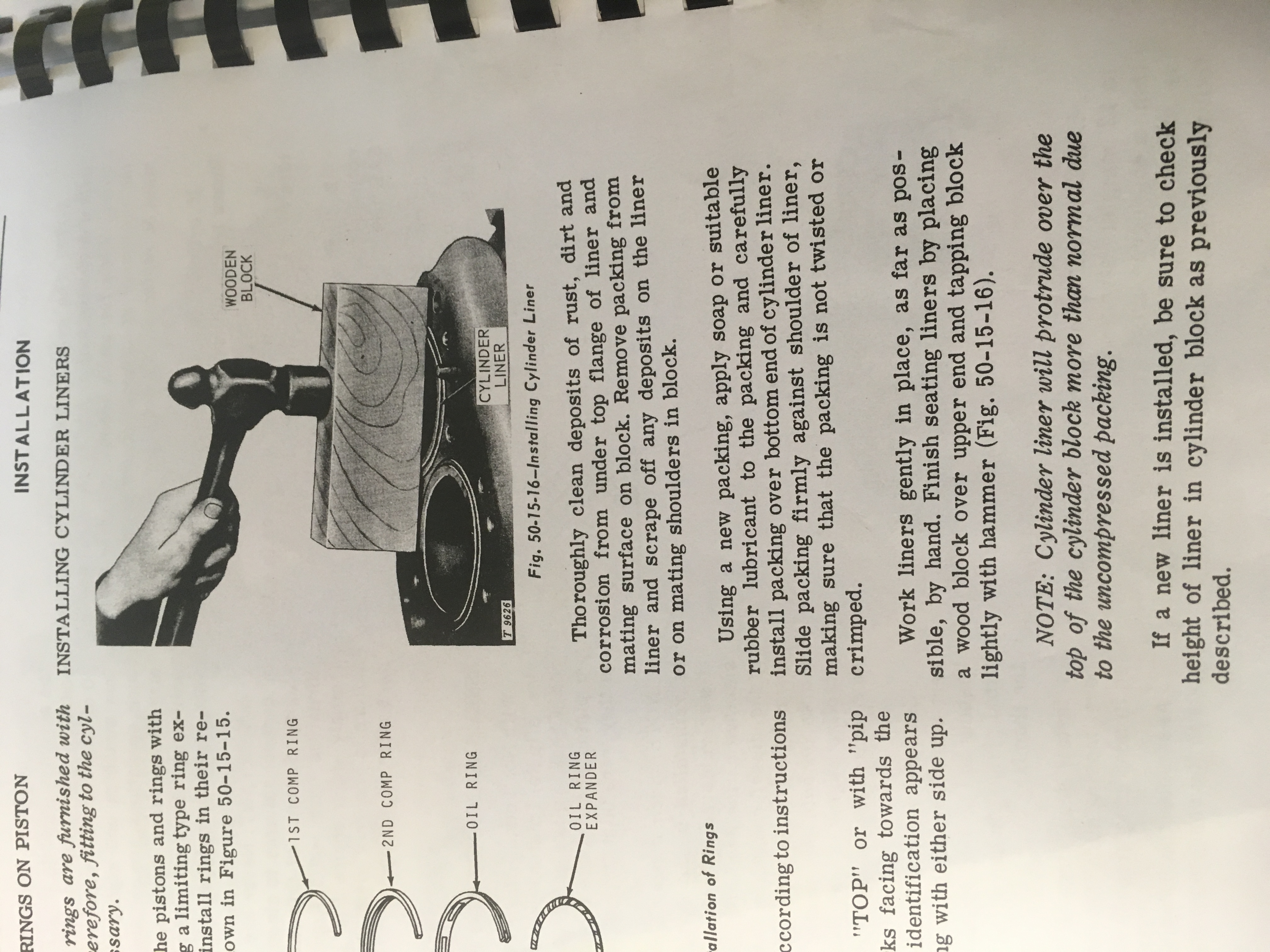

I have gone about reinstalling the liners.
All three went in after proper installation of the 0-ring packing materials. I followed the install instructions to ensure I was placing the o-rings in the correct places.
Black
Red
Black
I used just basic hand soap as my lubricant.
I placed the liners in each cylinder, and hand pressed them in as far as them could go.
I then used a small piece of 2x4 with a mini sledge to tap/drive the liners all the way into the block.
I used just basic feeler gauges around the circumference of the liner to ensure the liner was seated, and exposed the proper height above the block deck per my JD manuals. It stated .004 as the measurement.

It sounds like you are on the right track. My only concern is your description of installing the liners. Did you test fit the liners before installing orings? The liner should fall into place all the way without orings. No pushing or tapping should be required. When orings are installed, just leaning on the liners with your hand pressure should make them slide through the orings.
   / 1969 JD 1020 diesel
#50
I dropped each liner into each hole without packing before final install. But I guess I should have paid more attention, and I misunderstood the manual to be honest.
As for the use of a hammer I thought it was permissible because of the manual. IMG_0123.JPG
Click on the photo, idk why but it always posts the orientation incorrectly, until you click on it to enlarge the image.
