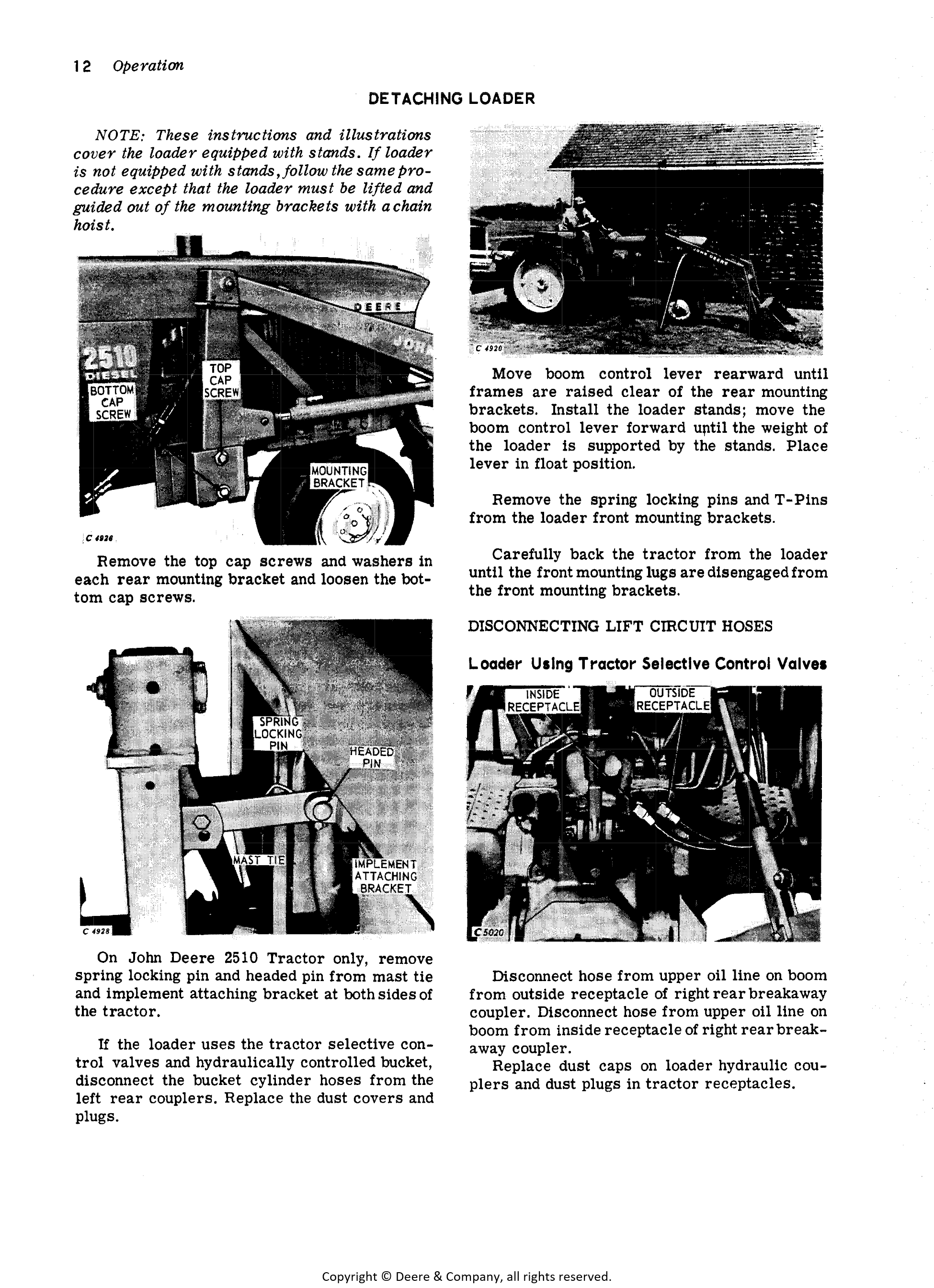

Now that you have me thinking specifically about my FEL. I have some questions, and maybe Tx. Jim can shed some light on this subject specifically for me.
I have a JD model 47 loader on my 1020.
Look at the paragraph below from another tractor forum about JD's model 46a loader and my model 47.
The 47 is Deere's first quick attach loader.They were nice to take on and off.Do you have the bracket that attaches to the engine head and goes to the rear of the loader mast?This makes the 47 a much more stable loader. Many 2510's are missing this bracket.The 47 with hard use can tear up the side frames if the mountng bolts work loose,when new Deere had a plate that went under the bolts behind the side frames.The 47 could also be used on the 1020 and 2020 tractors but you need different mounting brackets and the rear mast frame is different on the utilities.The 47 is a good match for a 2510 and makes a nice looking outfit.If you ever get a chance buy a broke up welded up 46A for parts as the cyclinders interchange.We have bought several loaders for the cyclinders and buckets then scrapped the rest.Also a 47 and 46A use the same buckets.
What is he talking about in terms of "Do you have the bracket that attaches to the engine head and goes to the rear of the loader mast?"
Also, if my model 47 is in fact a 60's quick attach loader, can someone tell me how the **** I am supposed to go about accomplishing this?

I viewed the model 47 parts catalog & didn't locate any bracket that attached to engine cylinder head nor do I remember such a bracket from my JD dealership tenure.. Removing/installing model 47 would be much easier if you have the mounting stands.

Here is the page from the manual on detaching the loader. It mentions the bracket on cylinder head, but that was only used when installed on a 2510. If you don't have the parking stands, you need to support loader from above using a chain hoist or something similar.

Hey thanks Tx. Jim and JD110. I really appreciate your willingness to help me out and provide me with confidence.
As the saying goes, pictures are worth a thousand words. JD110, the image you posted really helps me. I know it isn't rocket science to get the FEL disconnected, but the last thing I would want to do is break something trying to remove it because I was simply uneducated on how to.
