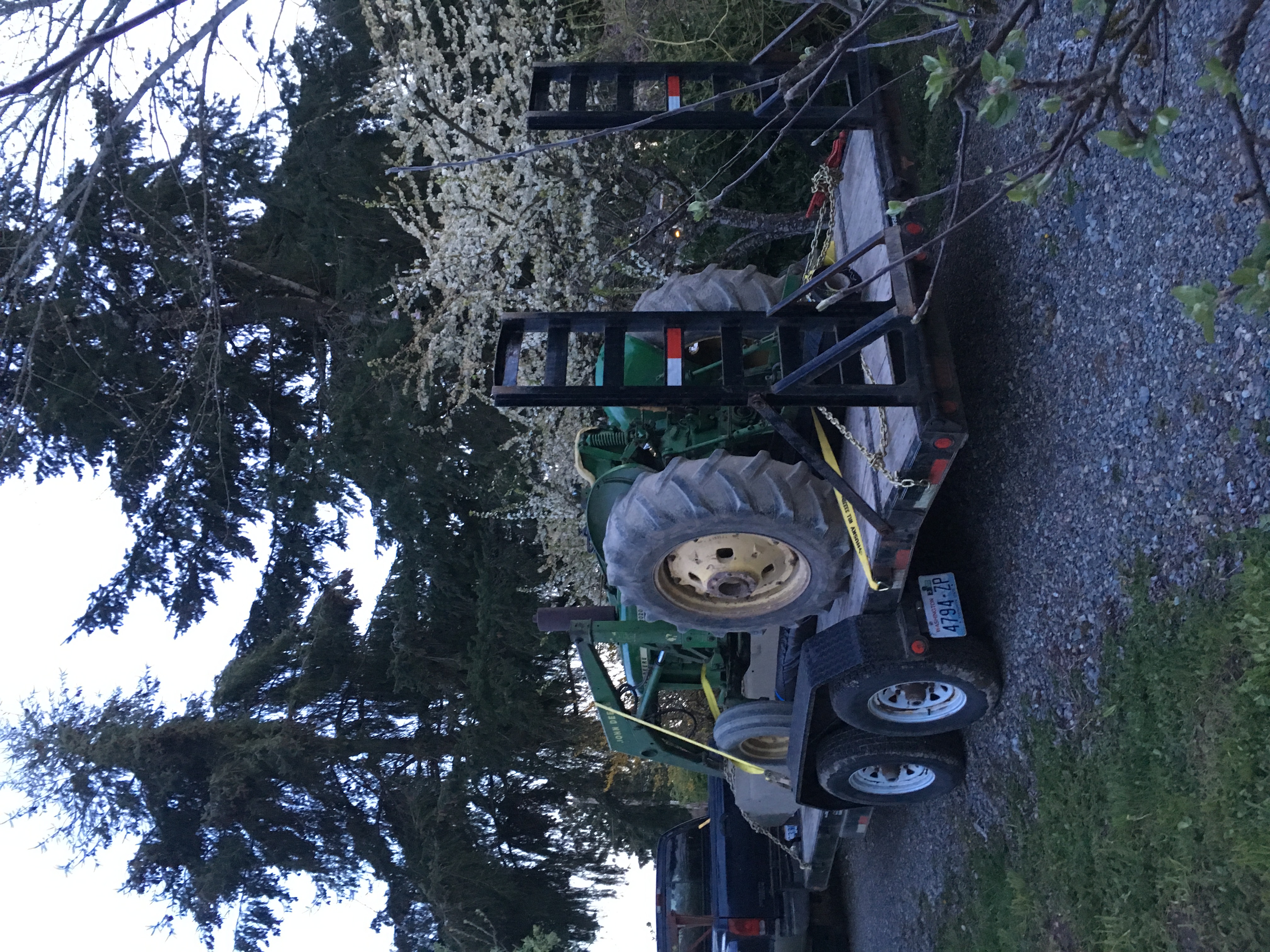

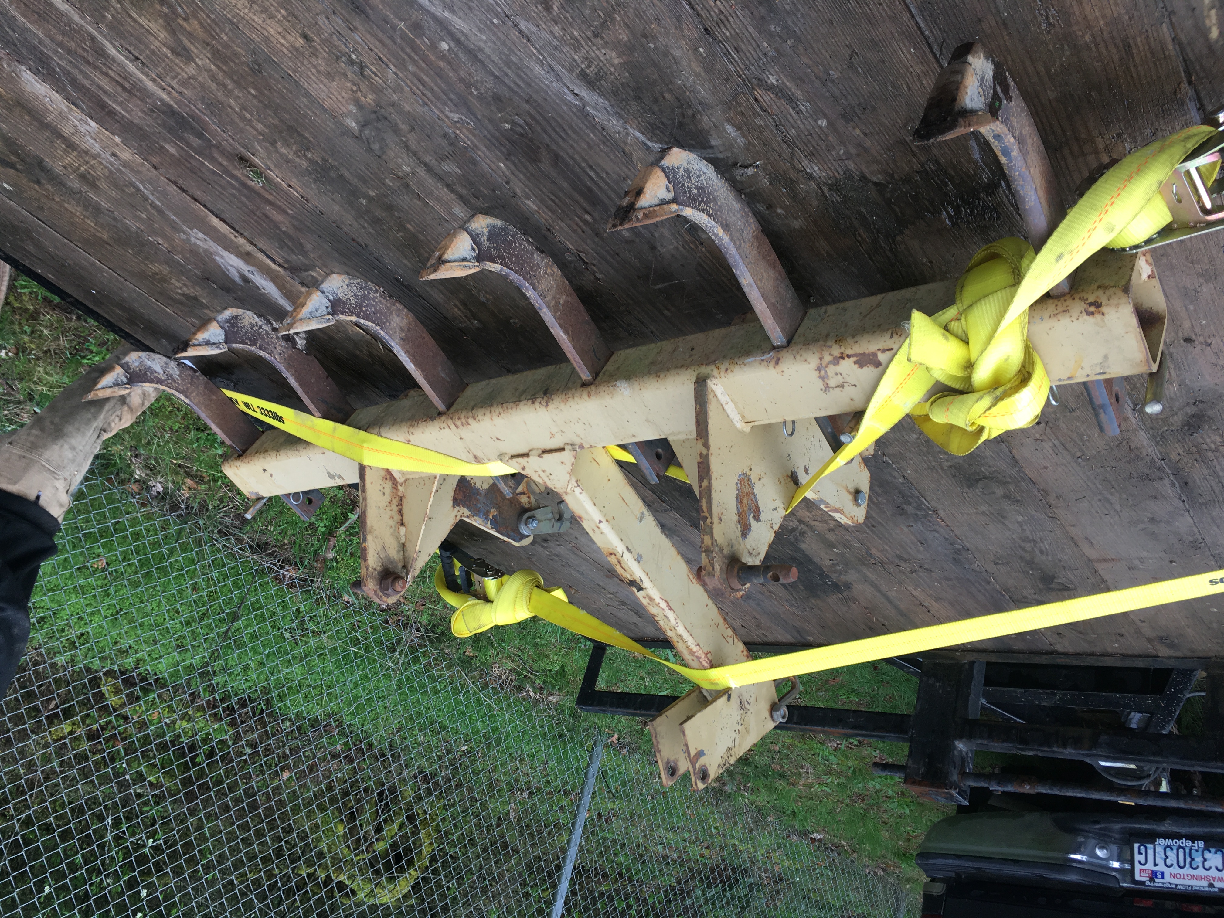

I redid my friends driveway this weekend, so it saw some good work time of 3-4 hours. I also picked up a new attachment :thumbsup:
It was the first time I have hauled my tractor on my truck and trailer. I was a bit nervous needless to say. :laughing: The weight of a tractor on a trailer just reacts different in comparison to a mini-ex so I took it slow and steady.

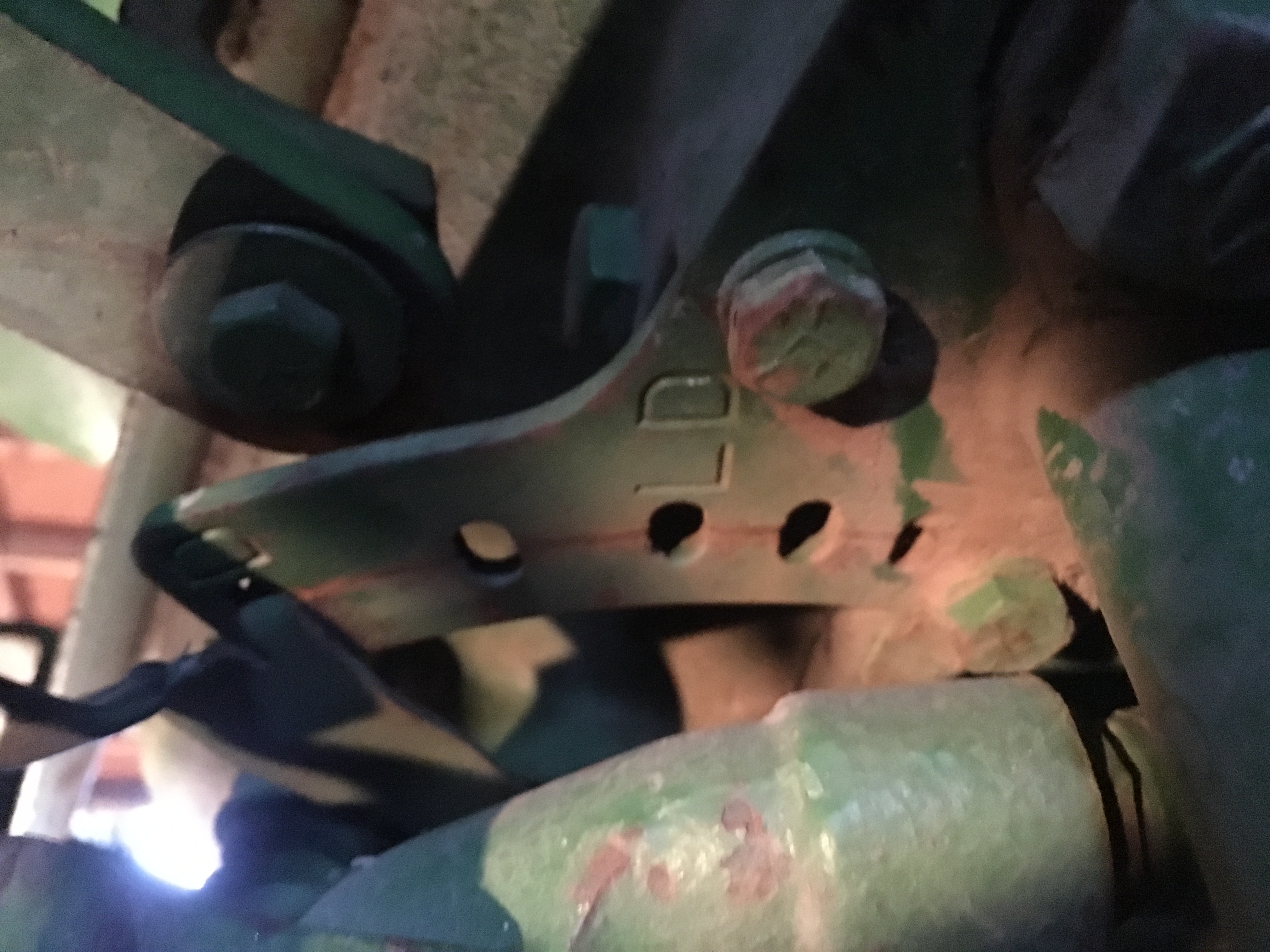

Here is my little lever that is under my seat.
Lets say for example I want to brush hog out in my field. Shouldn't I be in the D position?
And then lets say I want to use my ripper, shouldn't I put the lever into the LD position? And what are the other holes below the LD position?

   / 1969 JD 1020 diesel #66
And finally I have been reading up on 3pt adjustments and draft position control etc.
Lets say for example I want to brush hog out in my field. Shouldn't I be in the D position? [/QUOTE]
You're correct in your understanding of L/D control lever settings. "L'' is for plowing and it more sensitive sometimes ""too sensitive"" thus the use of less sensitive LD setting

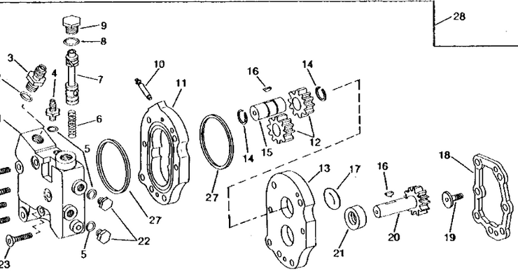

   / 1969 JD 1020 diesel #69
PS pump is mounted on RH frt of engine on 1020 tractors built for North American sales with serial number up to 045199

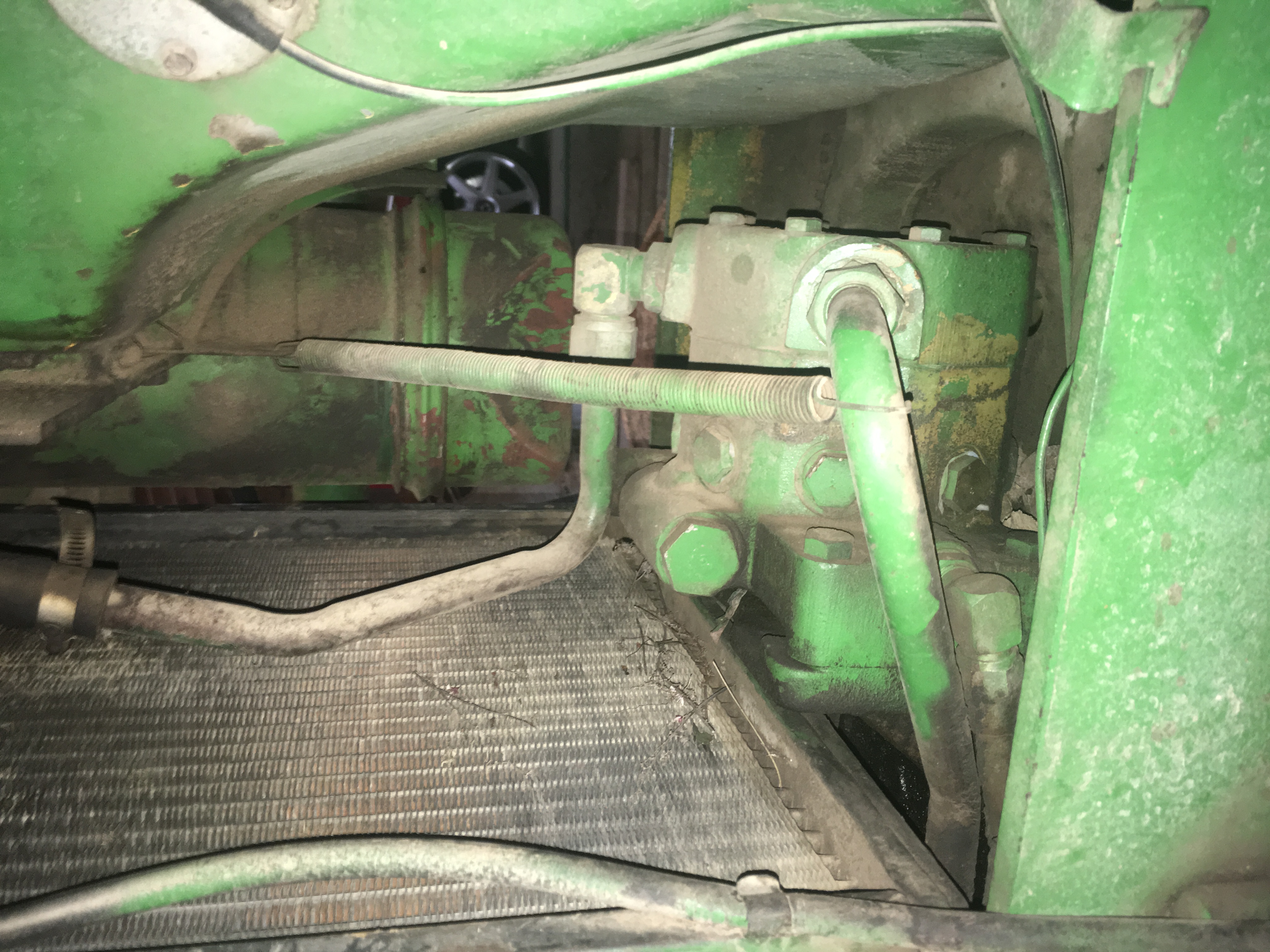

Ok thank you Tx. Jim.
That range of serial numbers is prior to mine, so that must mean I have an internally mounted power steering pump?
Please see the attached photo.
Is this my main hydraulic pump then? It seems to be "whining" to my ears. :confused3:

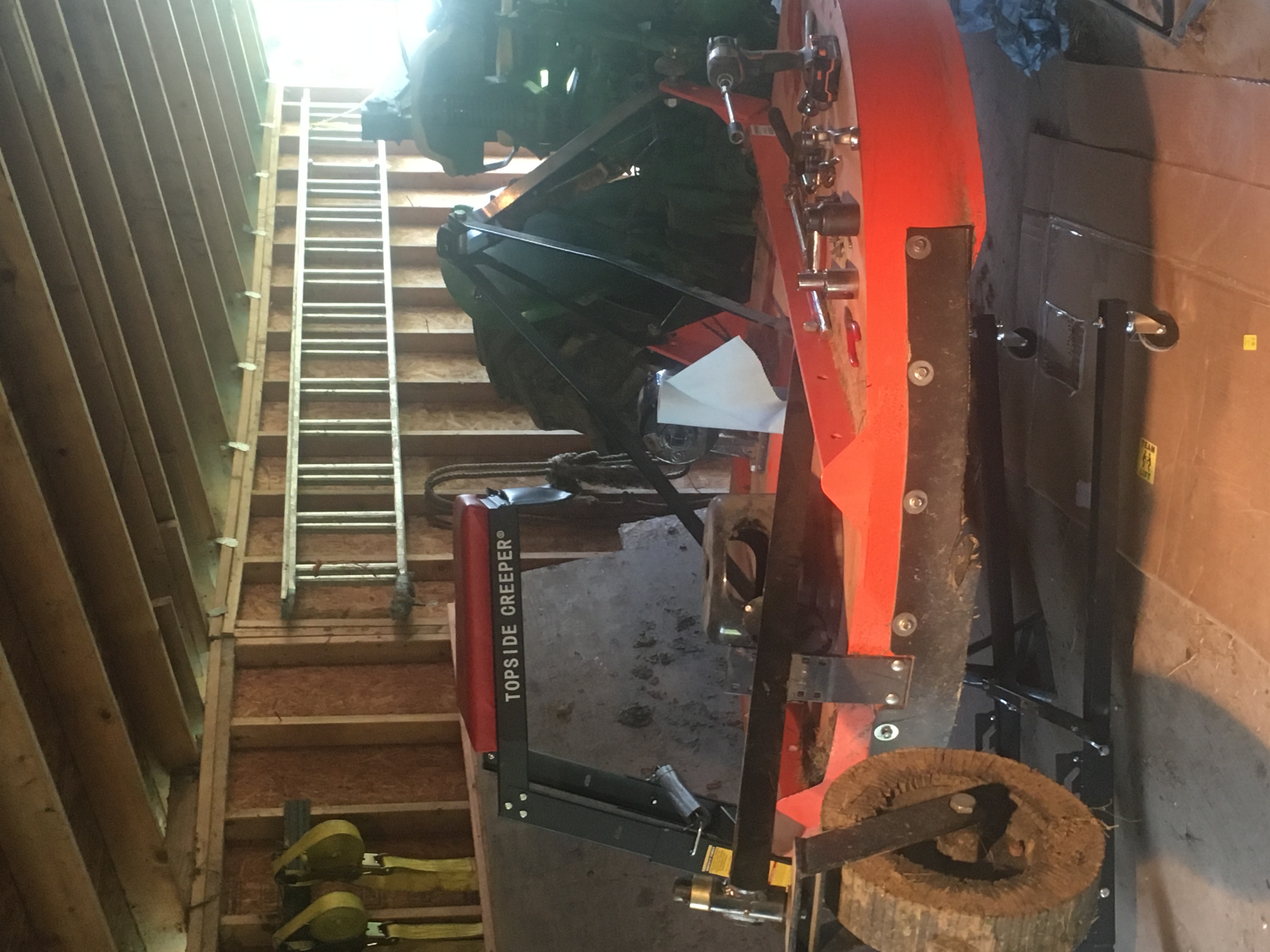

Also, here is a pic of a new tool I just got assembled last weekend. With working on my f-350 dually, as well as the 1020, it really is wonderful to have this overhead creeper. I recommend it, even though I initially thought I would never use it, I really do utilize it.
