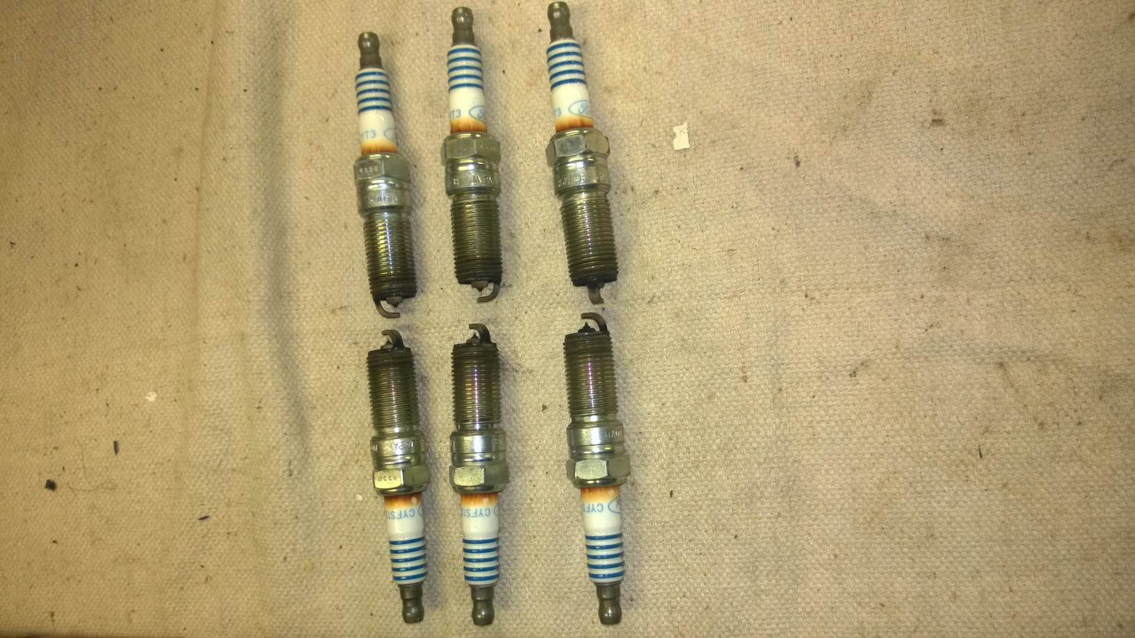

Anyways, I have a 13 ecoboost that has around 27,000 miles on it. Don't daily drive it, but usually take it skiing and to my cabin. So it sees a lot of mountain roads. In fact that is why I waited for this engine to come out, I don't loose power up here in the thin air. I have read all the doom and gloom on this motor, but I have not experienced any of this. I switched over to M1 5w30 extended performance to deal with the issues of direct injection and turbos, but other than that it's been all stock. I have heard that this motor is hard on spark plugs and they should be changed every 30K miles. So this past weekend I changed them out. They actually looked pretty good for 27K miles. The gap was only about .005 wider and there is some heat distortion on the ceramic, but there was no carbon tracking. I am glad I did them, and will extend the maintenance interval to 30k next time.
After driving a EB now at these high altitudes, I can never go away from a turbo gas motor anymore. It's that good and noticeably a big difference.
