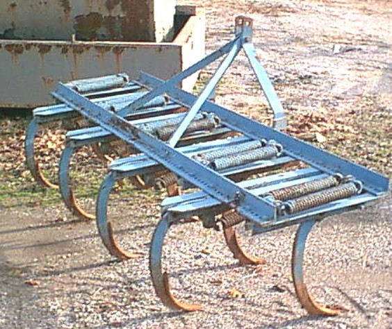

Here is what is called a Field cultivator with spring loaded shanks. Shanks can be removed for smaller tractors. We use them in fields with multiple passes to get to the 14-16 inch depth. Shanks auto reset when you hit a rock. Ken Sweet

In your first post, that doesnt really look like a chisel plough to me, its just a heavy duty spring tine i guess... I wouldnt be too fond of using it at 10" depth, the tines bend so that the chisel doesnt make a proper angle to penetrate the soil, and if they dont pull themself into the ground, they dont give you any additional weight transfer to the tractor which causes traction problems.
I use a rigid tine cultivator to renovate pastures, its a 9 shank model, with a 10" tine spacing. Its comparable to what Ken posted in this post:
just without the auto-reset, as we dont have rocks around here. I run it in 1st gear high range with a 55hp 4wd Zetor which weighs around 8500 pound. For what i want to do with it, i'd actually need a wider tine spacing, as a rule of thumb you shouldnt run a tillage implement deeper than the tine spacing. First pass on hard tramped horse pasture i run out of traction, 2nd pass i bury it to the frame, which is about 15 inches deep. So i'd actually need an implement with a 15" shank spacing, but its my neighbours cultivator so i cant modify it ;)
The cultivator with auto-reset springs is a different animal than a heavy spring tine cultivator: the spring tine cultivator will flex under load and put the chisels upright in the ground if ran too deep. The auto-reset does have springs, but it only moves when hitting a boulder, but maintains its chisel angle when just running it deep.
I think if you have solid shanks with a chisel angle of 30 degrees, your tractor will most likely pull the three shank chisel on hard tramped pasture. With a chisel angle of over 45 degrees, you'll run out of traction and you'll still be mixing too much soil.

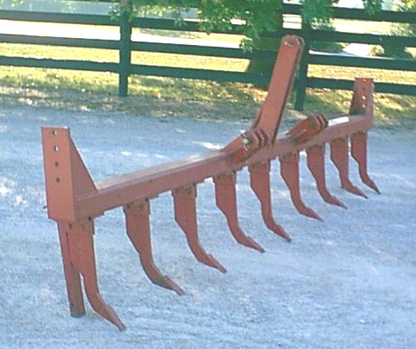

Here is a 9 shank (spaced 15 inches apart) shanks are 18 inches long and each one is shearpin protected. $995 New. Ken Sweet

The manufacturer doesnt have a very clear website, but its very similar to this:
http://www.butsmeulepas.nl/data/images/producten_extra/gr_db90ch93oek93i_bm2.JPG
The one i use, just has 9 of these shanks and no roller behind it.
this one would be useful, just needs its shanks staggered. When tilling deep, ours already plugs up with quackgrass with staggered shanks, which means 30" spacing on each row.
