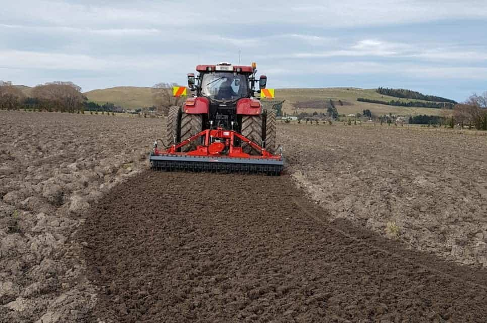

Not suitable for cultivating between rows unless the OP plans on an orchard or vineyard.
BTW, power harrows are typically PTO powered, hydraulic flow isn't important.
The ones around here are hydraulic, orchards use them between the rows.

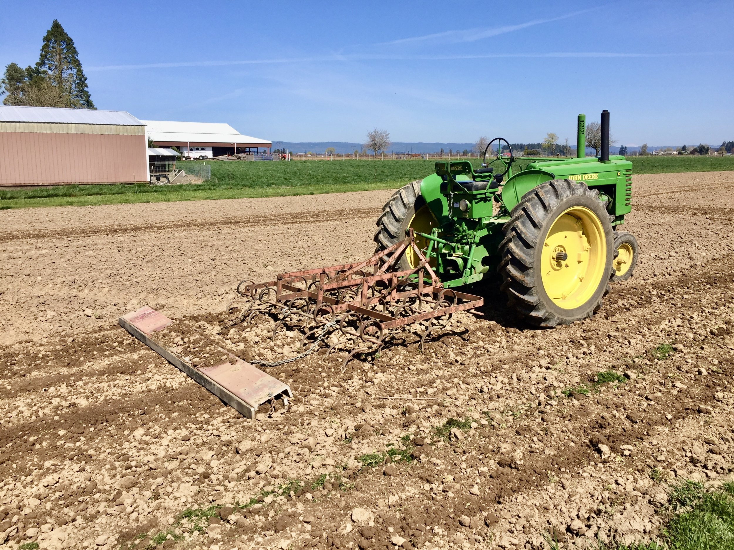

With the amount of weeds and vegetation after two years, I would think that at least the first year you would want to plow it under or hire it done. You mention corn and soybeans but with only 12" of clearance I don't think your tractor is very well suited for row crop cultivation. The tractor in the photo is much more suited for row crop cultivation.
In addition, the ground needs to be leveled after cultivation to make a seed bed. The photo below is what I use and with the two aluminum truck frames pulled behind the cultivator it does a pretty good job of leveling with out compacting the ground. I can pull it with my John Deere 5045E two wheel drive which is about the same horse power as yours but it weighs around 5,000#. The JD G pulls it a lot better, though!
