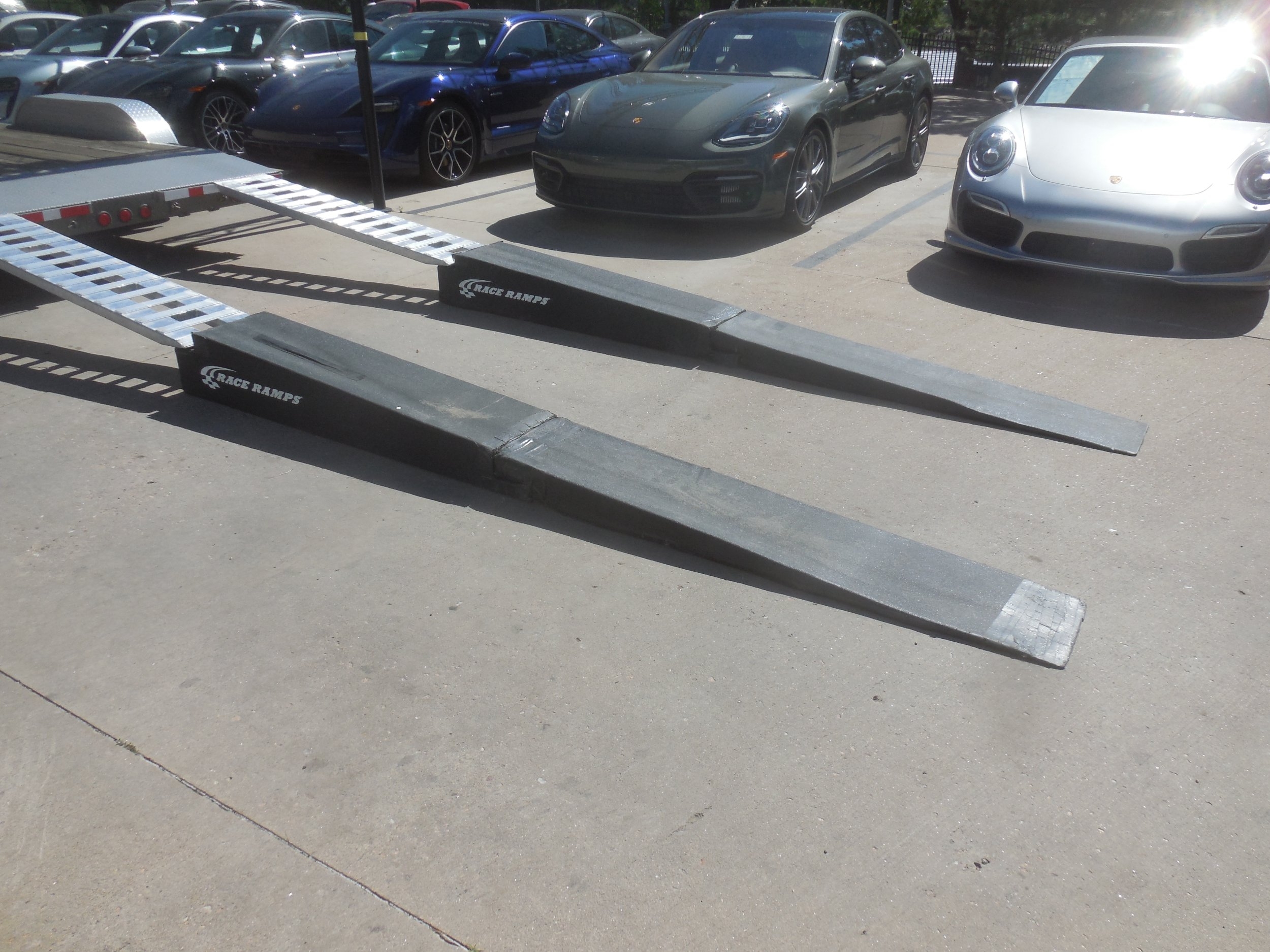

So do I, and quite a few of them, but not quite enough to accommodate that particular car. I'm only set up to handle the Challengers, which are at 10 degrees.View attachment 855715
The dealer has the really long Race Ramps, and concrete, so unloading was easy.
Sometimes I use the tongue jack to help.
When picking up the first Challenger I brought ramps that were far too short, the ones in the photo above. They worked for the '65 Cadillac I loaded for the trip to the dealer.
Thankfully I had a fair amount of 2x6s with me, and combined with lifting the coupler about a foot off the ball I got it clear the splitter.
Anyway, a regular Cayman has a whole lot more clearance than that GT4 did. No need for anything special with those. Or even 911 Turbo Ss.
